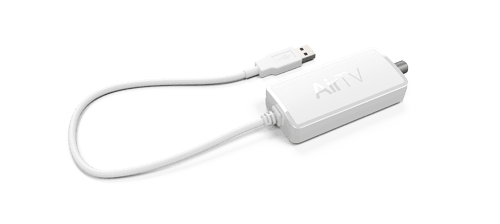

AirTV (www.airTV.net) sells an OTA adapter that has the same internals but it is white and is only $29.99 - everyone says they both work the same. Here's a picture of the AirTV version
Yes, that's the adapter I'd planned on getting. Will the installer balk at using a non-Dish branded adapter?
The installer may be ok with installing the AirTV adapter, but if he isn't, it's a simple USB plug-in device with the antenna coax screwed on the other end. The receiver will recognize it with no setting changes needed.
I should add that while no settings changes are needed, you will need to scan for the local channels. But that's just a few button presses in the menus, not unlike doing it on a TV set.
