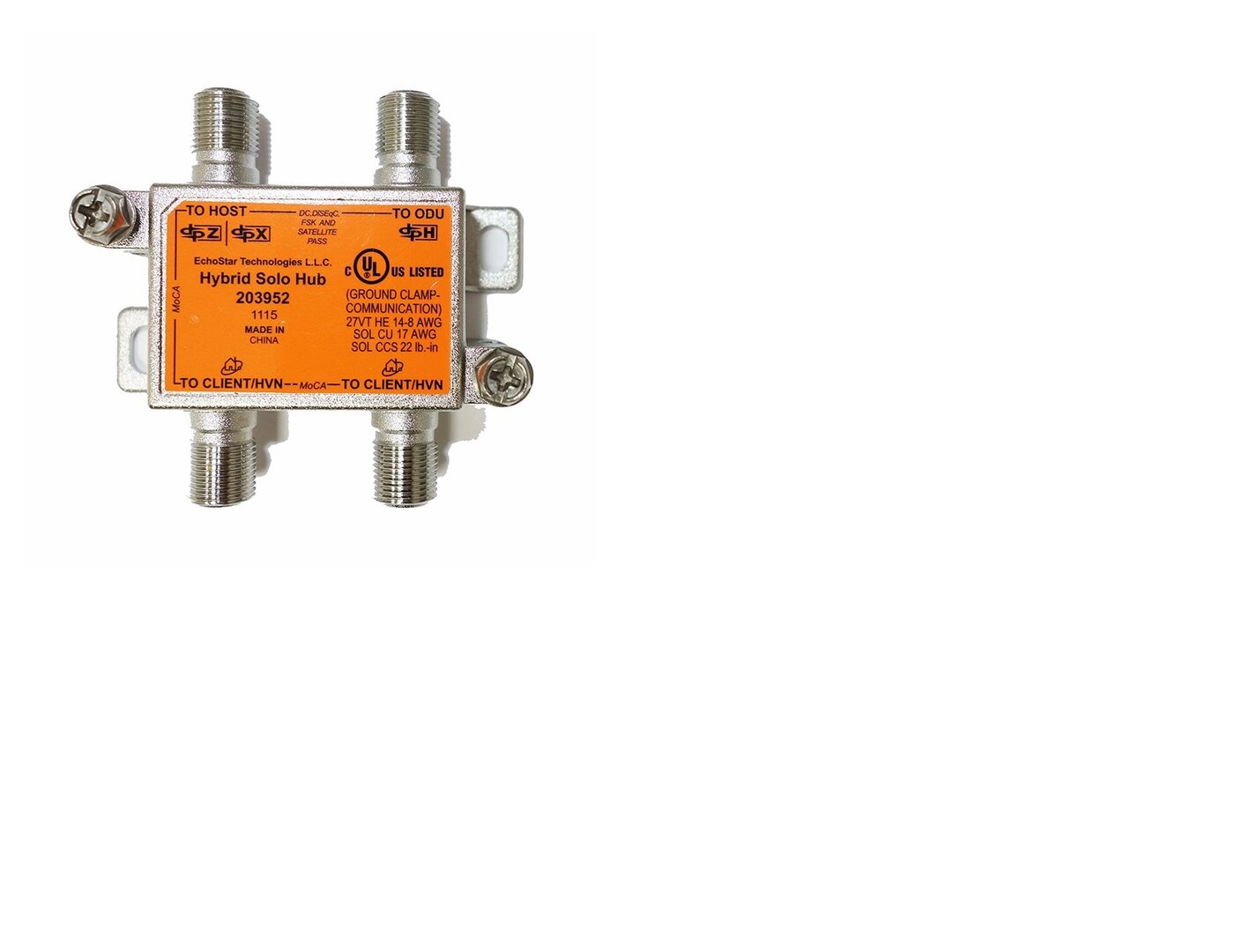

IF you go Hopper you would have to have a Joey at the other TV fed by coax but that coax is backfed through the coax that comes from the dish, all through a hub that would be a separate splitter looking device (see pic below) somewhere between the Hopper and the outside dish. Your present cables would be adequate but the connection would be slightly different.
Sat signal from Dish through the hub to the Hopper. MOCA (Multimedia over cable)
out from the Hopper to the Joey on the same cable to the hub then out of the hub on the current cable to the Joey at the other TV. From the Joey via HDMI to the other TV. Host is the Hopper, Client is for Joeys, ODU is the dish.
Reactions: charlesrshell
Sat signal from Dish through the hub to the Hopper. MOCA (Multimedia over cable) View attachment 172092out from the Hopper to the Joey on the same cable to the hub then out of the hub on the current cable to the Joey at the other TV. From the Joey via HDMI to the other TV. Host is the Hopper, Client is for Joeys, ODU is the dish.
