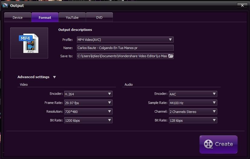

I'd like to burn to DVD some videos that I've recorded from my MicroHD. My Video Editor that handles the TS files doesn't have a menu generator (no way to add chapters either). I have to output the videos as individual files (MPEG4) then import them into a DVD Creator. I don't want to degrade the video quality any when I output the videos. TS Doctor identifies the stream as:
H.264
29.970 FPS Interlaced
720x480 (4:3)
The stream rate is: Video 20Mbit, Audio 2Mbit
On the Video Editor, I picked out the output parameters that I think will work best (a guess)(screenshot attached). The bit rate of course has a big effect on the output file size. My question is, is 1200Kbps too
much? What would a suitable output bit rate be that would match the original stream. Any suggestions would be appreciated :D
The DVD format only supports standard definition MPEG-2. H264 AVC is MPEG-4, and would have to be transcoded to play in a DVD video player. Blu-Ray will support H264 natively, so burning to Blu-Ray would be an alternative.
Use MultiAVCHD to add the .TS files to a Blu-Ray layout.

Thanks for the information on the codec's. Using the Wondershare Video Editor, if I go directly from TS and output to DVD, the quality is acceptable. Not as good as the MPEG-4 stream ... but acceptable. The codec that Video Editor uses (chosen automatically, can't be changed) when burning to DVD is VOB NTSC. The encoder it uses of course is MPEG-2 (frame rate and resolution is the same as the source) and the Bit Rate is 4000kbps. Those files would be about 120Mb for a 3:30 length video clip. I'll try burning to BD as you suggested. Your help is appreciated!

Blu-Ray is a nice alternative since it compatible with a diverse set of video streams and resolutions. You could, of course, use either Blu-Ray or DVD to burn a data disc, but it would not play back as a video disc.
