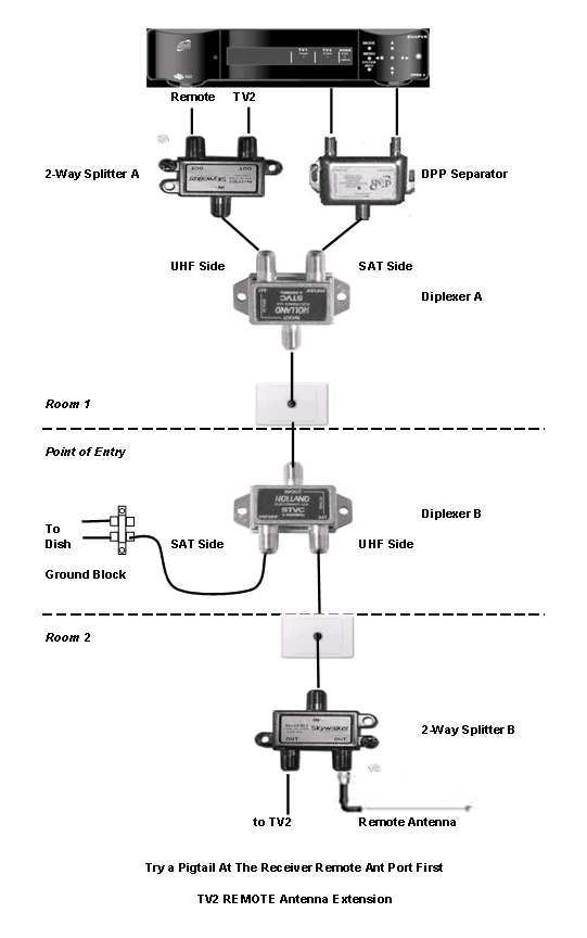

If I wanted to place tv2 of a 322 into my garage, about 80 feet from the receiver, could I use a diplexer and hook it to the tv2 antenna on the receiver and place the antenna in the garage off the other diplexer?
Note that those are SPLITTERS, not diplexers.:)
Ed
You can basically split the signal off any receiver that has a tv2 output on it. I feed 5 different locations with my tv2 output, including my garage which requires the cable run to go back outside to get to the garage.:D
make sure you change the remote address, extending your uhf ant. for tv2 makes it easier for a neighbor with the same remote address to change your channels. alot of receivers are set to default address 1.
