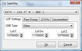

Well, I got DVBDream to find the C-band system (0KHZ on my multiswitch), but I cannot get anything on my KU (22KHZ side). I played around with the settings yesterday, and still cannot get a signal on the card. I have my Coolsat pointed at 11839H 26.670 on 103 - NBC Mux, and I can get 70% quality on the coolsat, but Nada on the card for this transponder.
I will post my settlings for that satellite below. I have the 22KHZ set to On in that tab.. everything else is blank or none.
