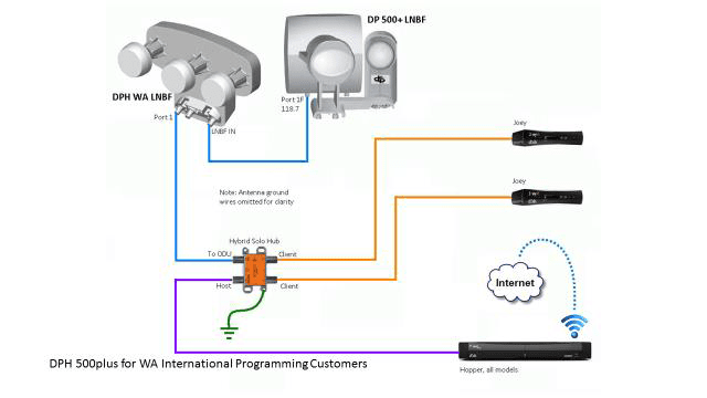

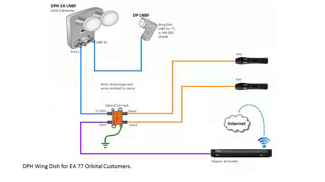

Seriously, if you have a western arc 1000.2 and a hybrid LNB you could just add a Dish 300 or Dish 500 and point it at 77. Then take the output of that LNB and connect it to the Input on the Hybrid LNB. If it's more convenient you could also use a DPH42 and DPP LNB's on both dishes.
Of all the schismatics I have seen on the Hybrid LNBF, I have yet to see what can be connected to the Input Port of the LNBF. Where have you seen the the Input Port will convert DPP LNBF to Hybrid signals?
I think the two DPP LNBFs into the DPH-42 Switch is the correct option.

Because I've done it. Used an Eastern Arc Hybrid with a Dish 500/DP Single for the 129, cable into the input port on the hybrid LNBF. Also done it with a WA hybrid and a wing dish pointed at the 61.5
I've done it too. Also see the Dish diagram I posted in this thread. And here's another one:
Reactions: NYDutch and HipKat

Yes you can do this:
'Or use a 500 dish for the 77 bird, and put the 1000.2 over to the other spot for the WA....
Then I could still use the hybrid LNB either way on the WA and one of those single LNB for the 77 bird....'
