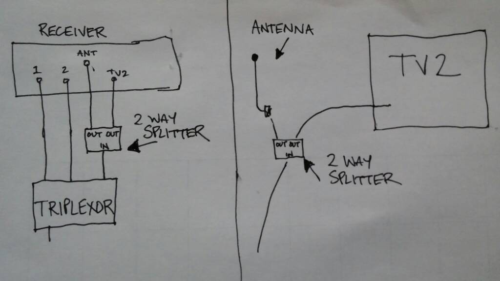

Or, get a couple two way splitters, short pieces of cable, and do this:
Bought some cable and put the antenna about where it was behind the older front room tv we used to have. This remote is for the bedroom. I have to walk up to about 3 feet from the antenna to get it to work. I'm thinking ChadT41 was correct and my remote is bad. Is Dish really the best place to buy these from or are they the only place.
