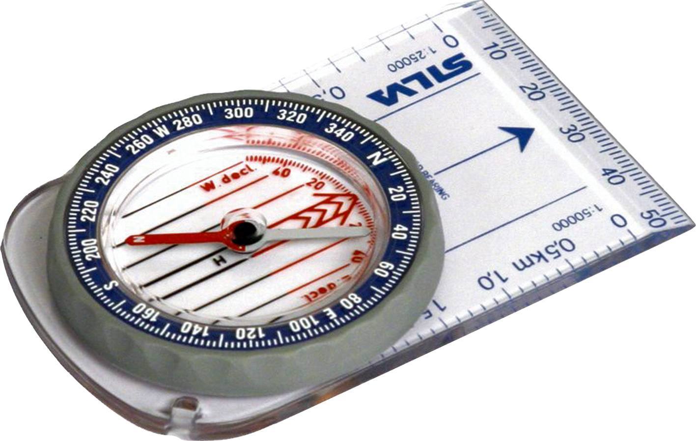

100+ installs over the years; I am not a pro, and I have never used a meter; regardless of dish type. Go out to Wal-Mart or your local outdoor center and buy a $15 heading/field/map compass; that is all you really need.
Well add a level if you don't have one in your tool box already just to make sure the mast is level & plumb.
