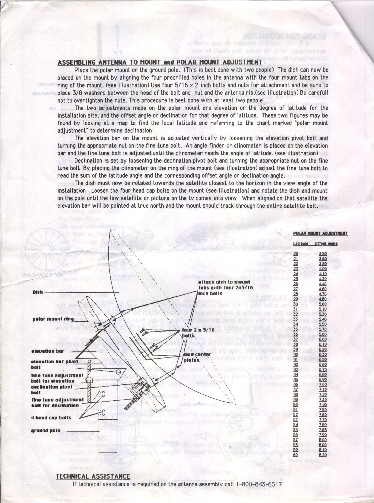

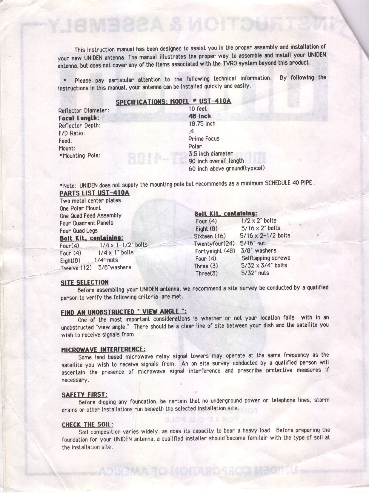

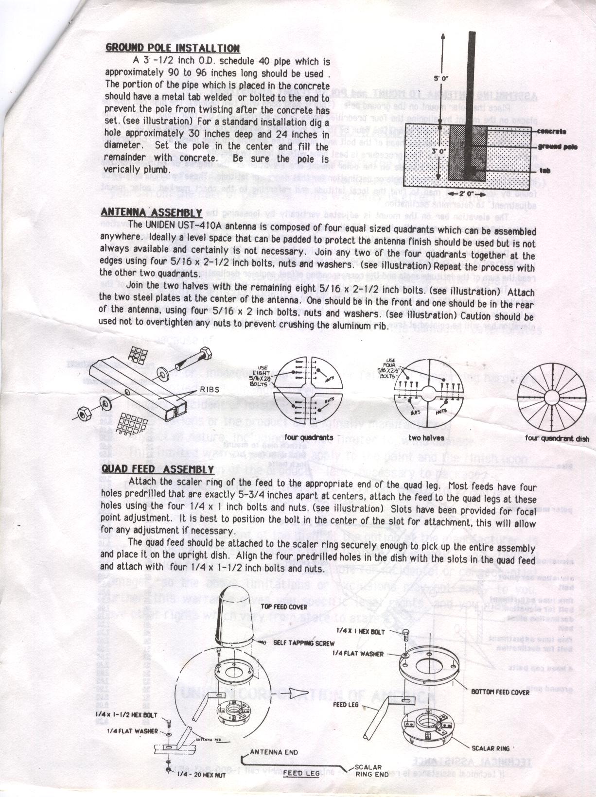

Hope this gives you the info you need.

Yes thank you. I appreciate the info. It will help explain and they can see the sheet on setting it up at their location. My friends are down on Holly Beach and its just too hard to get over there to do it for them.
