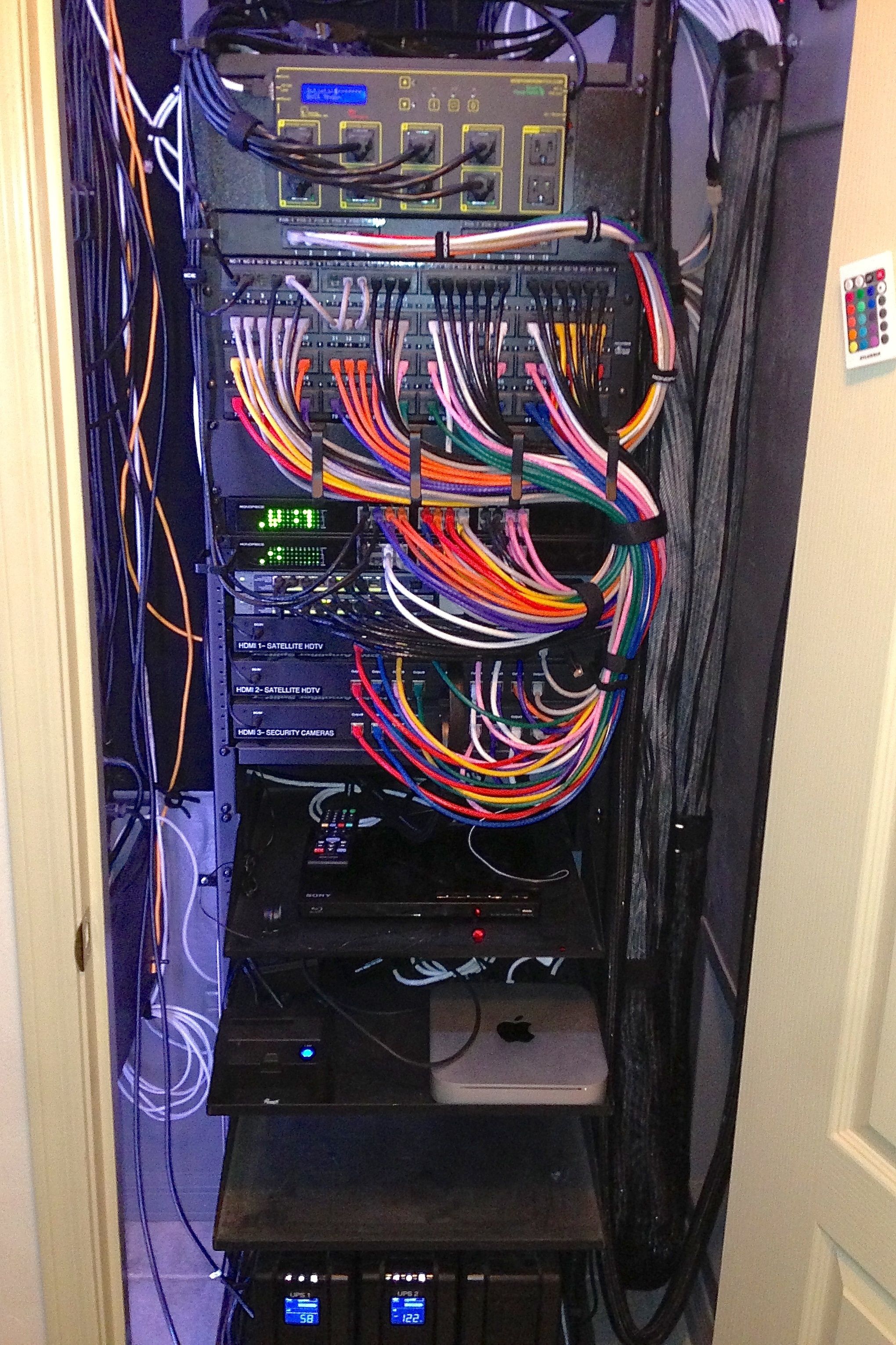

Hello,
I am preparing for a Dish Network technician to install my system and being that my pocket protector is pretty big itself, want to make it as easy as possible for us both. My configuration will involve one Hopper and one Joey, both installed in a network closet and fed to the rest of the house via HDMI-over-Cat6 and an IR repeater. I will set up a table immediately outside of this area with two HDTV's and power sources for the ease of setup, testing, and sign-off of the installation (no HDMI-over-Cat6 connections will be done then). Once the technician is gone, then I will then reassemble everything on my network rack to my geek standards. Here are a few questions:
- I have two runs of RG6 quad cabling (rated at 3GHz) from my network closet to where a single satellite dish will be installed. The total length is about 40-50 feet. Is this within limitations to have the solo node installed in the network closet?
- What are the grounding considerations with this? It seems like I read that the solo node was to be no more than 20 feet from the dish if it is used for grounding, but didn't see another option.
- Is there anything that would contractually prevent the customer from distributing a Dish signal with private equipment to other HDTV's inside their own home? I have not seen such a detail in my contract, but then again, my eyes got all glassy trying to read it.

- Yes.
- Let the installer worry about that. I prefer to have my nodes inside, but that is not really necessary.
- No. Lots of folks do this.

I'm sure you have already considered it but be sure you have adequate ventilation.
The grounding block should be as close to the entry of the building as possible for lightning/fire protection. If you want the solo node in the closet, it is best to install a separate ground block outside and leave the solo node ungrounded.
Believe me, living in the desert, I designed my network closet with ventilation as one of the first considerations. I have three fans that together product 666 CFM when needed (for the 72 cubic foot area) and two 18"x18" vented ports to draw in air at ground level. A controller kicks the fans in at low speed around 90F degrees and is hardly noticeable. However, when they hit full speed, it sounds like you are behind a B-17 aircraft about to take off! There is also a separate temperature sensor that is Internet connected, so I can remotely override control if needed. George Jetson would be proud...
