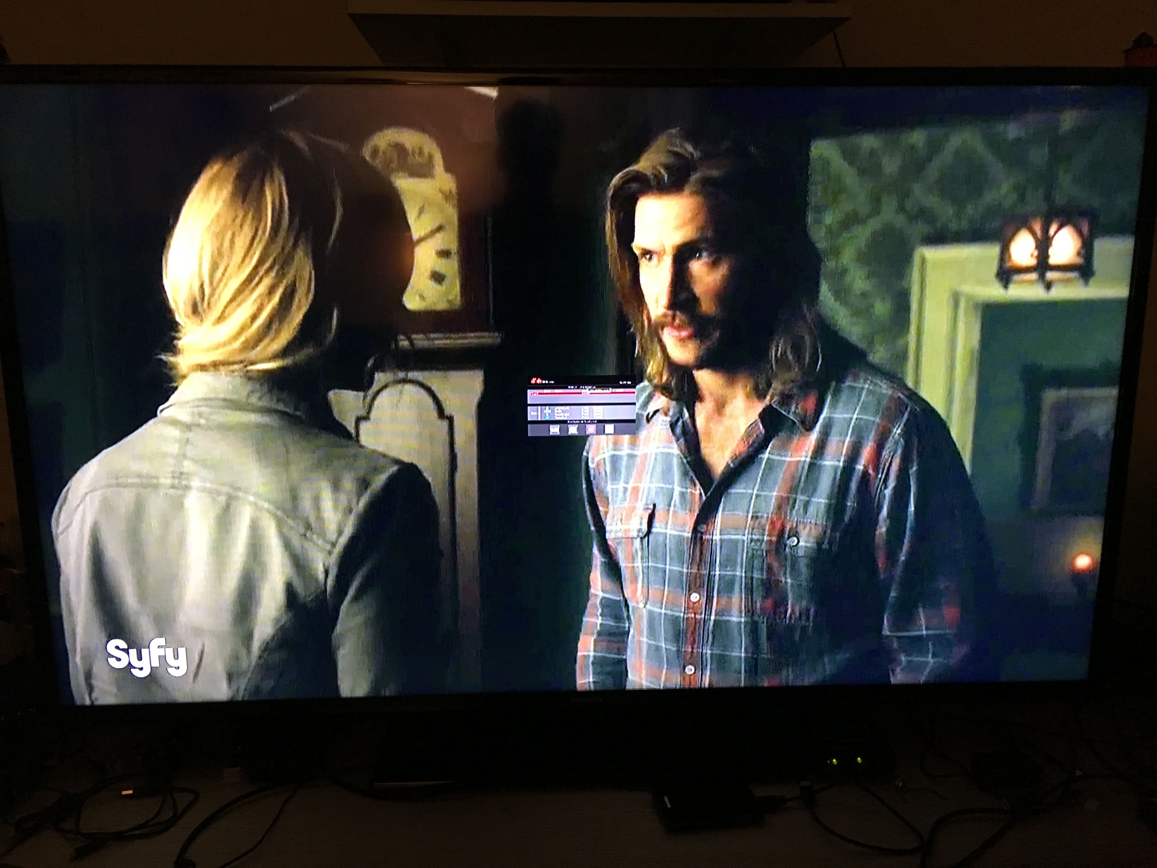

All that the screen adjust circles do is adjust the screen overlays. (menus, guide, etc.) The channel video is NOT adjusted.
Here's an image of the screen showing that just the overlay is changed.
