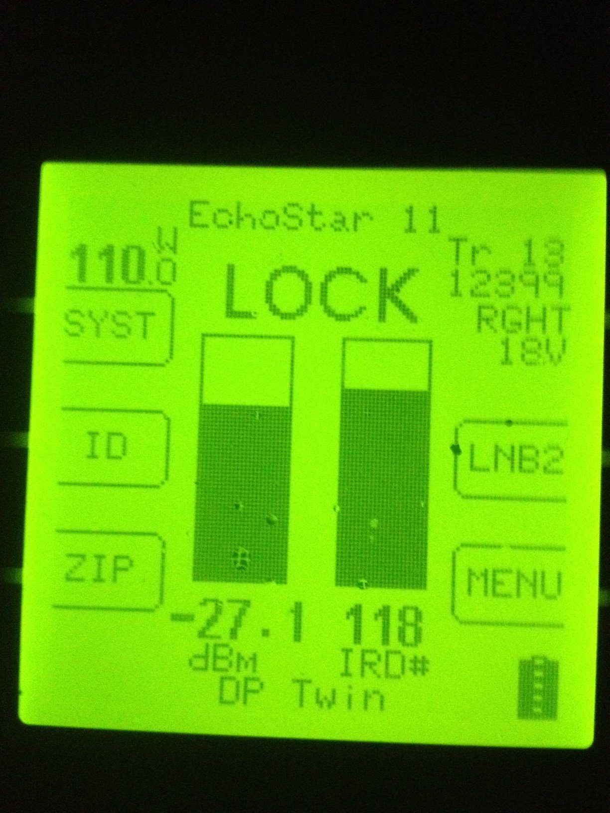

Tonight when I get home while it will be dark but I will head outside with my Superbuddy satellite meter and tune the dish just incase it did get bumped in my work.

Well I got signal restored, but thats not it unfortunately. The signal is amazing now, with it reporting at 115 on both 110 and 119.
There are no errors being reported in TSREADER as its capturing the data which I dont recall ever seeing before.
But we are getting the BREAK 5089 error when it does TADA NIT. :(

The signal is fine now. :) The uplink computer and hooked direct to the dish now, with no more switch in the way. :)
Nice signal level too. :)
