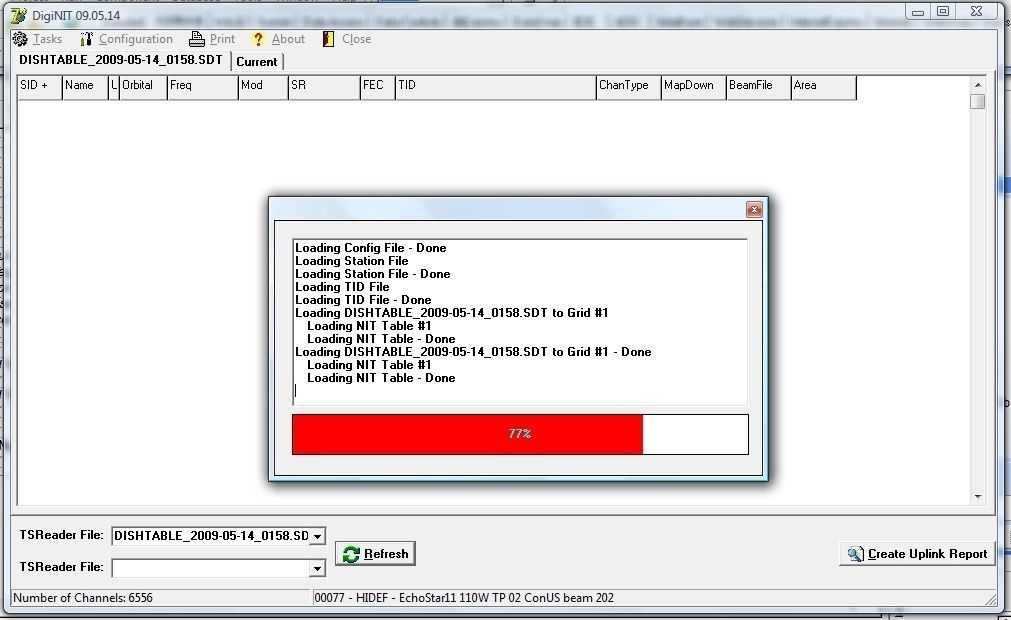

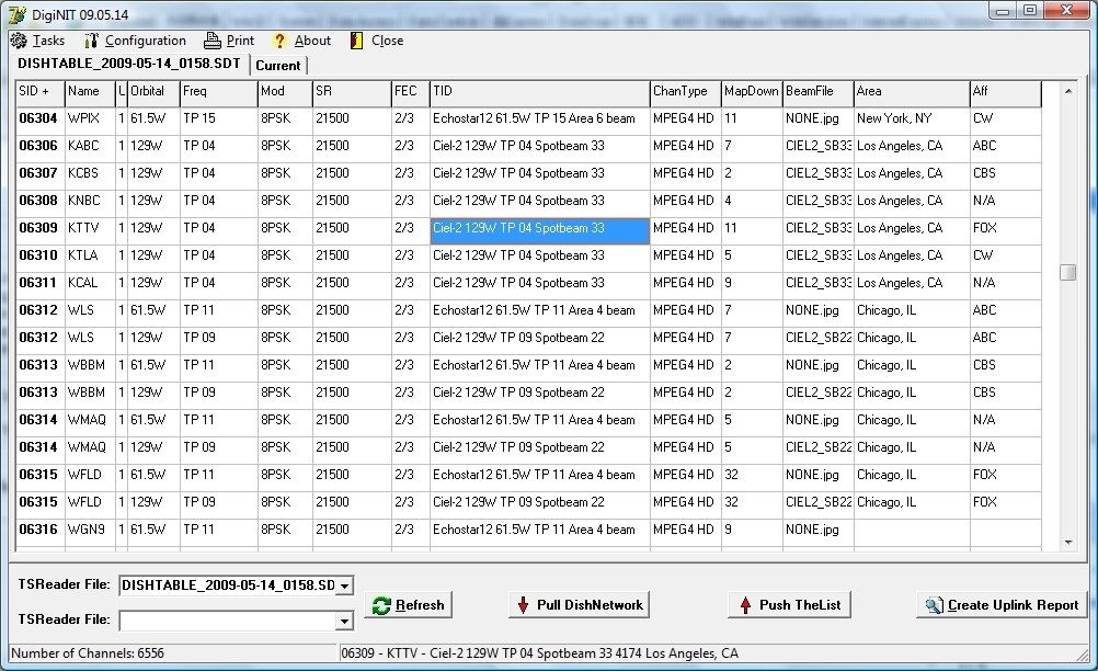

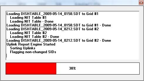

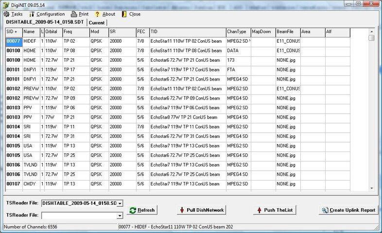

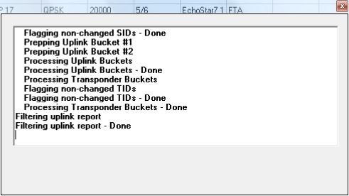

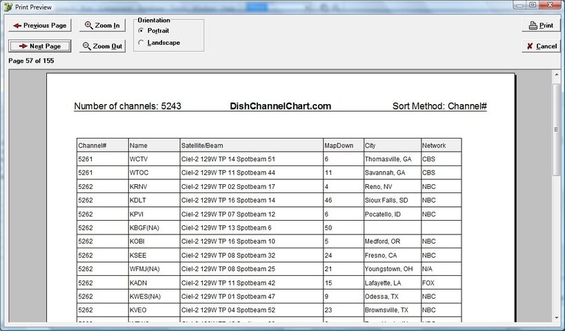

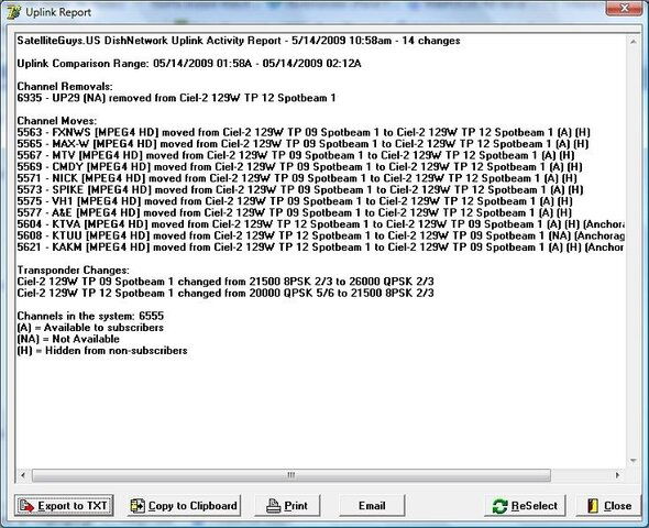

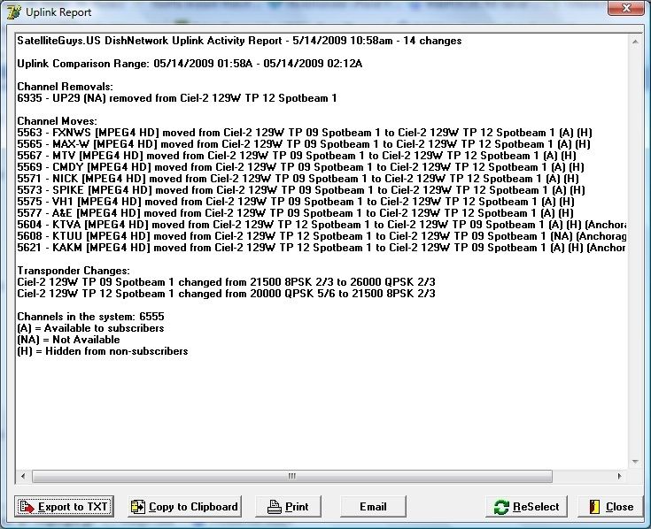

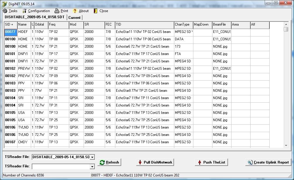

I know I stated several months ago I would post a video of things of happening at the uplink PC. I haven't had time to do the video as I've been adding a couple of things and cleaning up the code on the uplink tool. I decided to post some pictures of the process for you guys for now. These pictures are taken from a manual process of the report. The automated mode looks about the same, except the log viewer shows a bit more, and less screens are shown.
I'll explain the process when I get a chance later today. Enjoy!
And of course JohnH deserves a big round of applause for all of his help in this project.

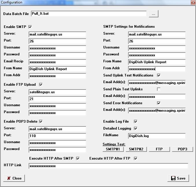

Question: How does the pc monitor the uplink tables? Is it interfaced with a dish receiver somehow? If it is, how is it interfaced?

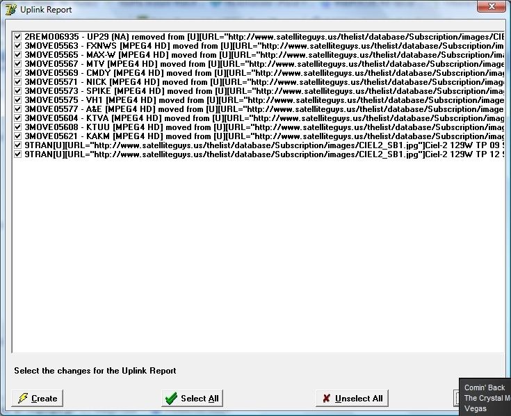

If anyone is curious... on the screen with the checkboxes. Originally there was no auto-filtering out sports moves that happen daily. So when the report ran you had to uncheck the ones you didn't want, or hit unselect all then check the ones you wanted. I later put in the auto-filtering that unchecked the sports moves for you but allowed you to change things as needed. You would then hit create and it would format the report and copy it to the clipboard for you to create a new thread with. Remember...this was before the automation days.
Later I added in the grouping of adds, deletes, moves, etc. In order to keep the same process flow I cheated a bit. Hate recoding things when they work already! I prepend every change with a tag for the type of change. Then all I had to do is set the CheckListBox Sort property to True and they are sorted by change type then by channel number. During the colorization module I just watch the tags and add the subsection headers as the tags change from one to the next. I need to throw in tag for State/City that I would pull out in the colorization module so when we have a bunch of changes to the locals they are grouped by Change Type, State, City, SID. Constantly adding little things to my list....
And by all means if you guys think something would look better in the formatting or have any ideas, please let me know.

Would be interesting to see how TSReader file(s) creating.
Is it automated too ?
What size or interval selected to make the files ?
How the files loading into main parser ?
Manually or by script ?
