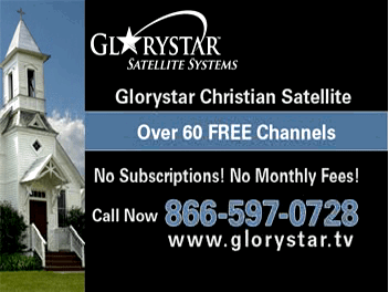

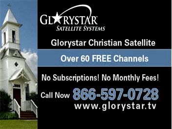

Hey, look on 11842H, VPID2119, there's a title board with a Glorystar ad...
