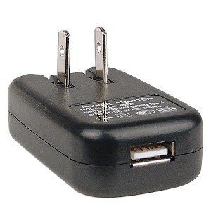

get a usb power adapter and plug the fan into that. like the little kind that are used to power iPod's, iPhones, etc. Plug the fan pad into that, and then the Hard drive into the USB port of the reviver. Then, nothing sticks out the front, and both can be running at the same time without a hub.

just get a wall to usb adapter for the fan,my kid has one he used for his ipod, used it and its working for the fan, no need for a hub here in my case
Edit,sorry did not read past the second page of the thread(DO'H), props to sdschramm for posting this idea
