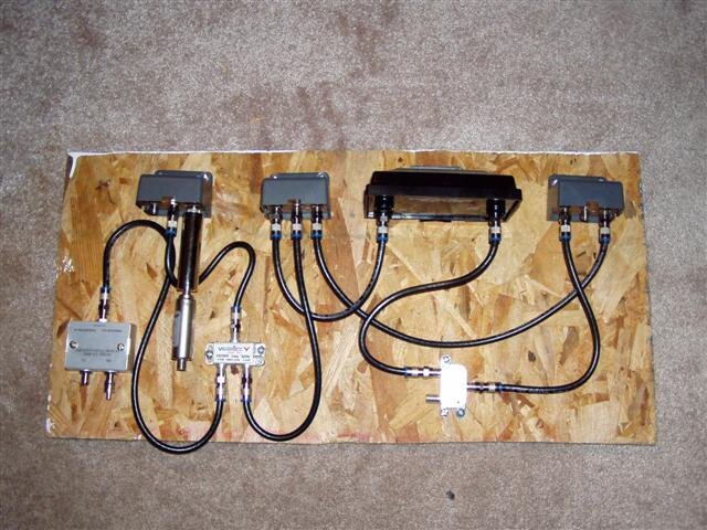

I took your approach here with very favorable results. I added the 91xg to my setup and used my hd8200p for vhf only.
The 91xg is directional, handles multipath very nicely, is much lighter than a cm4228 (6.5 lbs vs 15 lbs), and would be much more stable in winds. the antennas were spaced about 3 ft apart. the cm 4228 did not work for me here.
the 2 antennas were combined with a cm 0549 vhf/uhf combiner ($7.50 -warren electronics) with only .5 db insertion loss and amplified with a winegard hdp 269 off of the cm0549. the 91xg ($80 -solid signal) would cost less than a cm3671 and would provide better performance on uhf over any combo antenna out there in the marketplace.
I have experimented with many antenna setups during the last 20+ years...cm3671, hd8200p, cm4228, 91xg, etc...and the two antenna setup is the best by far.
you can utilize your current antenna for vhf and combine a top performing uhf antenna for the best of both worlds. I just hate to compromise using a cm 4228 for high band vhf reception.
see avitar.
tower guy check out my current wiring scheme.
-use more filering to pass only vhf and trap a close fm tower (100.9) off the hd8200p (purchased filters from a local company).
-used the hdp 269 as a distribution amp only amplifying uhf on the long runs and passed vhf unamplified.
-the short run to the home theater was not amplified.
-used a winegard fm/vhf-uhf splitter-combiner to further isolate fm from the tv setup and sent the fm signal to the receiver.
this has been the best compromise so far.
