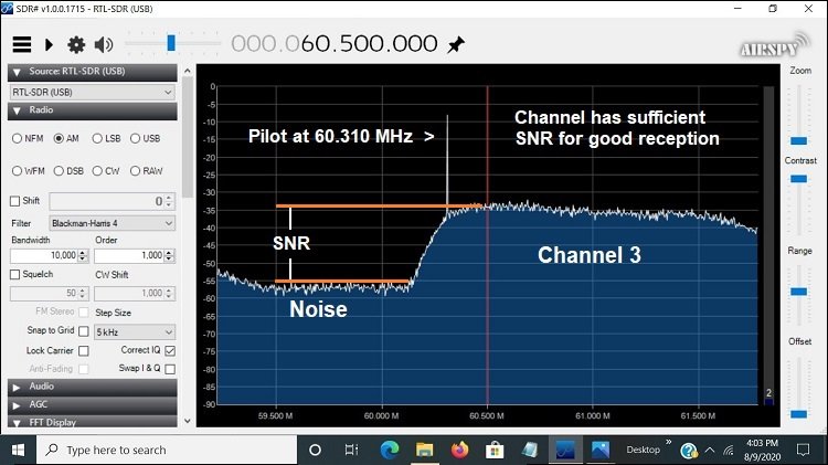

In post #63 I showed how the RTL-SDR V3 dongle could be used with SDR# to see the low end of an ATSC 1.0 channel.

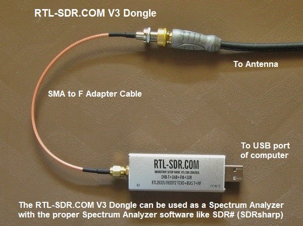

This is the V3 dongle with an antenna adapter cable. I usually connect it to the USB port of my laptop with a short USB extension cable. The newer V3s have a black case.

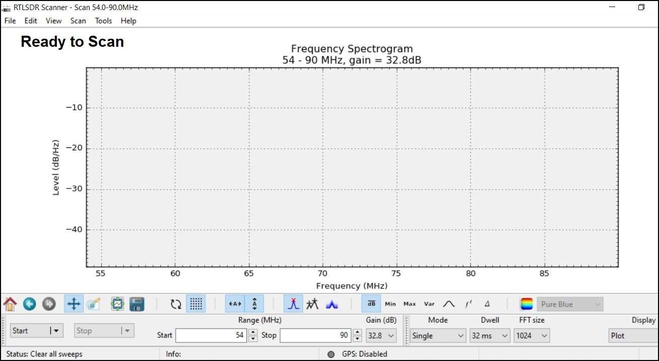

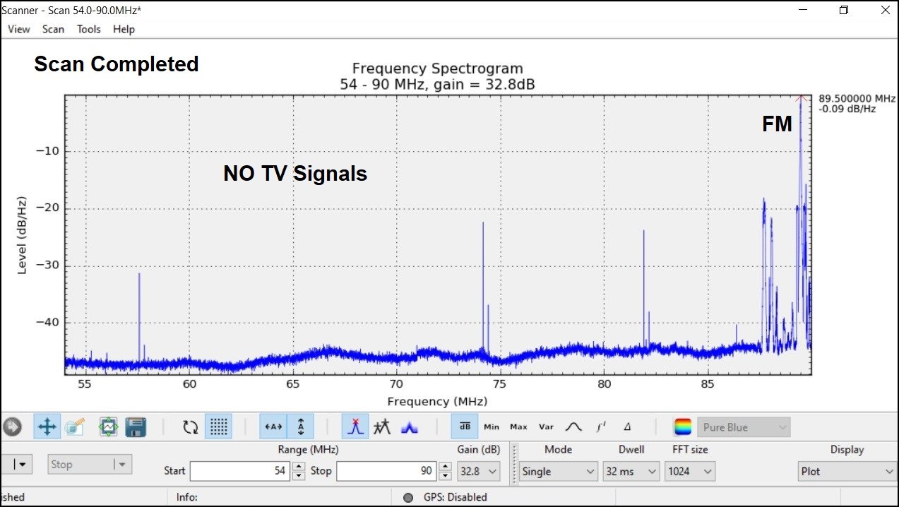

I will now show how the V3 dongle and GitHub RTLSDR Scanner software can display much more bandwidth than one channel.

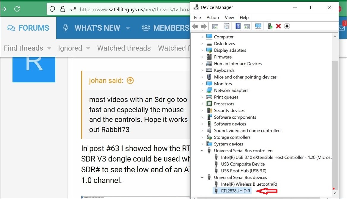

Check that V3 is in Device Manager:

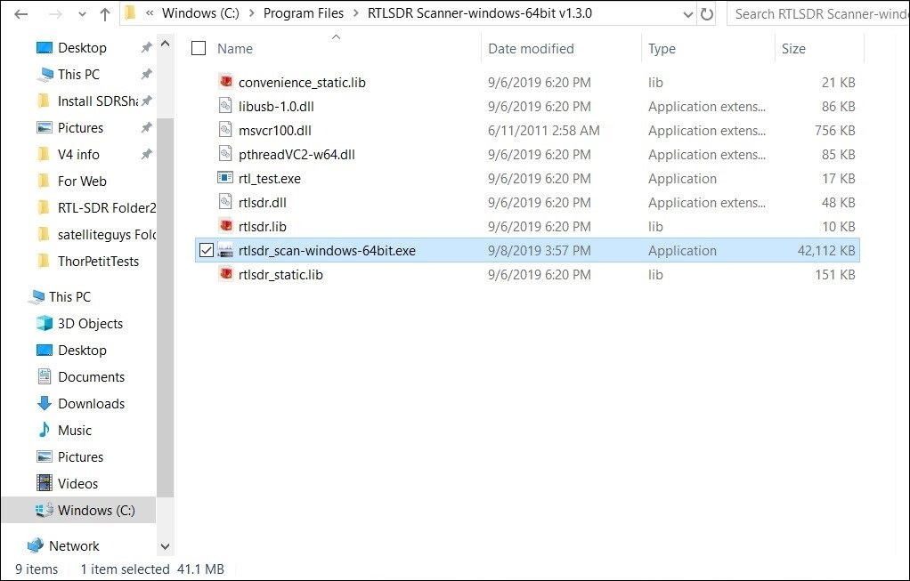

This is the Scanner software:

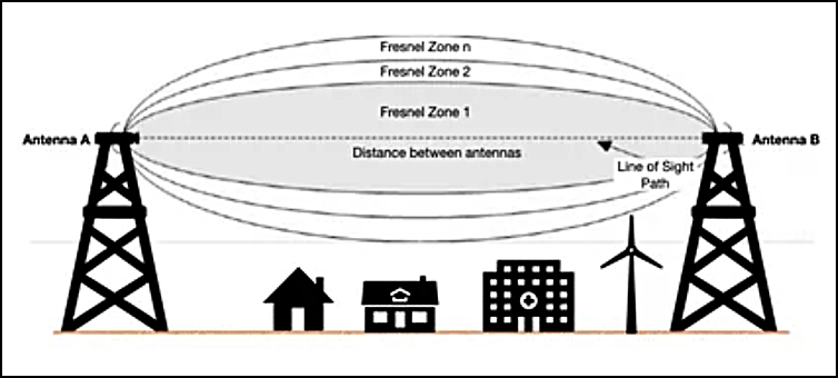

Have a question, is there also a program where you can calculate how high I should set my antenna ?!. live in the built-up area and to place a mast of 30 meters high there, I ask for trouble. Mvg

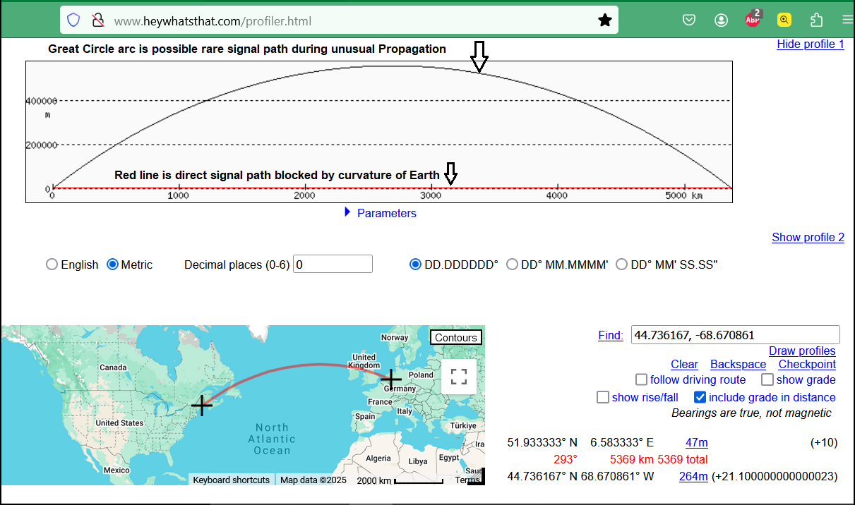

I found this program, but haven't figured out how it works yet.https://www.omnicalculator.com/physics/fresnel-zone. Could someone help me with this too.

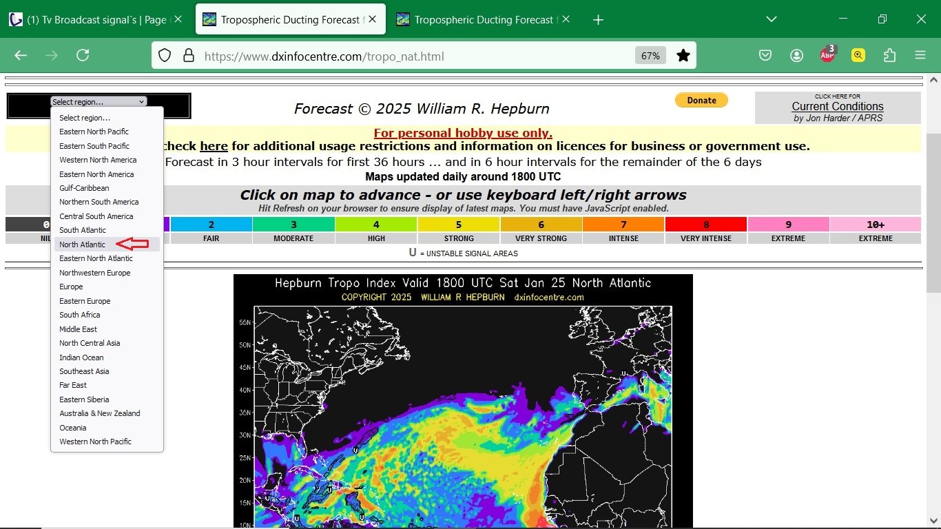

That program is not useful for your DX TV Project because your signals are not direct, they are by rare great circle propagation. I will not demonstrate that program.

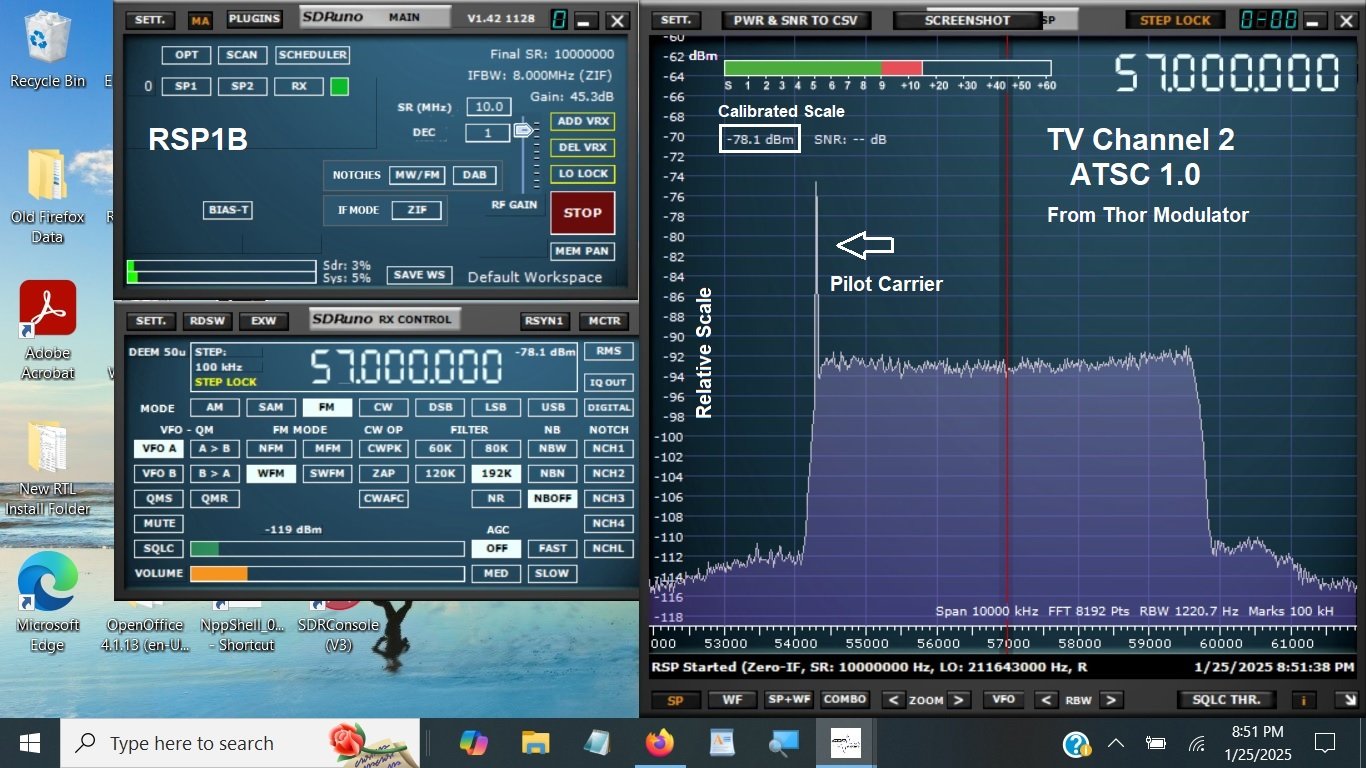

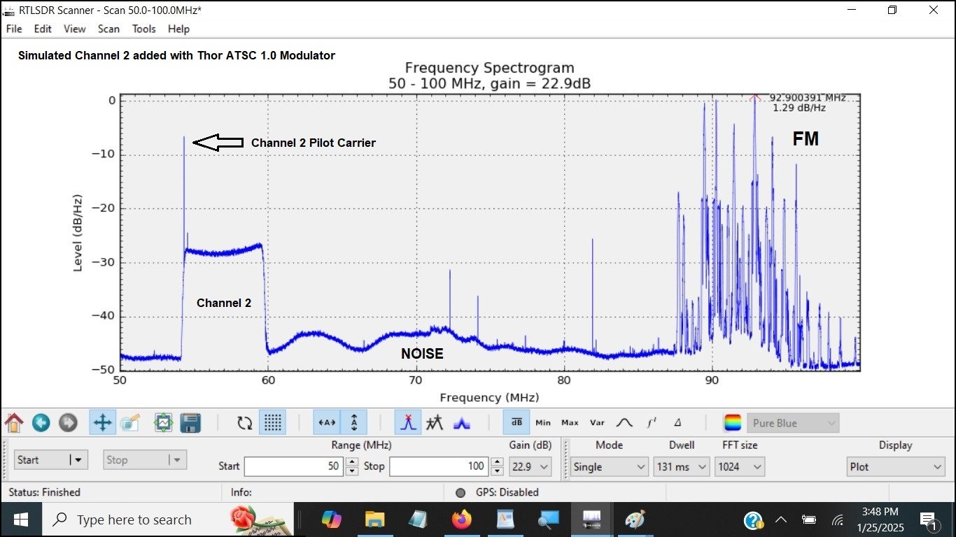

Here is Channel 2 added to the VHF-Low Scan.
If you have strong local FM signals, you might need to add an FM trap (filter).
Next is RSP1B examples.

This is how I have my RSP1B and SDRuno setup for ATSC 1.0 signal measurements. I only need to use these 3 windows for measurements with my laptop.

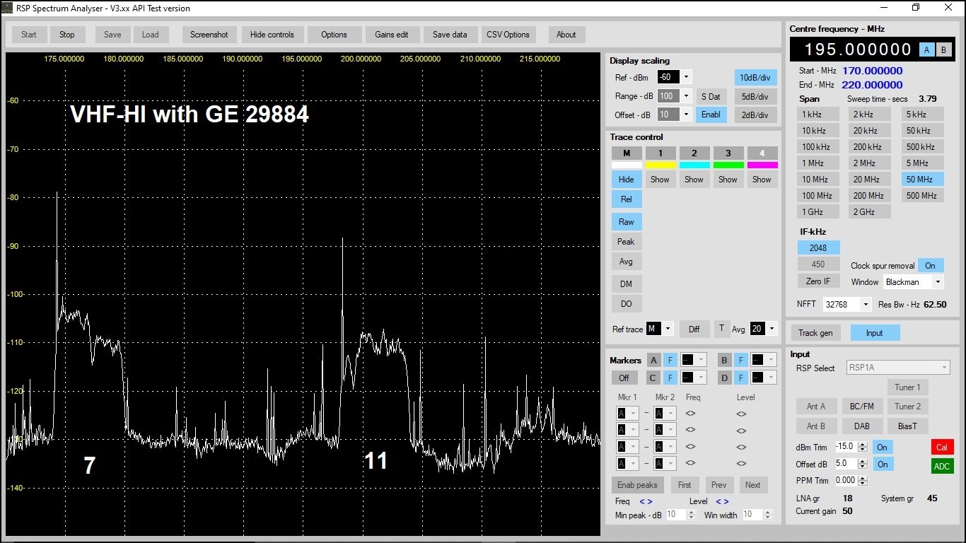

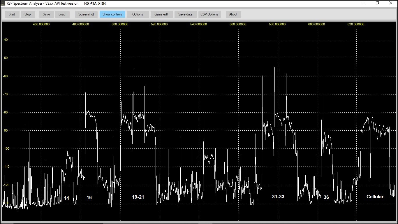

Since you already have an RSP1B, there is also available the RSP Spectrum Analyzer software:
Analyser download and installation
I had the original version of the software working, but I haven't yet been able to get the new version of the software to work.
Maybe you can get it to work with your RSP1B?

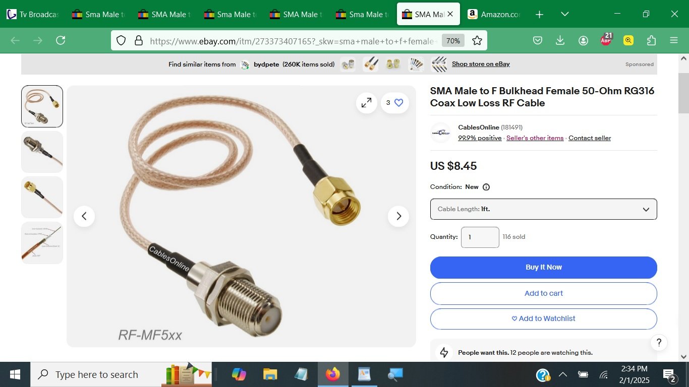

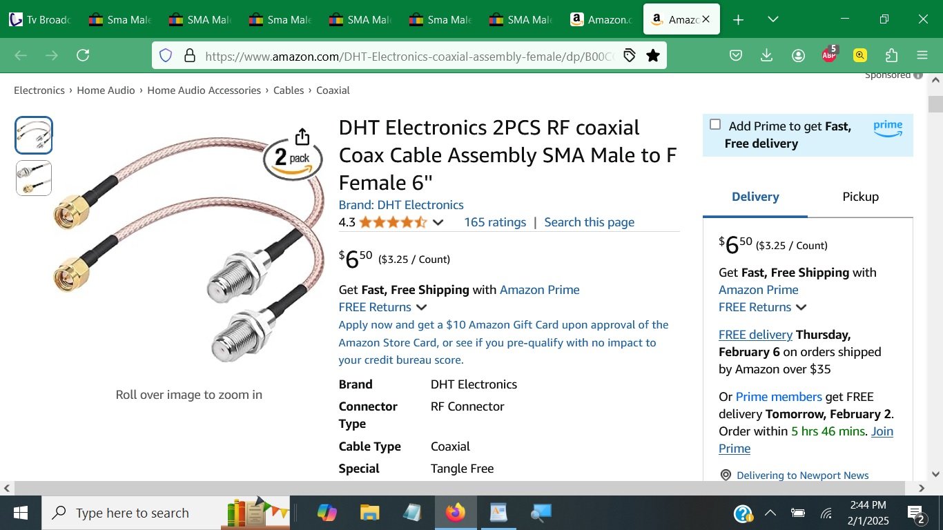

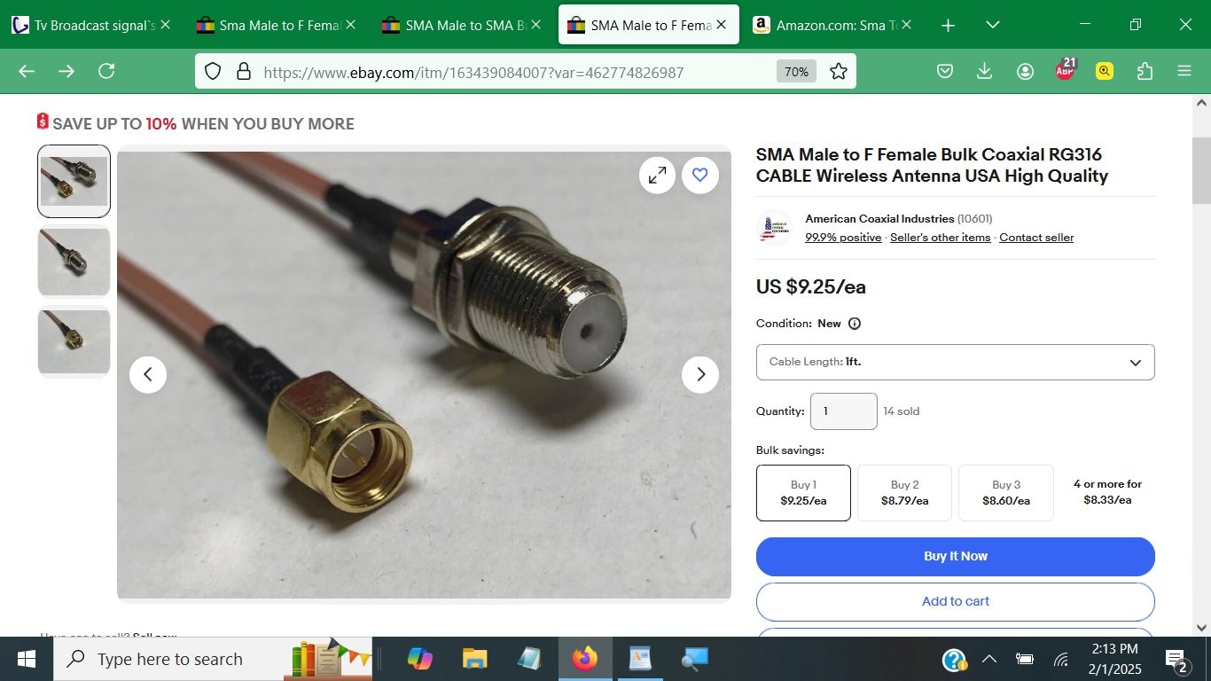

Where did you buy these cables. Mvg
  • DHT Electronics 2PCS RF coaxial Coax Cable Assembly SMA Male to F Female 6''.jpg

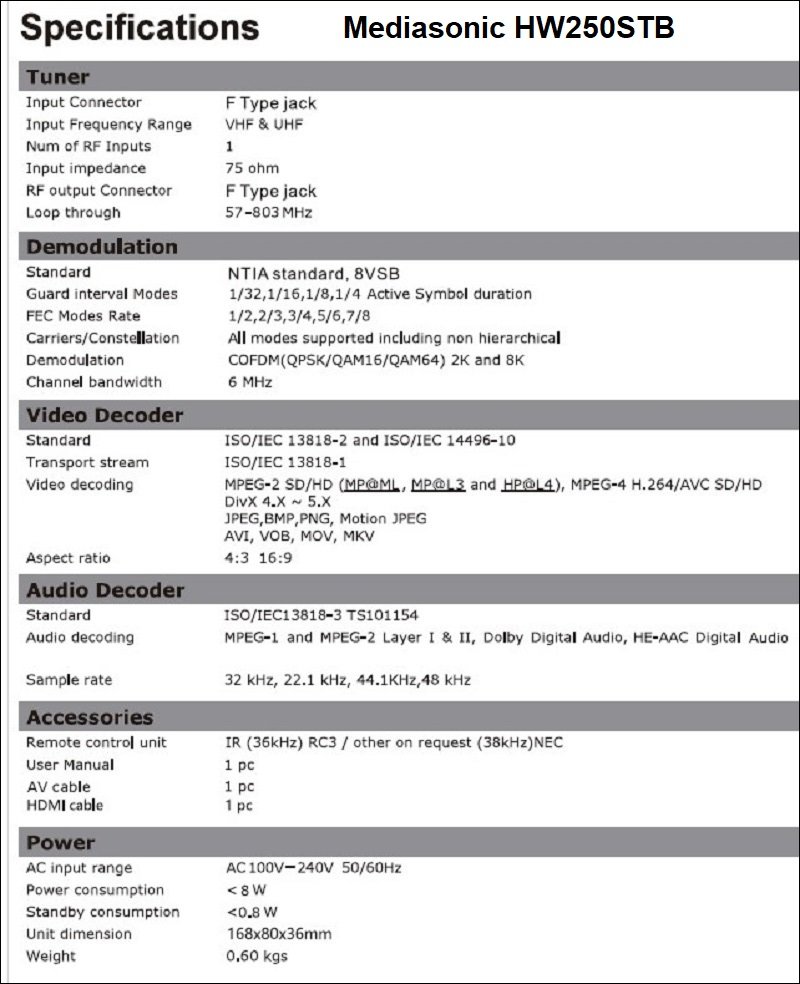

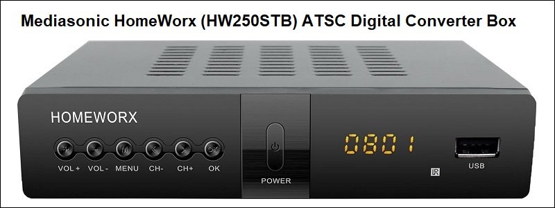

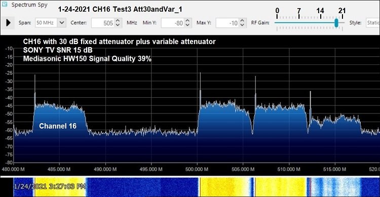

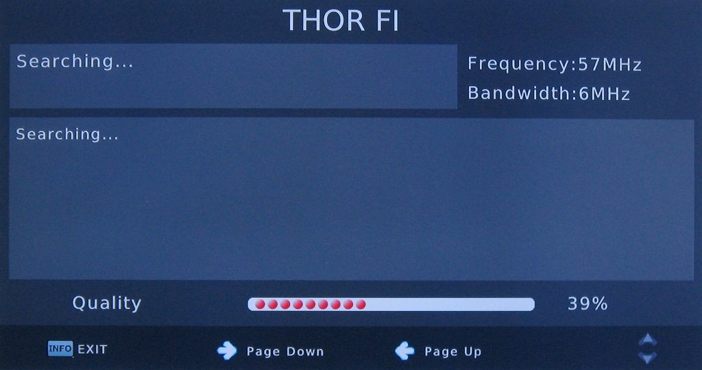

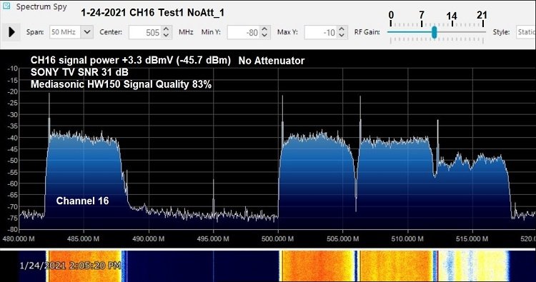

In Jan of 2021 I compared the sensitivity of two tuners, my SONY TV and a Mediasonic HW-150PVR. The method I used was to connect an antenna to a variable attenuator and then to a splitter for the 2 tuners. The details are here. (That site is down sometimes)
Antenna > Variable attenuator > splitter
I reduced the signal with the attenuator to find the dropout point of the tuners. The SONY tuner would dropout when the signal Quality was less than 15 dB; the HW150 would dropout when the signal Quality was 39%. The tuner that dropped out last was more sensitive to weak signals.
I showed the shrinking signal waveform with an Airspy R2 and Spectrum Analyzer software. Spoiler: they both dropped out at the same time, indicating equal sensitivity to weak signals.

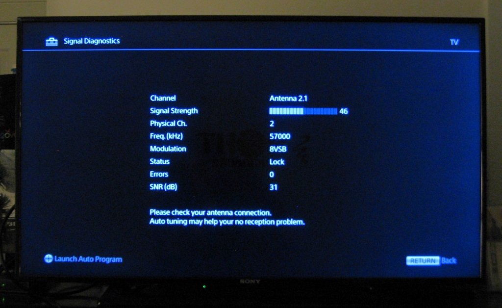

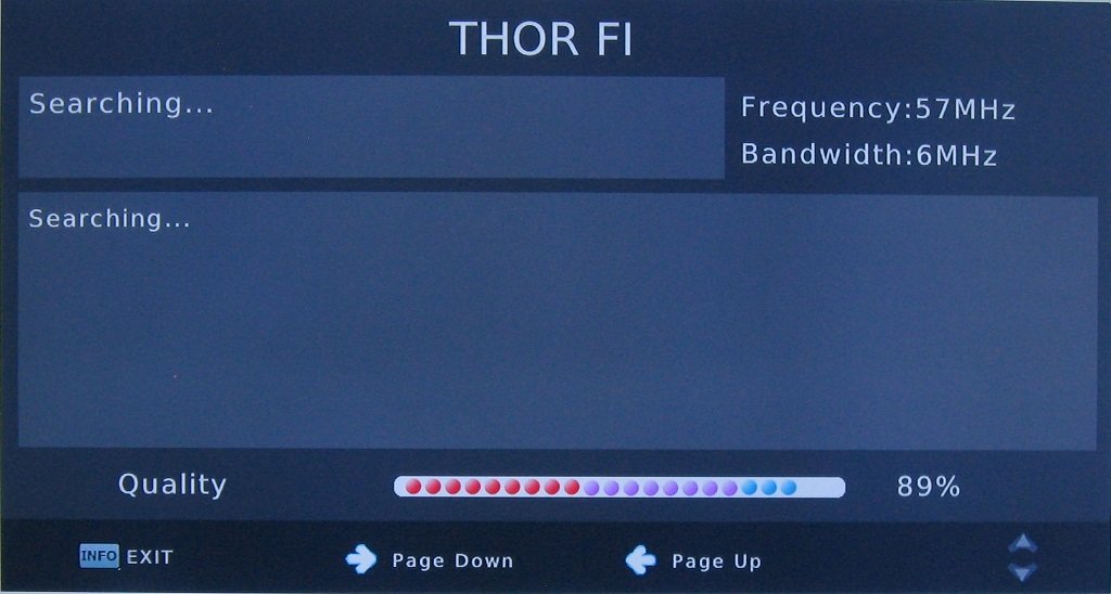

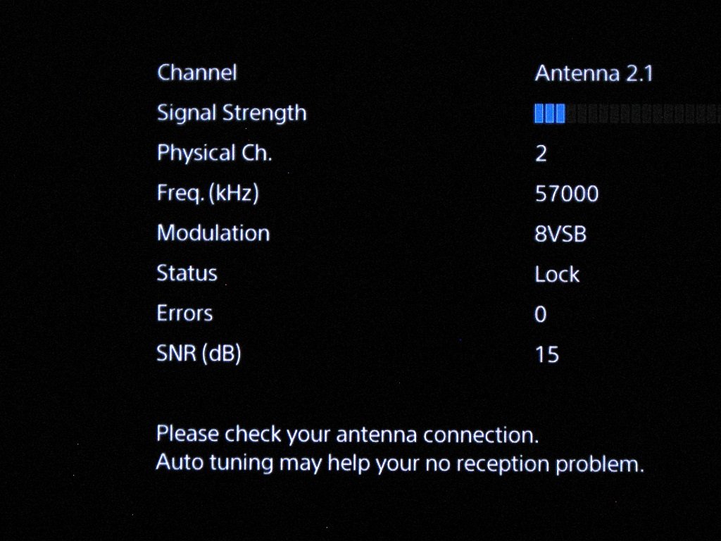

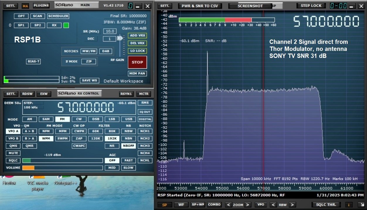

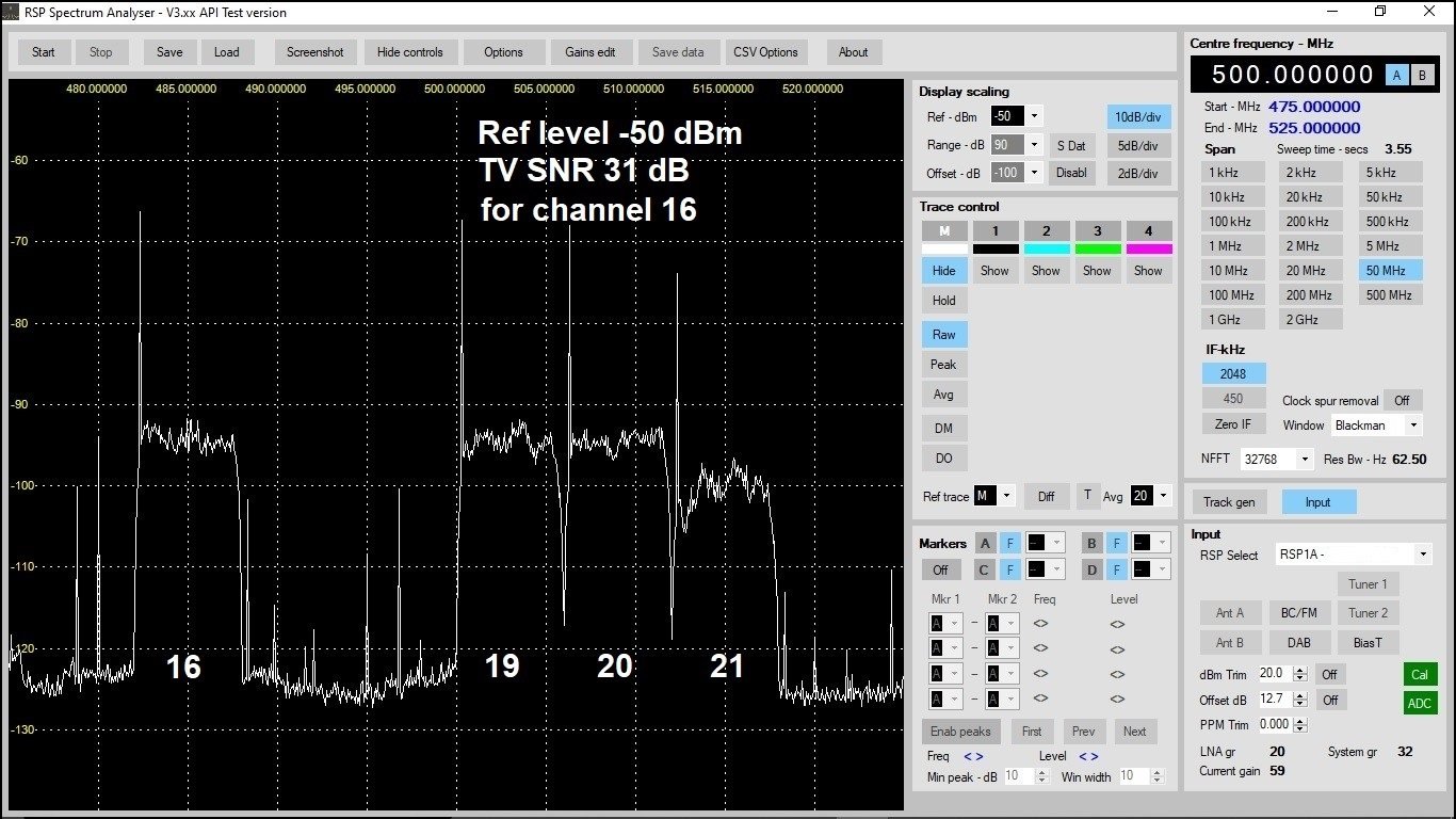

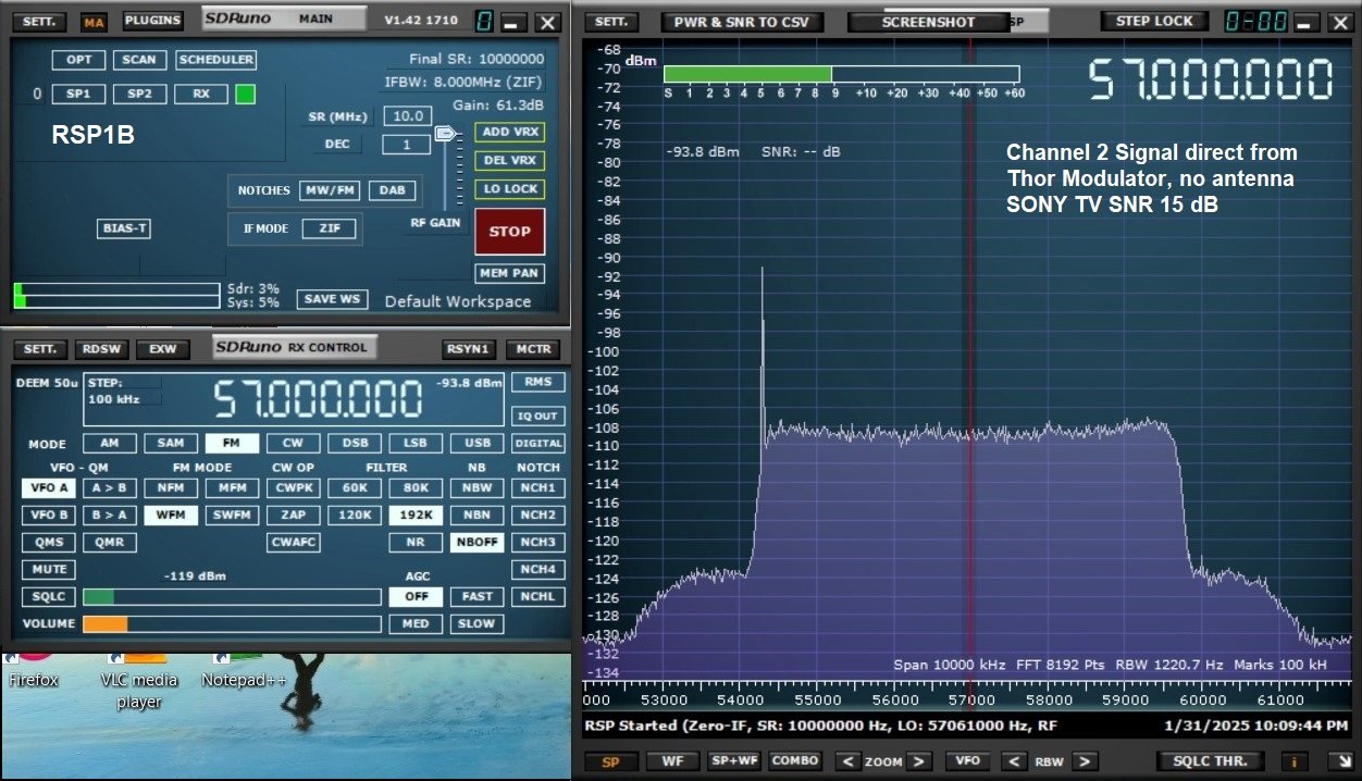

In order to check the sensitivity of the HW250STB tuner for johan, I did a similar test with my SONY TV and the RSP1B to show signal waveform. However, instead of using an antenna signal, I used the signal from a Thor ATSC 1.0 modulator to avoid including the variable of antenna noise. (Later, I might do a test with an antenna to show how much stronger a signal must be to overcome my high local noise level).
Thor modulator > Variable attenuator > splitter

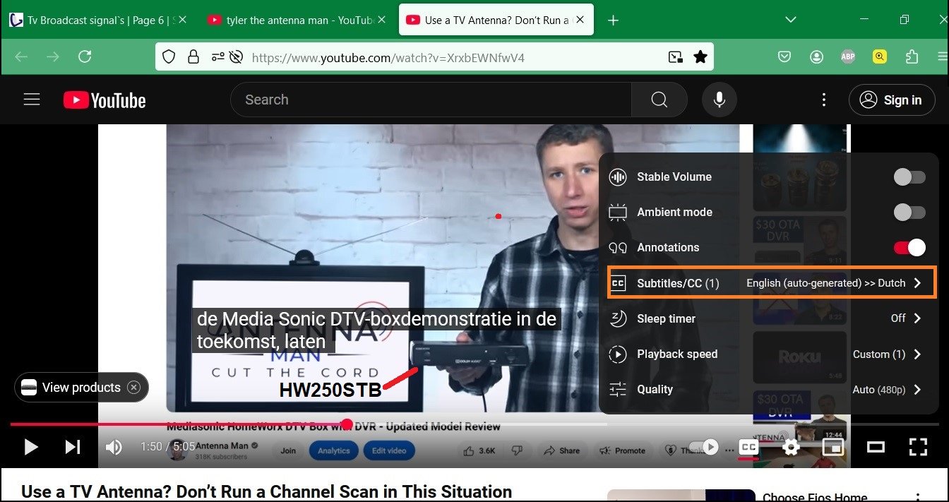

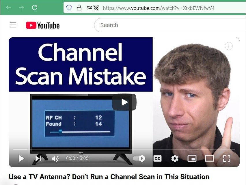

Another Tyler video featuring the Mediasonic HW250STB.
View: https://www.youtube.com/watch?v=XrxbEWNfwV4

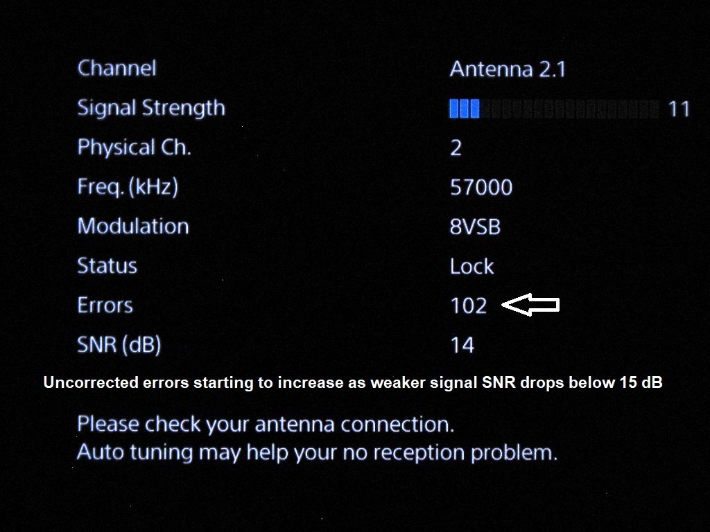

CONCLUSION:
The tuner in the Mediasonic HW250STB is just as sensitive as the tuner in my SONY 40" TV.
When the SNR of a signal drops below 15 dB and you no longer have tuner lock to see a picture, the RSP1B SDR will still be able to show you the shape of the signal.

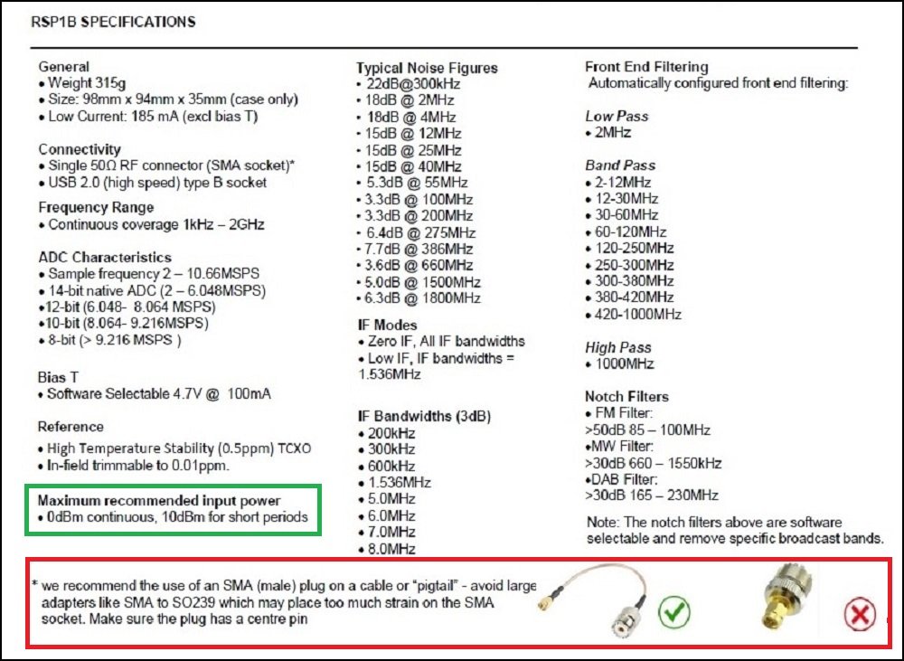

I use that SMA to F adapter cable on all of my SDRs to take the strain off the SDR antenna connector.
RSP1B Datasheet Link
I buy them on eBay (US or China) or Amazon.
Do not buy RP-SMA; it does not have a pin.
Other type adapter cables

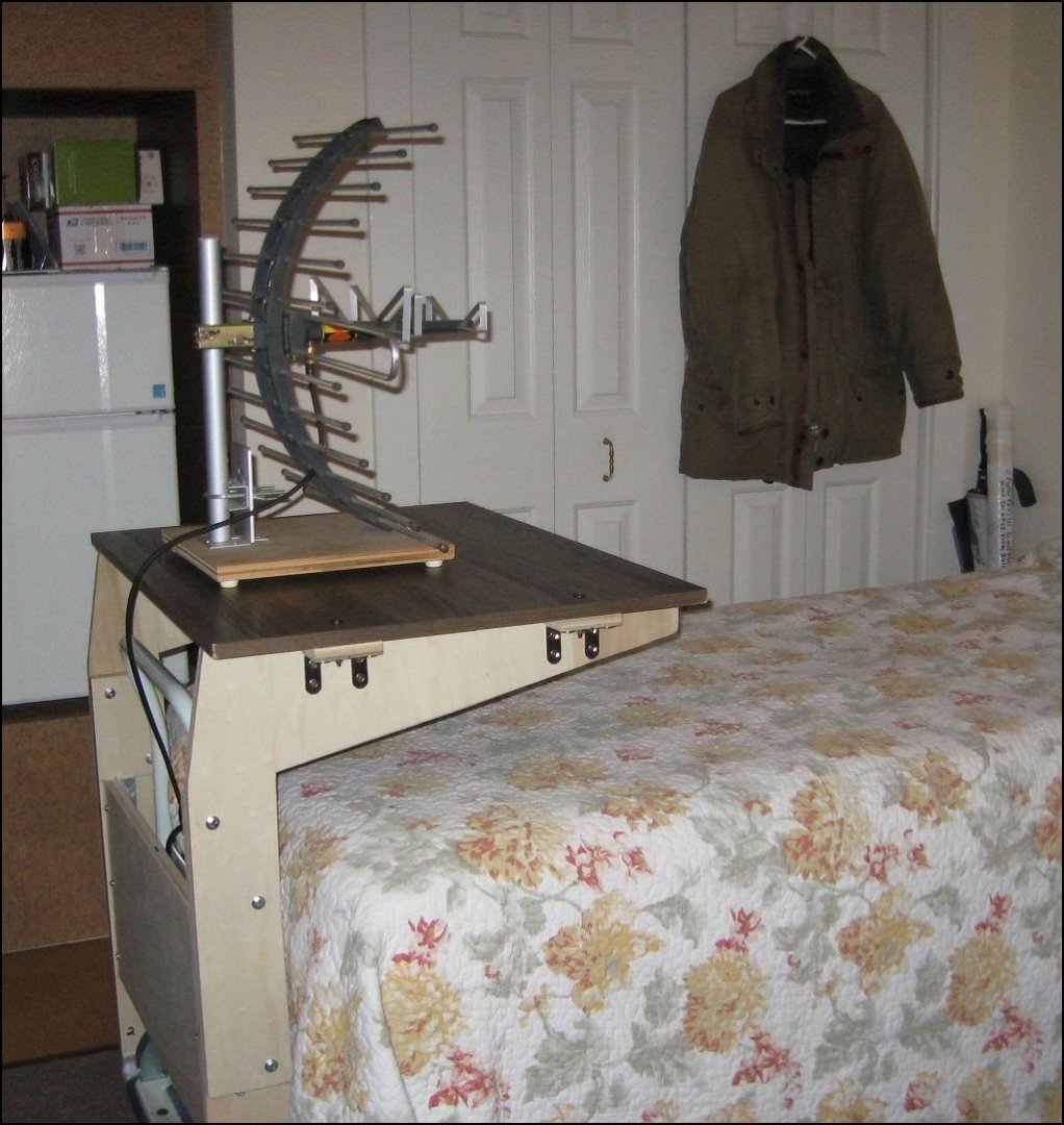

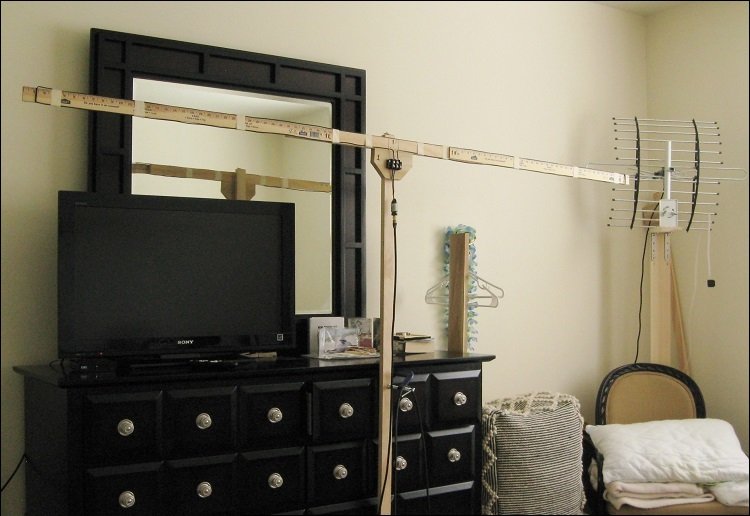

I started doing antenna experiments when I was 8 years old with a crystal set radio. I am now 91 years old, living in a retirement home, and still doing antenna experiments with SDRs.
I have a small room. I found that the best indoor antenna location for good reception was over my bed! So, I had to build a table over my bed for a GE29884 antenna. Less multipath and EMI from AC power wiring there.

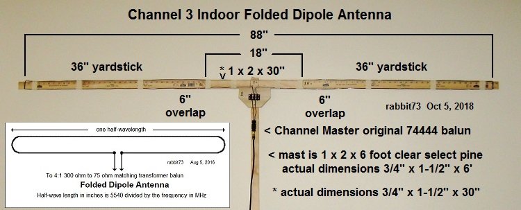

When I had a larger room, I had a channel 3 folded dipole test antenna 88 inches long..
