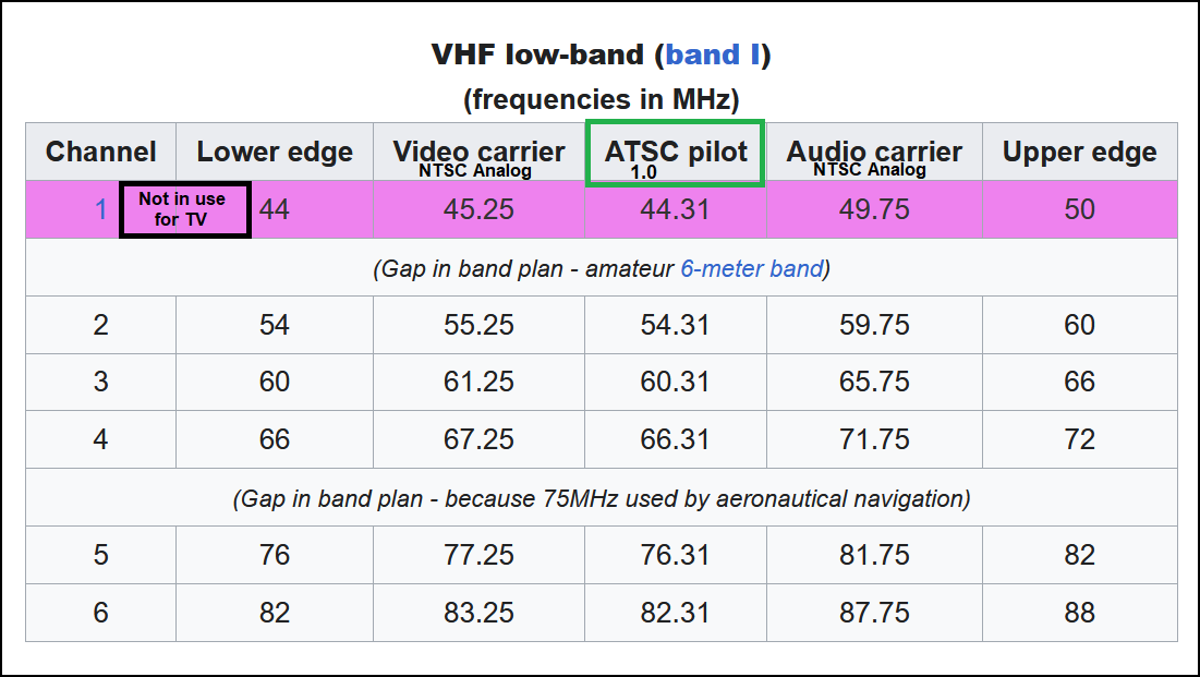

first want to see if I can pick up / receive a radio signal.
Here is a chart of our US VHF-Low Channels:

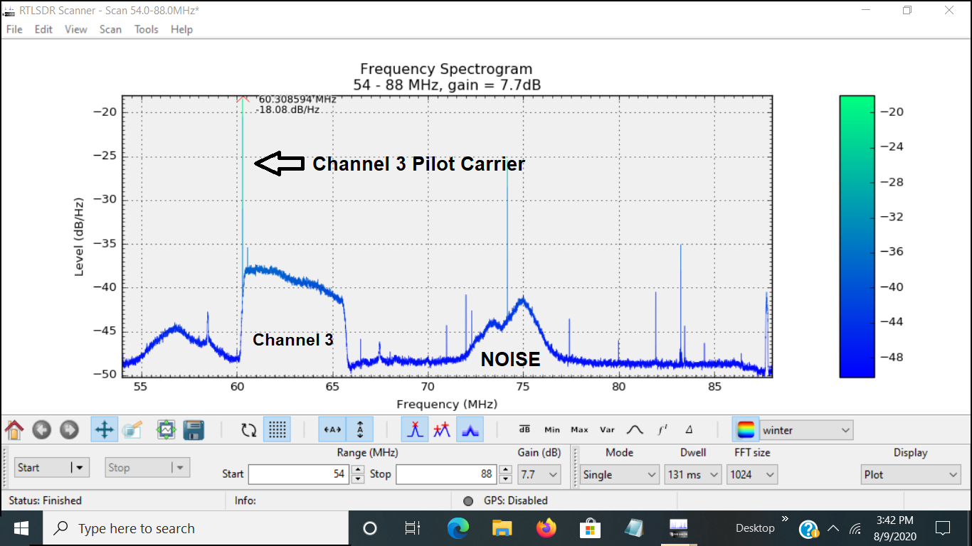

This scan, using an RTL-SDR V3 dongle and GitHub RTLSDR Scanner software, shows the channel 3 Pilot Carrier:

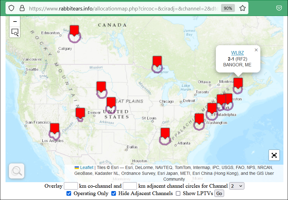

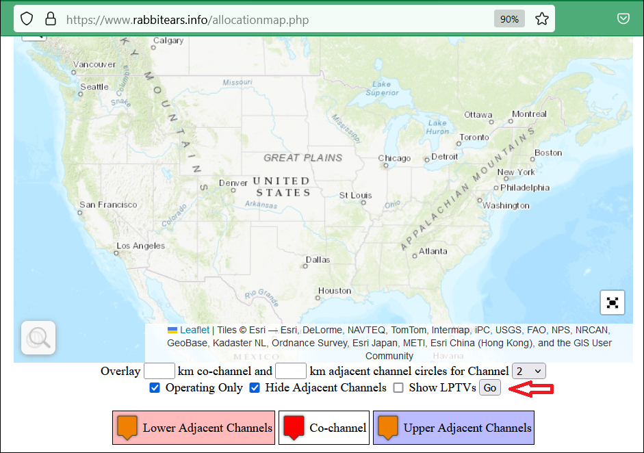

As N5XZS mentioned in post #24, the rabbitears.info site can be very helpful in finding US VHF-Low channels. Start with this page first:
Allocation Map for Channel
https://www.rabbitears.info/allocationmap.php
For all channel 2 allocations, fill it out like this, and click on Go:

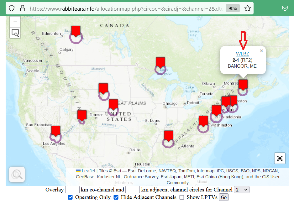

The result should look like this:

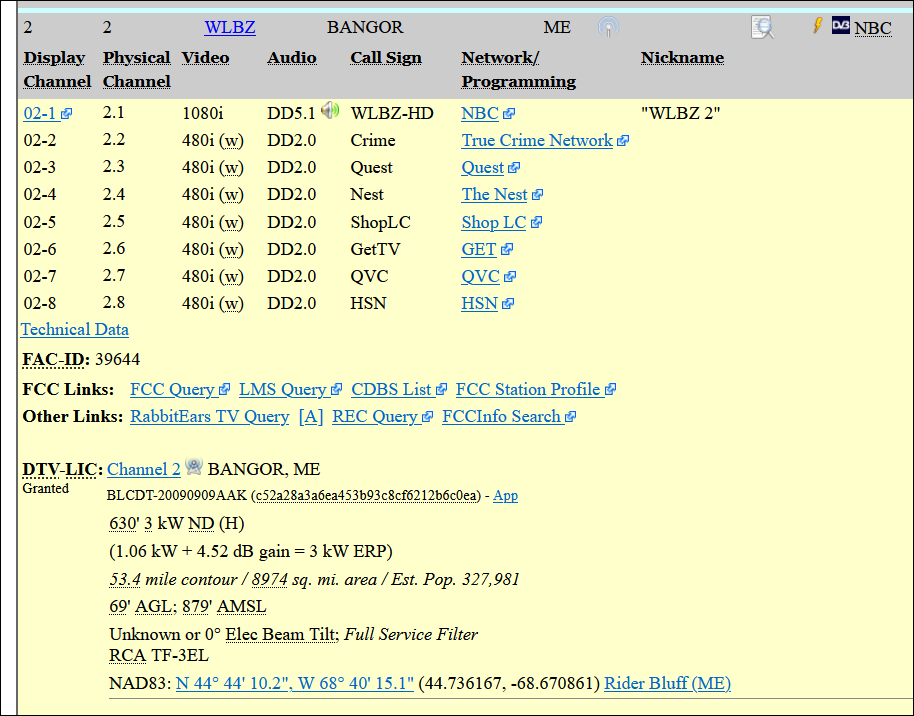

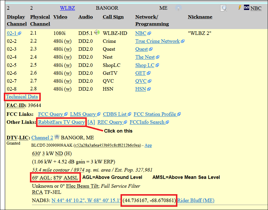

If you click on WLBZ and then Technical Data, you should see this:

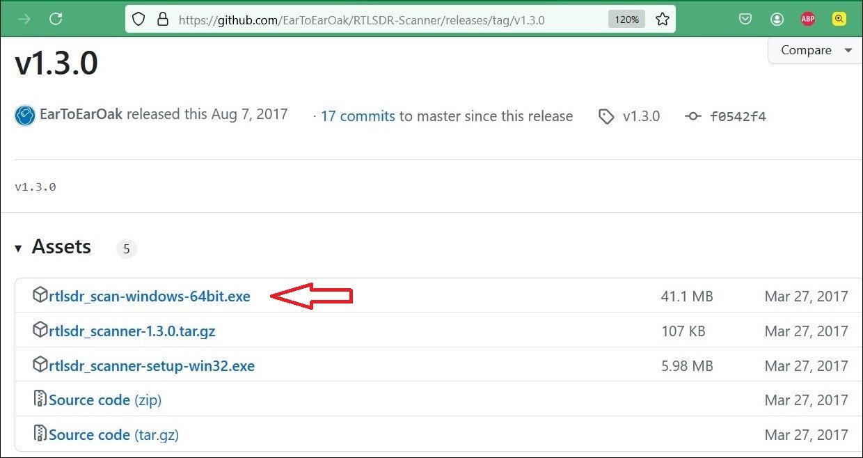

The RTLSDR Scanner software is available here:
Releases · EarToEarOak/RTLSDR-Scanner
I use version 1.3.0

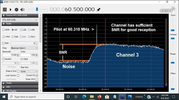

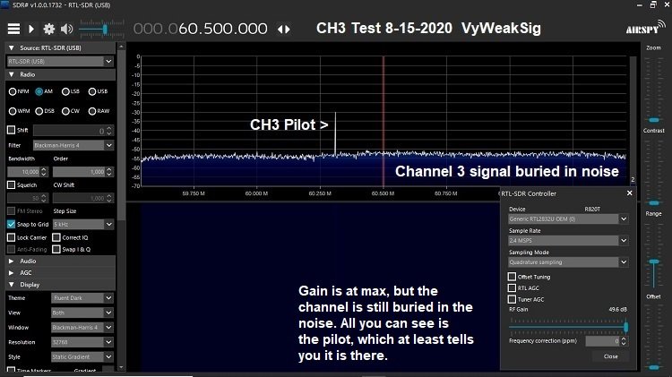

It took me 3 training sessions to learn how to use the Scanner software. If you also find it difficult to learn the Scanner software, you can use SDR# (SDRSharp) software instead with the V3 SDR. It will only show a little more than 2 MHz of the 6 MHz TV channel, but that is enough to show the low end of the channel to see the Pilot Carrier and estimate the SNR.

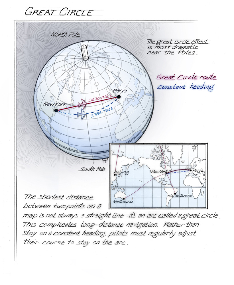

Like airline traffic, I believe the transmission from the United States will be coming into Europe over the Arctic region (shortest distance and all). Get a globe, a push-pin, and some string to measure the direction to the larger cities like Boston, New York, or Philadelphia (where the AntennaMan is located, I believe.) This will not be west-southwest, but more west-northwest.
Well, wait- the shortest course being a straight line, why any heading adjustment en route? The shortest actual distance is only represented by an arc on a flat map.
Well, you could translate the whole map grid to polar coordinates and arbitrarily put the North Pole on top of your location. Then, all direct routes to you are straight lines…😁
right, on flat map as well as globe
As long as your flat map's projection is adjusted for your location. But the Earth's not flat, you know? Which is why I suggested a globe as the easiest way to visualize the antenna's bearing to attempt to DX USA ATSC broadcasts.

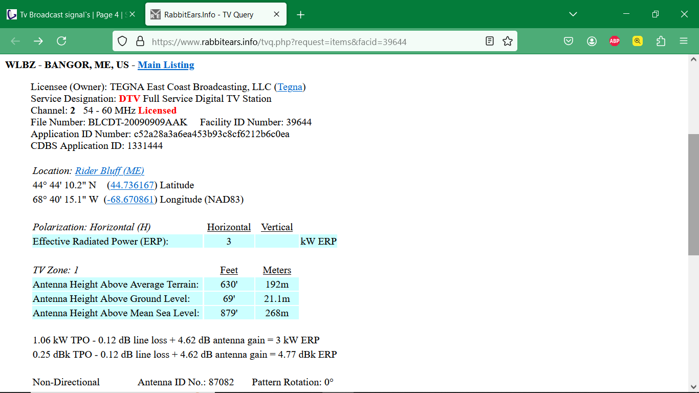

Have a question :
As soon as I enter the : Allocation Map for channel, and channel nr does not matter , whether it is : 2 or 4 or 6 . How can I see with what power and how high the transmitter mast is. I'm playing around with that Site a bit to get it.
Mvg
Because the earth is not only a spheroid shape but it is turning eastward at about 1,000 mph. You have to aim at the spot where your target will be when you get there. A 9 hour trans Atlantic flight lands at a point 9,000 miles east of where it was when you left. There is also the factor that the atmosphere is spinning sort of with the ground below.
For radio wave communications the rotation is supremely insignificant, just aim at the point of desired reception on the great circle map.
Have a question :
Mvg
