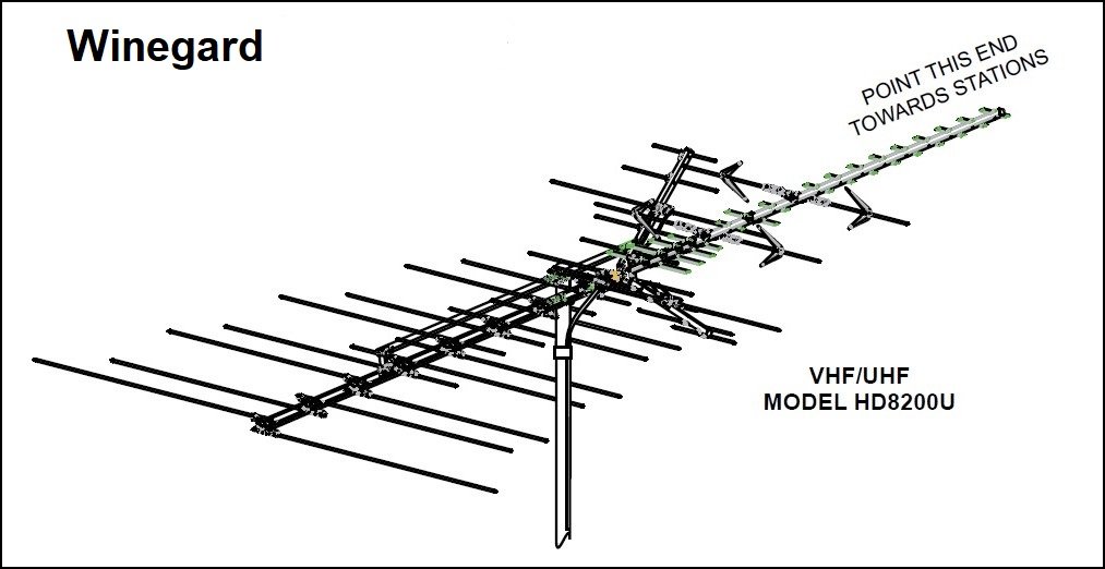

Harry is correct. It would be difficult for a Yagi design to cover all channels 2 to 6. But a Yagi would give the best gain for just one channel.
The way that Winegard solved the problem is to use a log periodic design (LPDA). An LPDA can use a single boom with insulators and crossover wires or a double boom.

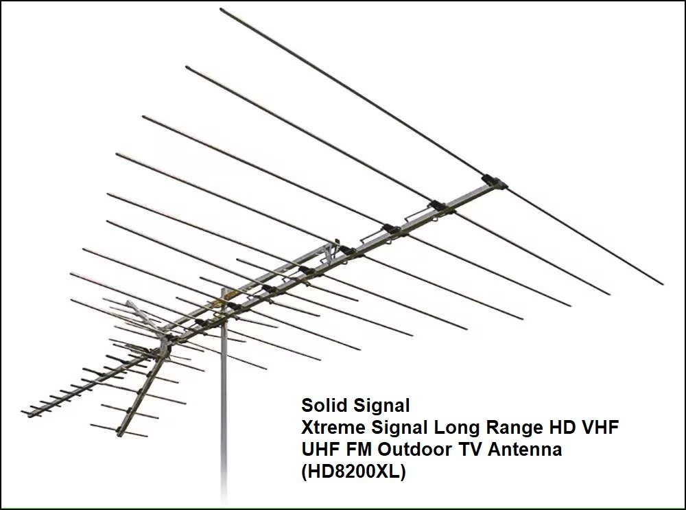

This is a less expensive clone (copy):
Xtreme Signal Long Range HD VHF UHF FM Outdoor TV Antenna (HD8200XL)

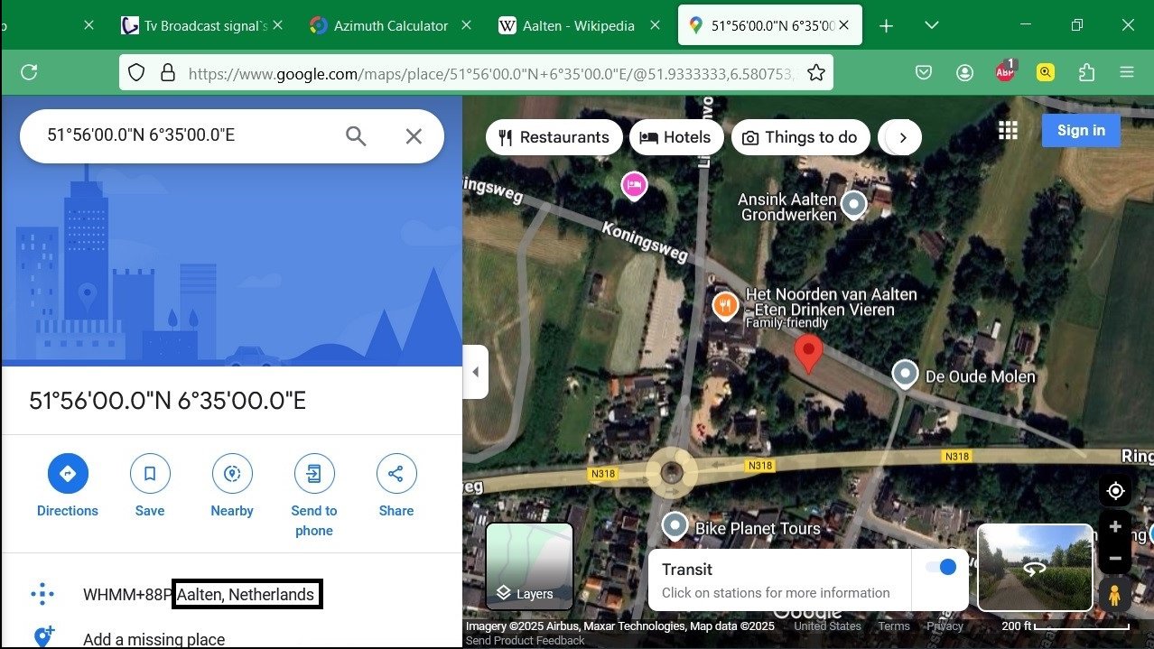

There is not a signal everywhere. I have experienced this here. In the attic, with a funke antenna that is intended for the Uhf and the transmitter tower is 30 km from Aalten (Holland) where I live. Mvg
Yes, how to aim your antenna is important, especially with a high gain antenna.
Aalten - Wikipedia

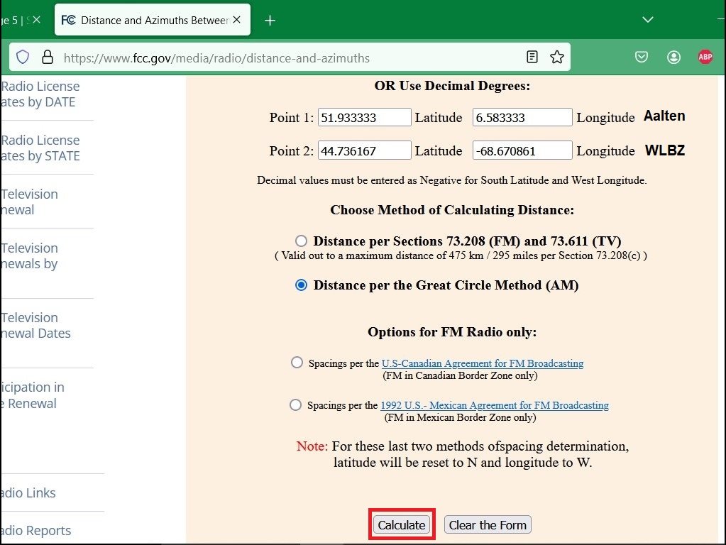

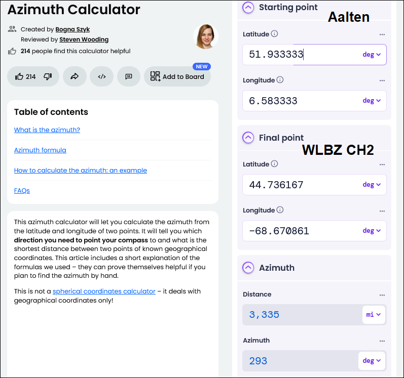

I tried this calculator:
Azimuth Calculator

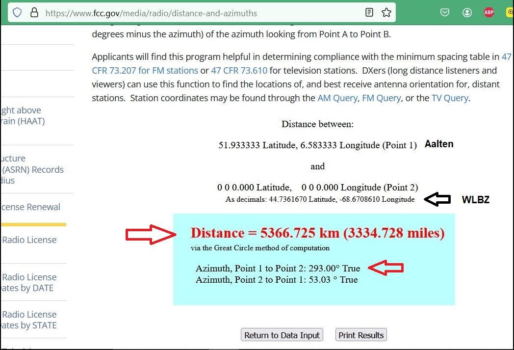

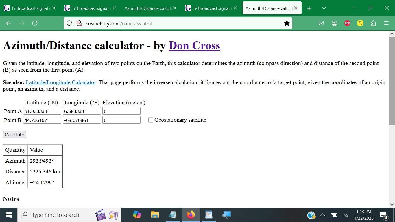

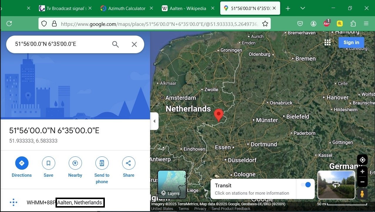

The coordinates of : WLBZ Bangor, Me and Aalten are known. How do I calculate or draw a line to see how long the distance is. Because that's what the calculator wants to know. It may be very simple. Mvg
1. You give the coordinates to the calculator.
2. The calculator gives you the azimuth AND the distance as the answer.
This video shows you how to do the calculation. I requires a bit of geometric math. Lots of sin and cos calculations but you are really calculating the length of the arc between two points relative to the center of the earth.

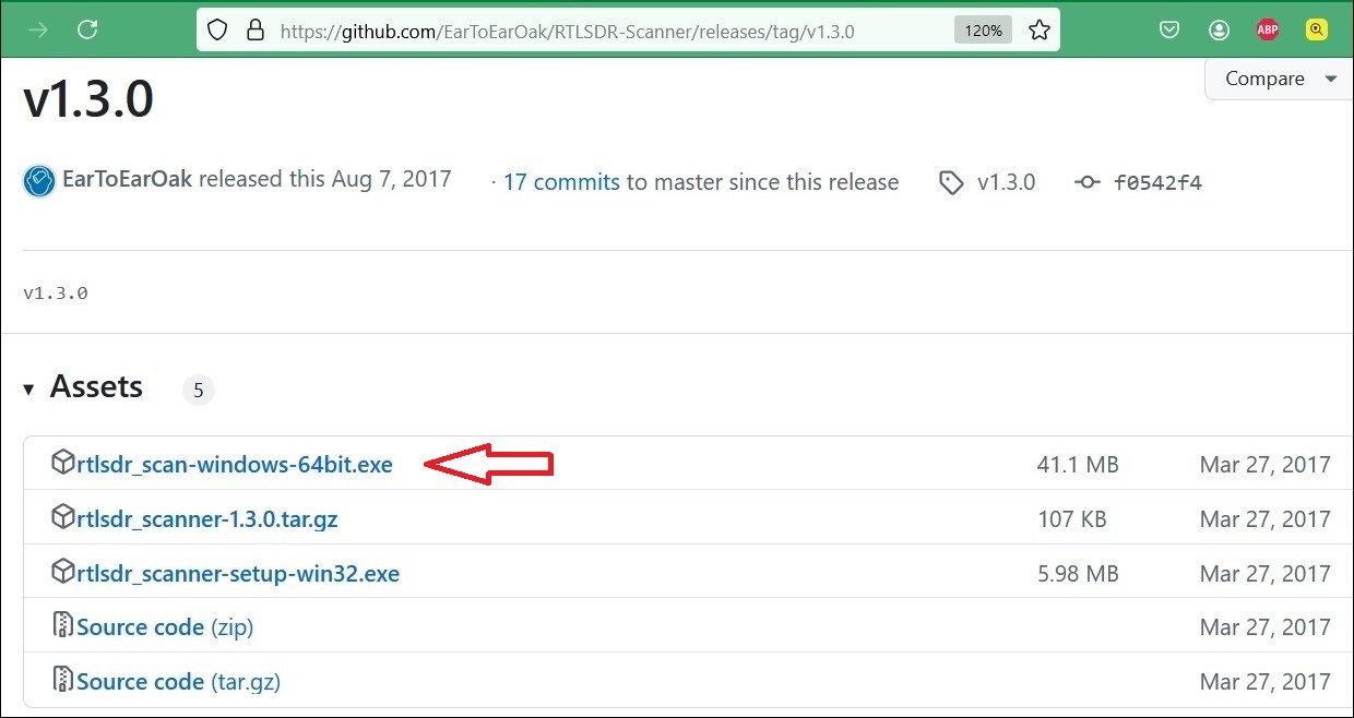

The RTL-SDR V3 dongle SDR is available here (the V4 doesn't work with the Scanner):
Buy RTL-SDR Dongles (RTL2832U)
The RTLSDR Scanner software is available here:
Releases · EarToEarOak/RTLSDR-Scanner
I use version 1.3.0
There is a short tutorial by Pete Higgins:
OTA Signal Analyzers, Meters, Aimers, Bench Gear...
It took me 3 training sessions to learn how to use the Scanner software. If you also find it difficult to learn the Scanner software, you can use SDR# (SDRSharp) software instead with the V3 SDR. It will only show a little more than 2 MHz of the 6 MHz TV channel, but that is enough to show the low end of the channel to see the Pilot Carrier and estimate the SNR.
