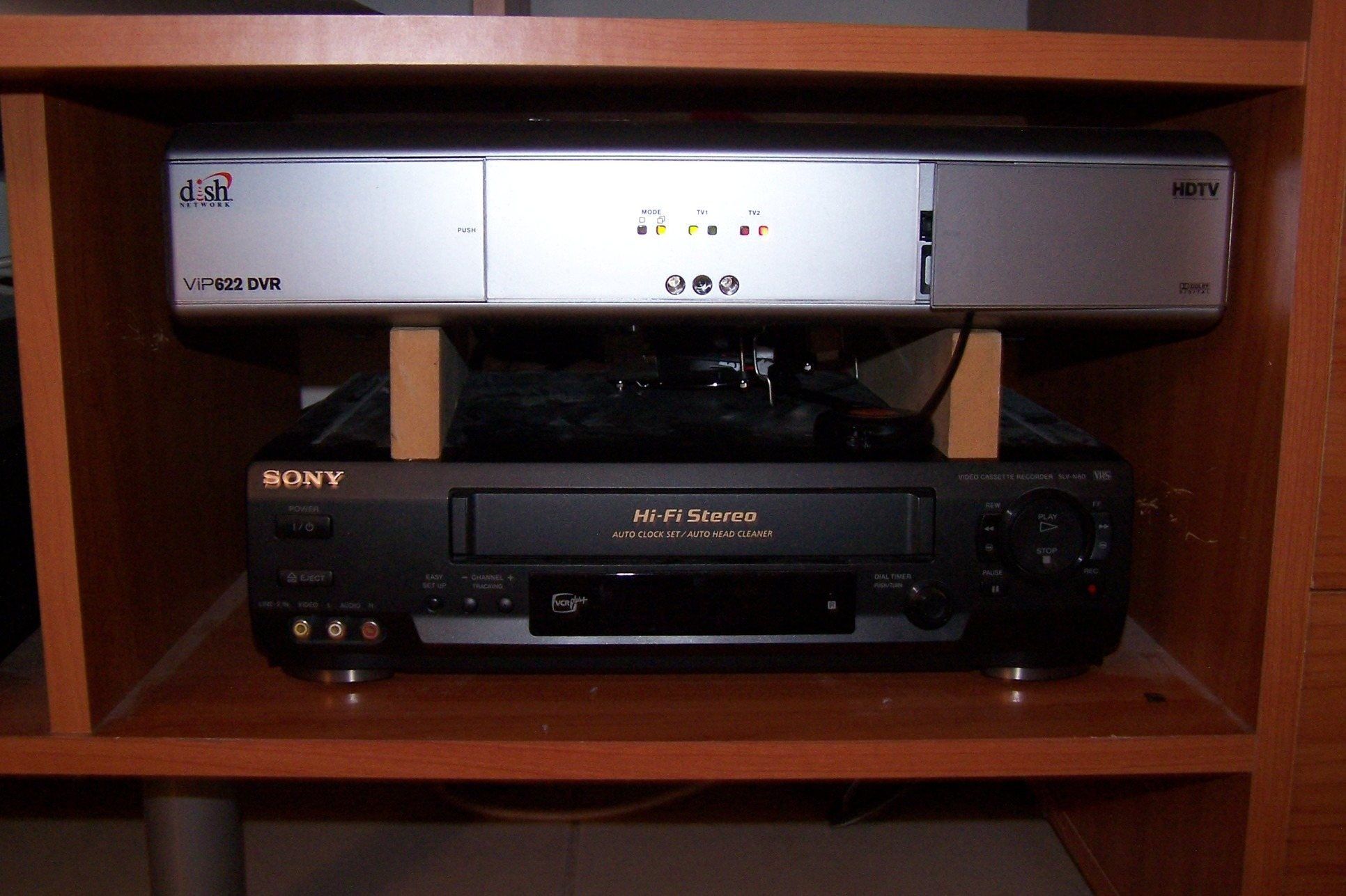

Attached is picture of my really cramped space. I put the receiver up on 2 pieces of mdf about 3inches wide. I have 4 options:
1) Put fan under receiver (as it is now), and have it blow air up
2) Modify fan (remove one of the grills) so it fits on either the right side blowing in, or on left side, sucking out. Either way, one side will sit flush with the cabinet wall.
3) Place fan in the back somehow since there are a lot of cables. However, I do not see any grills on the back panel, so I am not sure this option will actually cool anything.
4) On top blowing down? I guess is a 4th option.
Thanks again for all help and ideas. Gotta cool this thing down!!

This worked for me:
Remove top cover and add a fan blowing down angled so that it blows toward the right between power supply and hard drive.
Also, remove that obsolete piece of equipment under it if you can so there is more room on top for airflow.

This should be an easier decision then everyone is making it. You can try all the tips that everyone is recommending but you still come down to a piece of equipment that is not working right. If it is running hot then have it replaced. Simple as that. I had a 622 that I bought from a local retailer that kept running hot. I had it in an open cabinet with more than enough air to circulate and it still ran hot. I had it replaced and it has been working fine. No problems at all... yet. It has been working fine for several months now.
No offense to anyone that responded before me. I just think that spending $30-$50 on something to keep a bad receiver cool is wasting money. Why not spend just $5.99 and get it replaced? The OP is right, times have changed and money is tight... even if it is only $30.

All I did was this:
http://www.satelliteguys.us/dish-ne...perature-thread-yours-hot-29.html#post1617381
It only cost me around $8.00 US, and a little bit of time. It's been great since I installed it, and I have a real tight cabinet. Looks ugly, but who cares, as it can't be seen when the cabinet is closed. It's plugged into the front usb port, and is extremely quiet. I would have bought the Ebay fans for $30, but first I wanted to prototype this, and since it works, I'm staying with it. Also, the receiver sits on top of 16oz pop bottle caps under the feet. The original feet nestle inside of the pop bottle caps, and raise it up for more air to suck from under as needed.
