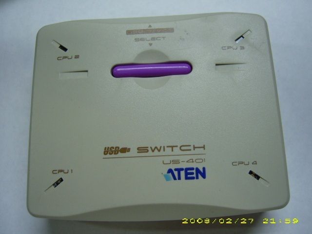

Get to the USB switch: ATEN, model US-401.
A note - it will require special cables, as initially created to connect one device to many CPUs. Just is too old (6 years) model.
I'm sure now you can find other one with proper connectors.

I got the unit Bill R recommended in post #6. You need the A female to B male adapters and a more difficult to find male A to male A cable to connect your 622/722 to the switch (most USB cables are male A to male B). I did all that and now I can switch painlessly between up to 4 EHDs. I'm using 2 now and when I switch I just acknowledge the disconnect and then acknowledge the new one from the screen prompts.

I'd be nervous using bill's switch (post #6). It's mechanical. The contacts can get dirty. It's probably got many impedance mismatches (solder joints, wires, switch). It could effect USB2 signal integrity.
