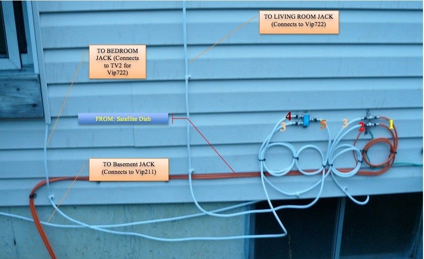

Please find attached a picture showing the following connections:
1 = Cable from satellite dish
2 = Cable from Satellite dish/hub to basement jack that feeds Vip211
3 = Cable from satellite dish/hub that connects to the vip722 hub on the left
4 = Cable from Vip722 dish/hub that feeds bedroom jack
5 = Cable from that feeds the Vip722
What stumps me from the picture is that there are two cable outputs from the satellite dish: one to the 211 jack in the basement, and I was expecting the other (#3) to go to the 722 jack/splitter, but it didn't.
In the meantime, I think I should be able to swap cables 2 & 4: i.e, switch the bedroom and basement cables so that the satellite feed currently feeding the basement (#2) now feeds the bedroom.
Well, I await your explanation and thoughts.
Thanks in advance. Punda.
From the way you have it labeled, switching 2 and 4 will do what you want. #3 should be going to the SAT side of the diplexer, and it looks like it is.
Sure enough -- i switched it, and it worked. At first, it said "complete signal loss on both TVs, and then it came back on. Thanks very much for all your help. cheers, Punda
