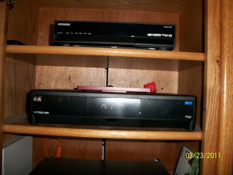

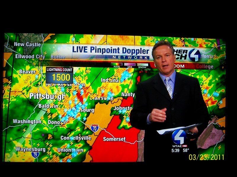

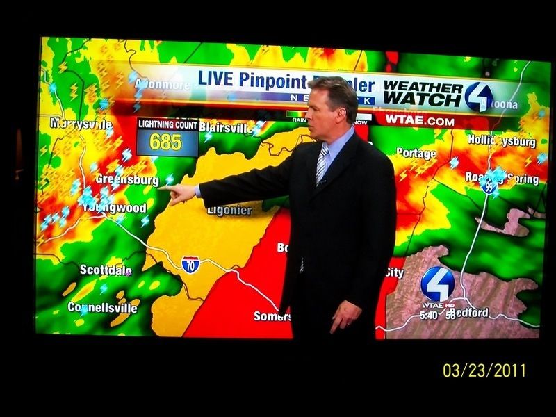

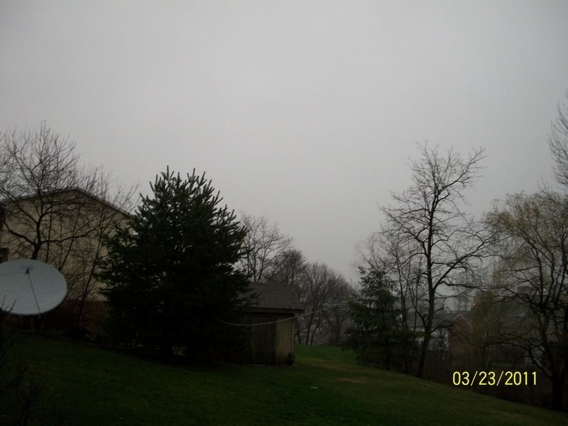

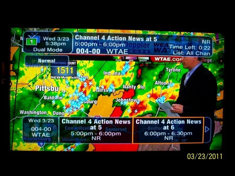

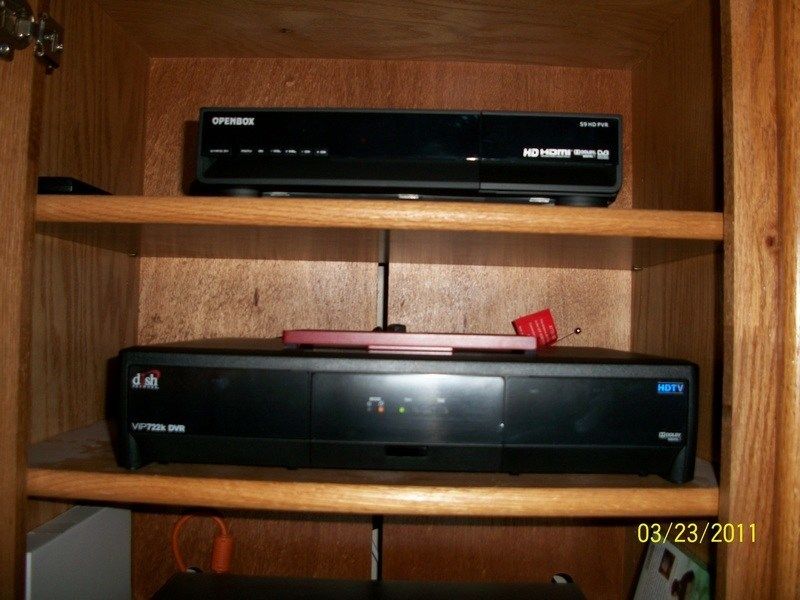

I have to admit I'm now very impressed with Dish Network's customer service. They sent out a technician the very next day who installed a new LNB, replaced a run of coax and installed a brand new VIP722K HD DVR receiver and two remote controls.
Even my wife who doesn't usually notice the difference between SD and HD programming said WOW when she saw the picture quality difference between our old VIP722 and new VIP722K receiver. I'm also very impressed and plan on remaining a Dish Network subscriber for many years to come.

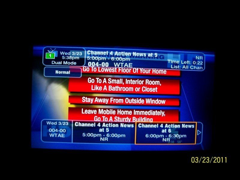

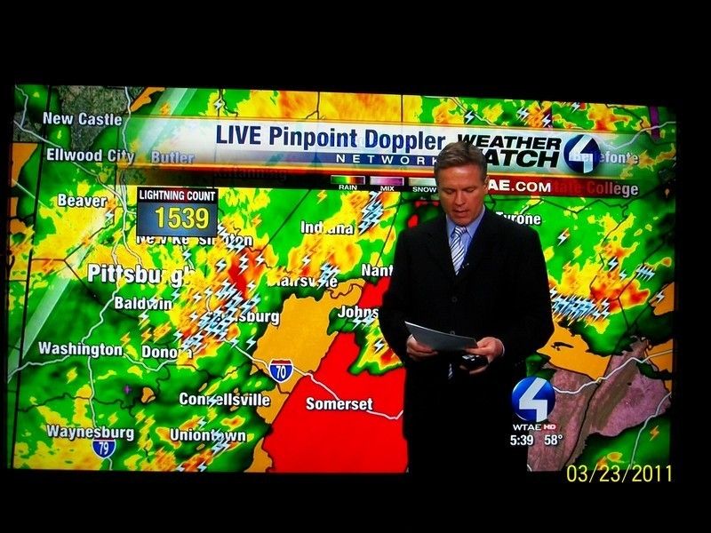

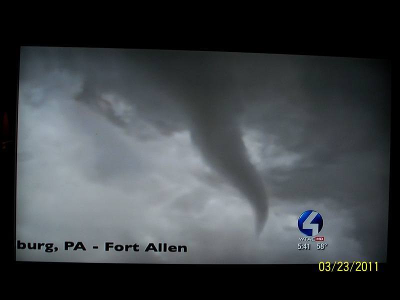

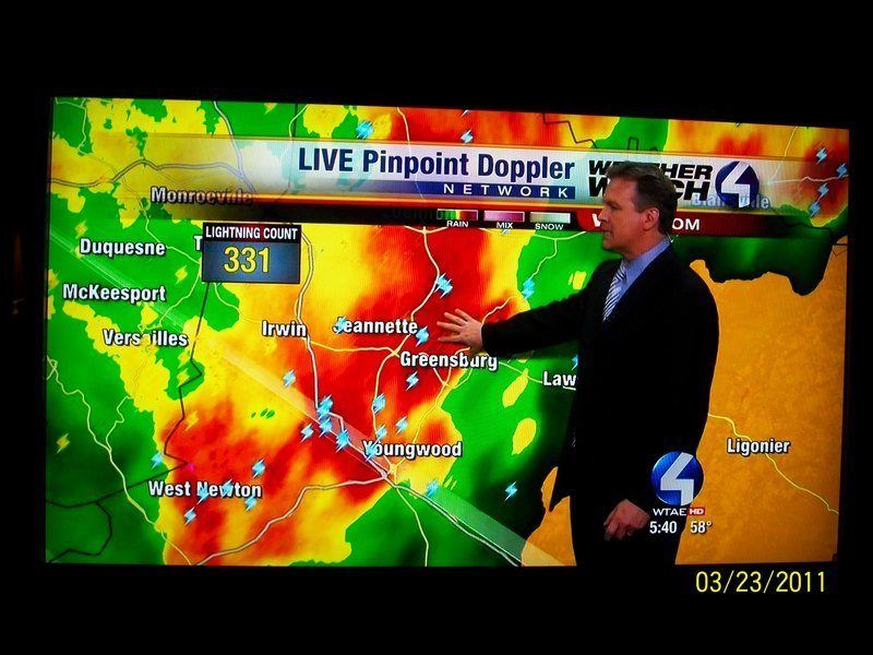

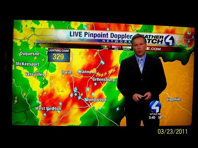

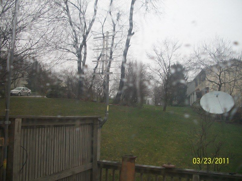

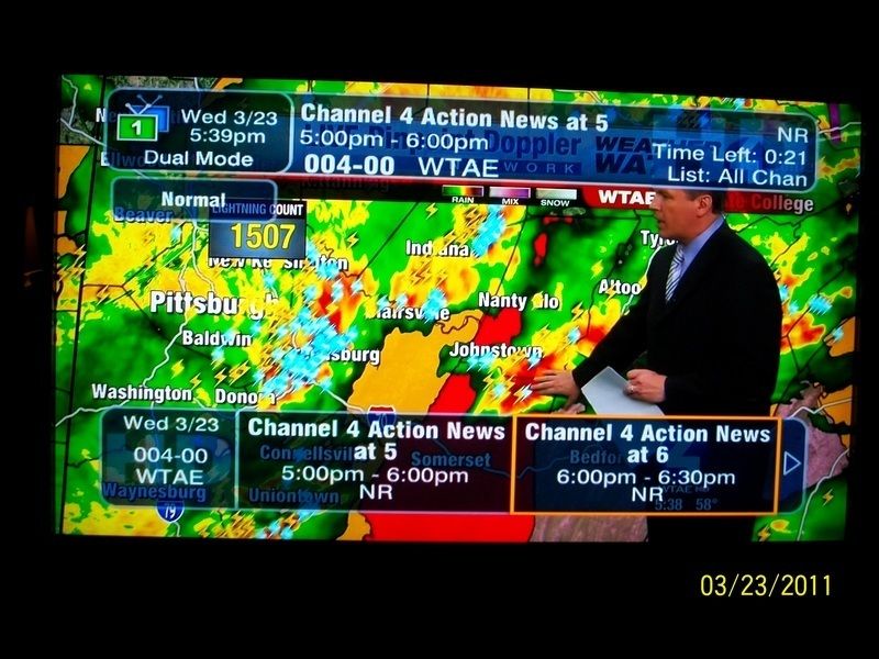

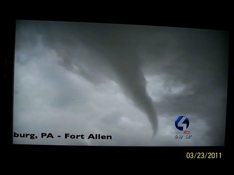

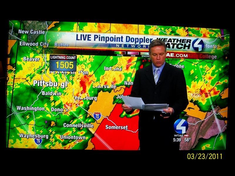

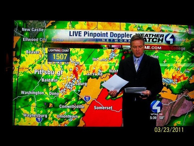

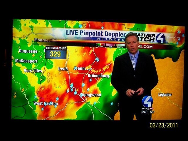

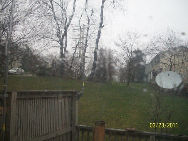

When I arrived home we had heavy rain with large hail in the area and still the picture looked fantastic with no rain fade. Below are pictures.
