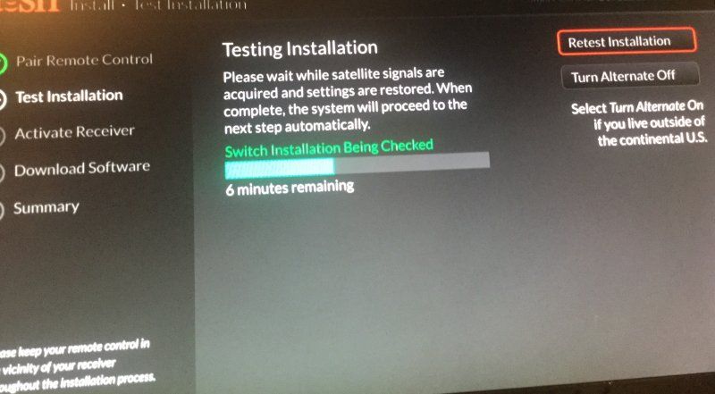

Hopper is in the installation phase and stuck on the acquiring satellite signals page. I don't think I've moved the dish at all, and the existing 722 (connected directly to port 3) is still showing picture.
Port 1 is into the blue and line to hopper connected to purple. I've reset the test and it verifies switch, gets past that and then spins on acquiring satellites.

It stays on this screen forever. Once it got past the verifying switch and said it was trying to get satellite, but since all I get is this...either 10 min remaining, or 6 min. Never times out, never gives error message etc.
View attachment 136764 It stays on this screen forever. Once it got past the verifying switch and said it was trying to get satellite, but since all I get is this...either 10 min remaining, or 6 min. Never times out, never gives error message etc.

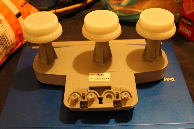

A hybrid LNB only has TWO ports and an input.

Yep, that port 3 is an input for a wing dish. Also, don't cap anything on the LNBF. Do you have a barrel you can use to bypass the Hub and make it a direct line From the LNB to the Hopper? Also, I'm going to give you a little heads up. Once you DO get past the check switch, it'll go to the activation screen. Leave it, don't activate. In about 5 minutes it'll show a scroll bar and say it's downloading software. Once that's done, it'll o to the Summary screen where you can choose to pair to TV, connect to Internet, etc.

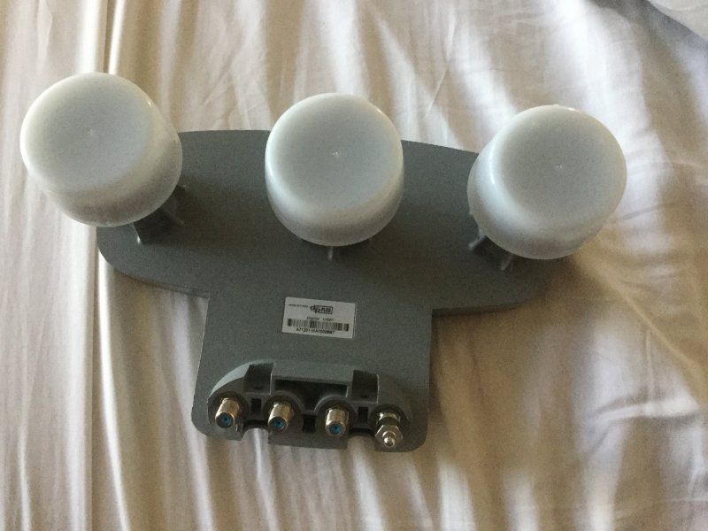

There are 3 ports on this LNB and an LNB In.
This is what I bought:
https://www.google.com/aclk?sa=L&ai...wi03ZD8l_rfAhXpjFQKHaLZAAsQwg96BAgTEAk&adurl=
I have port 1 connected to the hybrid solo switch, and port 3 to a vip722k. The LNB came with a cap in the box so I put it on the LNB in port.
Maybe I learned to count in a different class, but I see 2 outputs and 1 input. When a Hopper 3 is connected to port 1, it disables port 2

Yes I see what you mean. I need to look again at my LNB as I'm super sure it has 4 ports, and that picture has 3. Perhaps they sent me the wrong LNB and that's why it won't connect?
Reactions: JSheridan
That's a sure bet... If it isn't a hybrid its not going to work...
This is what they sent despite the order link I posted above..l.i think it's the same as what I have now....
