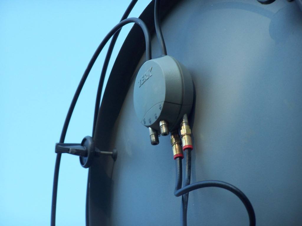

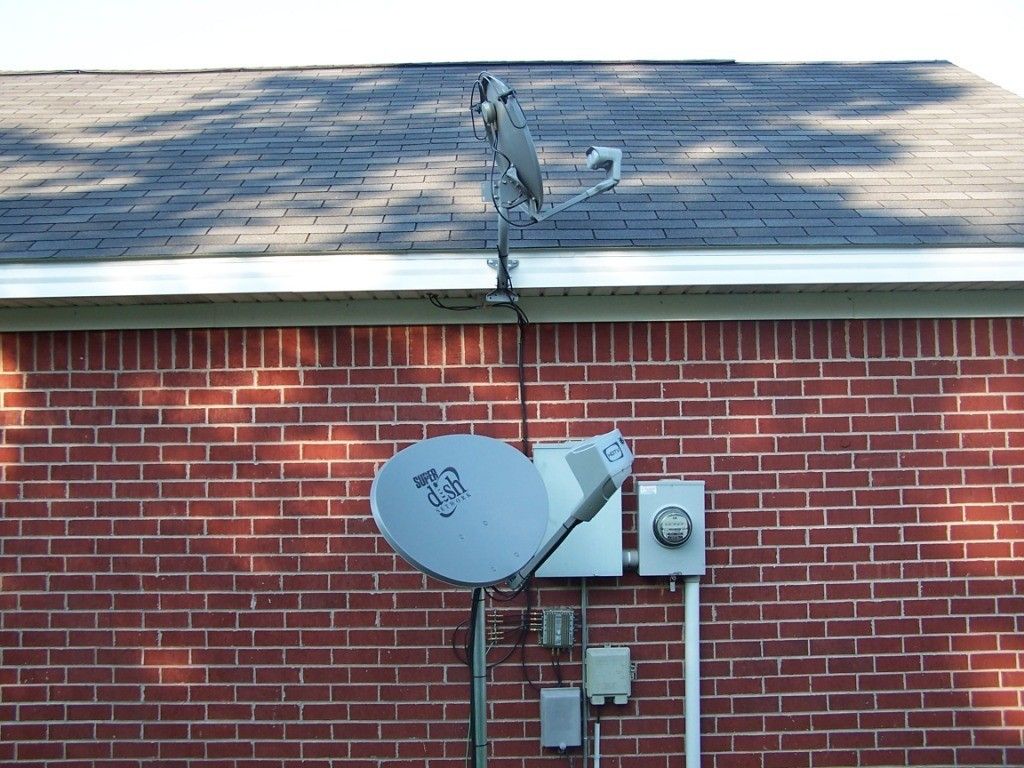

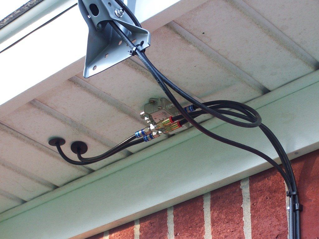

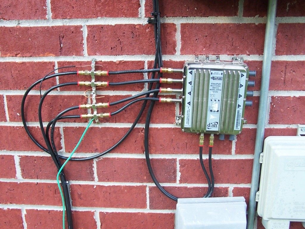

Was a Voom sub now with Dish. Installer showed up late and was at my house for over 6 hours. He left my house at 12:30 AM. I was and am still very unhappy. He replaced everything but the arm that the Voom dish was on. He replaced my Winegard Sensor II with some kind of Terk. He did try to keep the Winegard installed but the system would only pick up two sats. When he replaced the OTA antenna he was able to get all 4 sats. When I do a OTA channel scan I get none. If I try to add manually it never gives me a signal strength indication. I'll post some pictures to see if anyone sees anything that stands out.

-the dish on the overhang is there with 2 screws.....that bugger is a goner with a strong wind
-is there any diplexers involved? Why couldnt they just run the sensor II with a straight shot cable run into the house

First of all the Terk is a piece of junk. Even if it was installed correctly, your chances of good reception would be low. The DP44 switch will not pass the off air signal. If your Winegard was amplified, it received its power via the Voom receiver and a special diplexer. The diplexer in your setup should be placed after the DP44 switch.
I dont think you are going to get this to work without seperate cables....
mainly because the DPP44 requires power to port 1... and its hell to diplex on that port... its going to require 4 diplexors per cable run...
Ant-diplex-----diplex-switch-diplex-------diplex-receiver
and if that antenna receives power it needs to go before the first diplexor...
trust me a strait shot would work wonders.... though that terk is crap
This happened to me on my first Dish install. He installed it with 2 screws on the overhang. It worked fine for about a year, but then the weight of the dish began to pull down and slightly bent the metal fascia, I noticed more and more picture drop outs. If I went out and pushed the dish back up, the signal improved on the signal strength meter. So thankfully last year when I had Dish come out to install my 61.5 dish, the installer looked at the install and shook his head and re-installed it on the roof. That guy did an excellent job! Since that was done, I have never had a signal loss.

That would depend on what they used. Some V* installers used a simple 3x4 switch. Some used diplexors, and some used a double diplexor at the dish. The 811 should be on port 2, and you should be able to diplex with power passing diplexors at both ends and no power inserter for the antenna. Do NOT allow a dixplexor on port 1. I've never seen that type of diplexor before. Can you get a better picture of the full face, or at least a manufacturer and part #?
