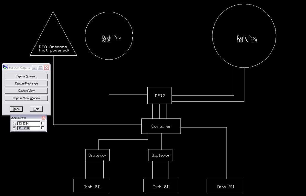

Ok I have updated the diagram with the fore mention posts. My Voom install and OTA antenna was done using a Aspen Multiswitch....I am assuming this wont work with dish pro so what combiner will I have to buy or will they supply that with the install? Thanks!

1) 3020 combiner is not needed for unpowered OTA antenna
2) You can't feed a receiver off of a combiner
Just let the installer hook you up ;) :
