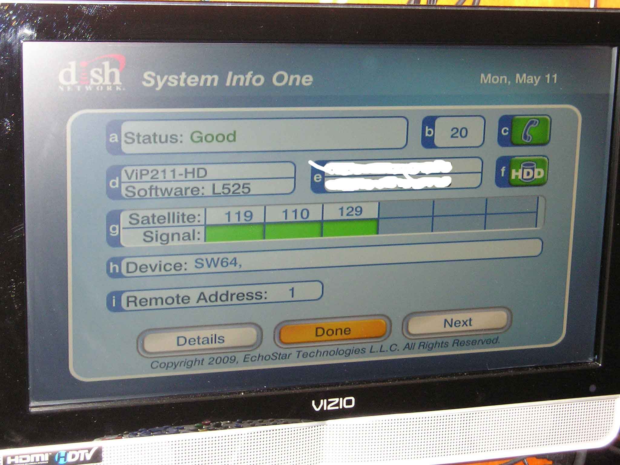

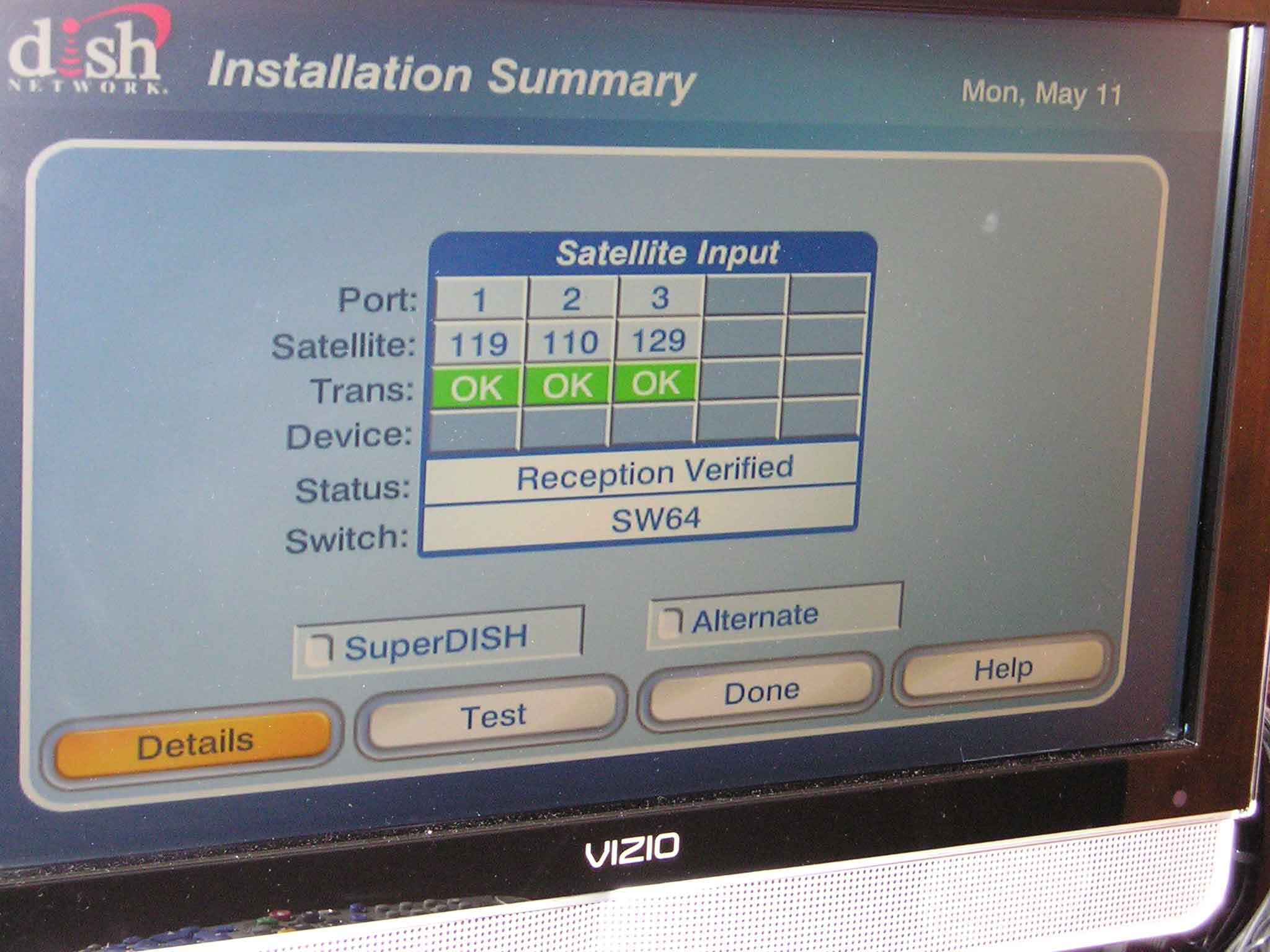

Fixed, at least on 211 receivers. reran switch check today and checked all transponders even/odd.
Yep, i swung my 61.5 over to 129 last night and the 211K is finally working Properly on that sat. All is well now! :D:cool:
