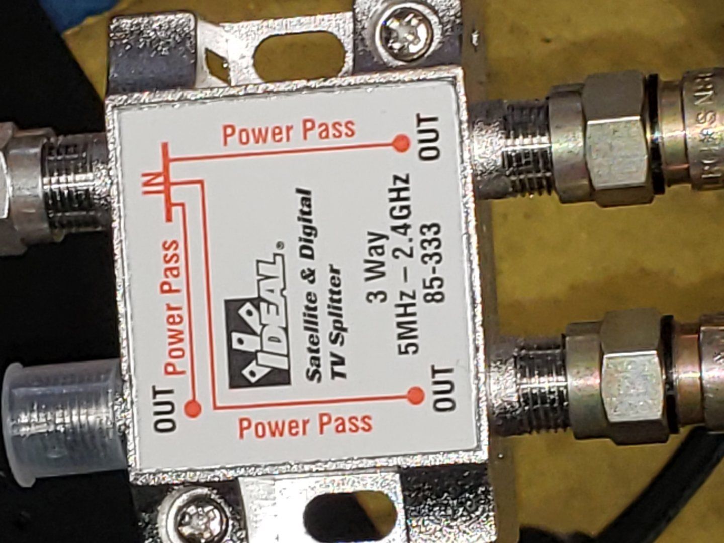

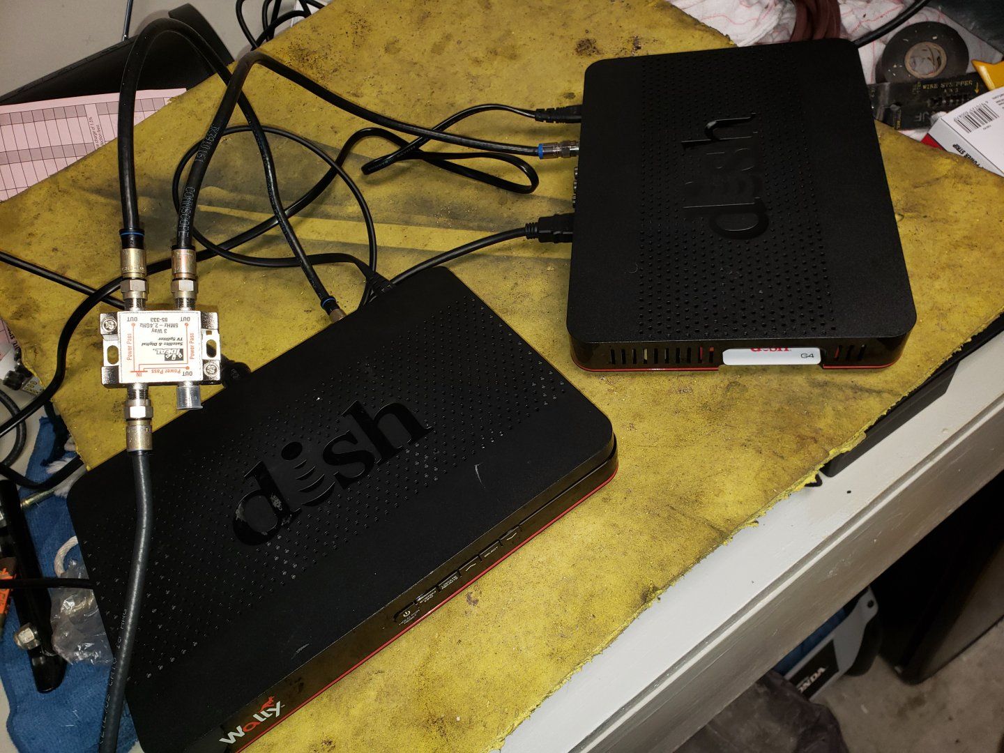

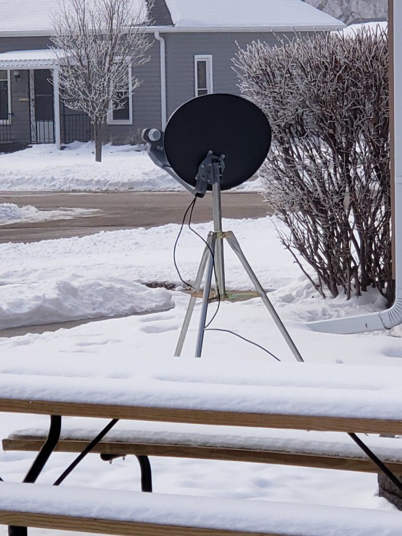

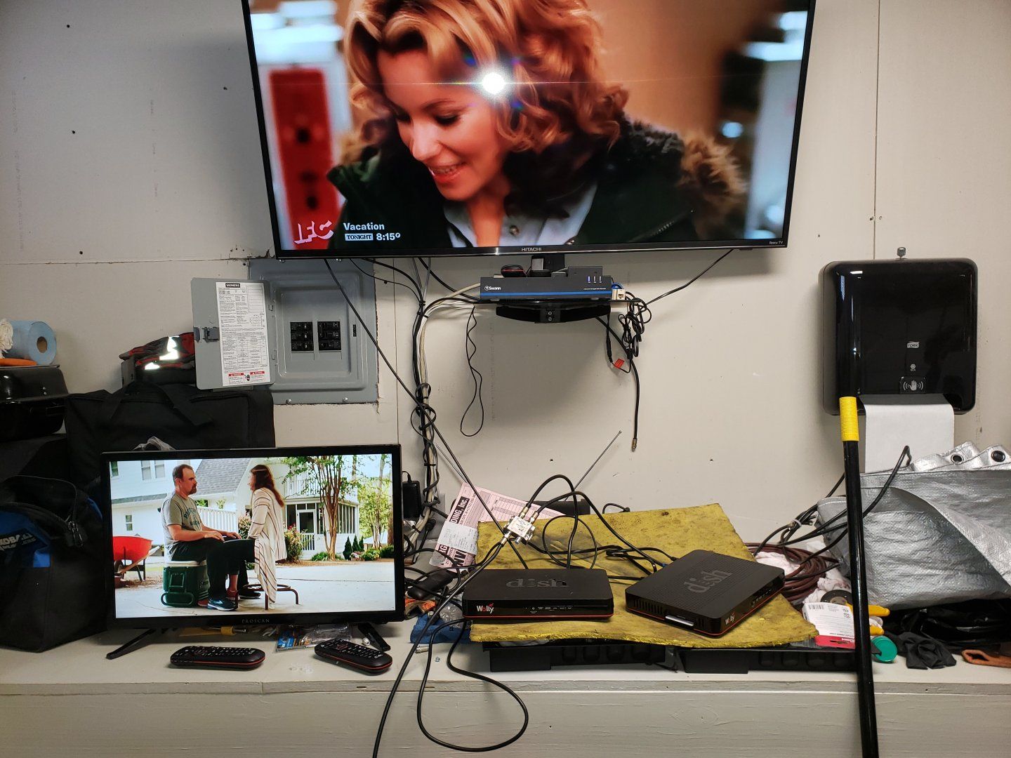

I asked that same question myself and couldn't find an answer anywhere so I took it upon myself to figure it out and here's what I came up with.
The dish Wally will work with the 1000.4 Western/Eastern ark dish with a DPH -LNB if using only one Wally a single wire directly to the Wally and then to the TV worked perfect. If using more than one Wally you must run a direct connection from the dish to each Wally one at a time to activate the Wally once it's activated disconnect the direct connection and use a power pass splitter I found mine at Lowe's for $7 one wire from the dish to the splitter. And then the outputs to each Wally. This configuration allows you to tune to different channels on each Wally. I hope this information helps someone I sure wish I could have found it to help me
