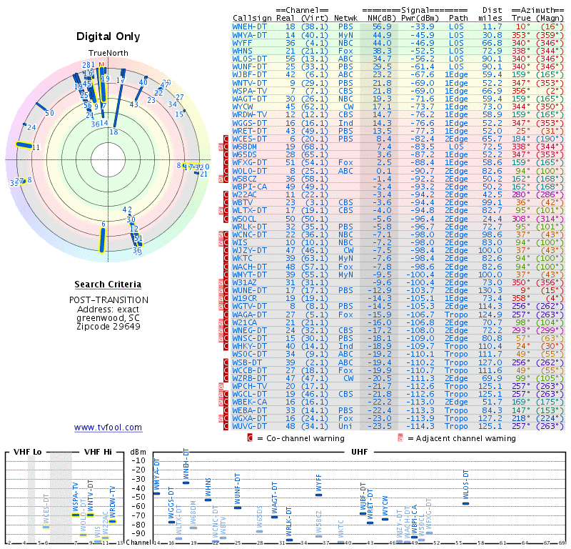

I am wanting to install my first OTA antenna. After doing a lot of research I decided just to ask you guys your opinion on what antenna I should get. I attached my signal chart from tvfool. Zip is 29649, Greenwood, SC. Thanks for the help! I no longer want to be a slave to my DirecTV bill! 4, 7, 13, 21 are the most important channels to me.

Best cost-effective solution in a combination antenna is the Winegard HD-7696P for channels 7-69. Mount it outside, as high up as you can.
You may benefit from adding an antenna pre-amplifier, particularly if you plan on feeding signals to more than one tuner. Use a low-gain model like the Winegard HDP-269. With that PBS station on 38.1 so close by, high-gain pre-amps may cause tuner overload that can result in DTV reception issues.
For an outlay of maybe $200, the antenna will pay for itself in about 3-4 months!
Go with the Winegard.
