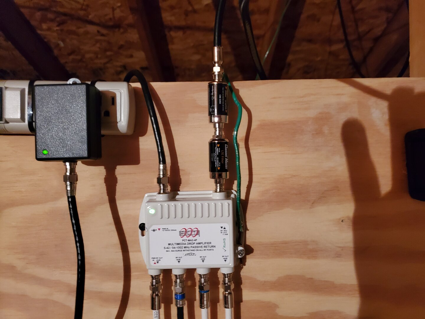

I stack two CM filters (FM & LTE) at the input to my drop amp. I agree they work, I have strong FM transmitter all around me, and two T-Mobile 5G towers one mile away. One is directly in front of my antenna and the other behind. The filters solved my problems 100%.
