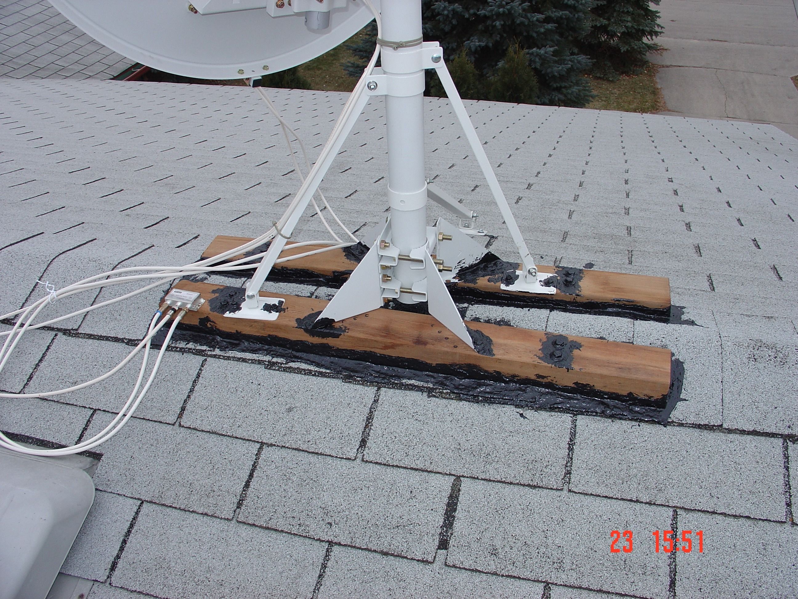

If your roof mount is correctly installed, it may be your house. Not knowing how your house is constructed, here's a few ideas what may happen. A house is not a solid object, but moves with the effects of temperature. Example: If the north side of your house has 1/8 inch more frost heave than the south side, that 1/8 inch is exaggerated on the peak of the roof, tilting the mounting pole. Example: If you have one of the antenna support poles secured to a piece of plywood under the shingles, that piece of plywood could actually be warping at extreme cold, again tilting the mounting pole off plumb. Example: Wood in a house expands and contracts depending on the temperature and humidity. Certain supporting wood structures of your house may be contracting to a point that the house shifts, again tilting the mounting pole. Unfortunately, the only way to know for sure is to get an accurate protractor and check the mounting pole for plumb at various temperatures, not something real fun below zero. I hope it's something else. Whatever it is, have fun.

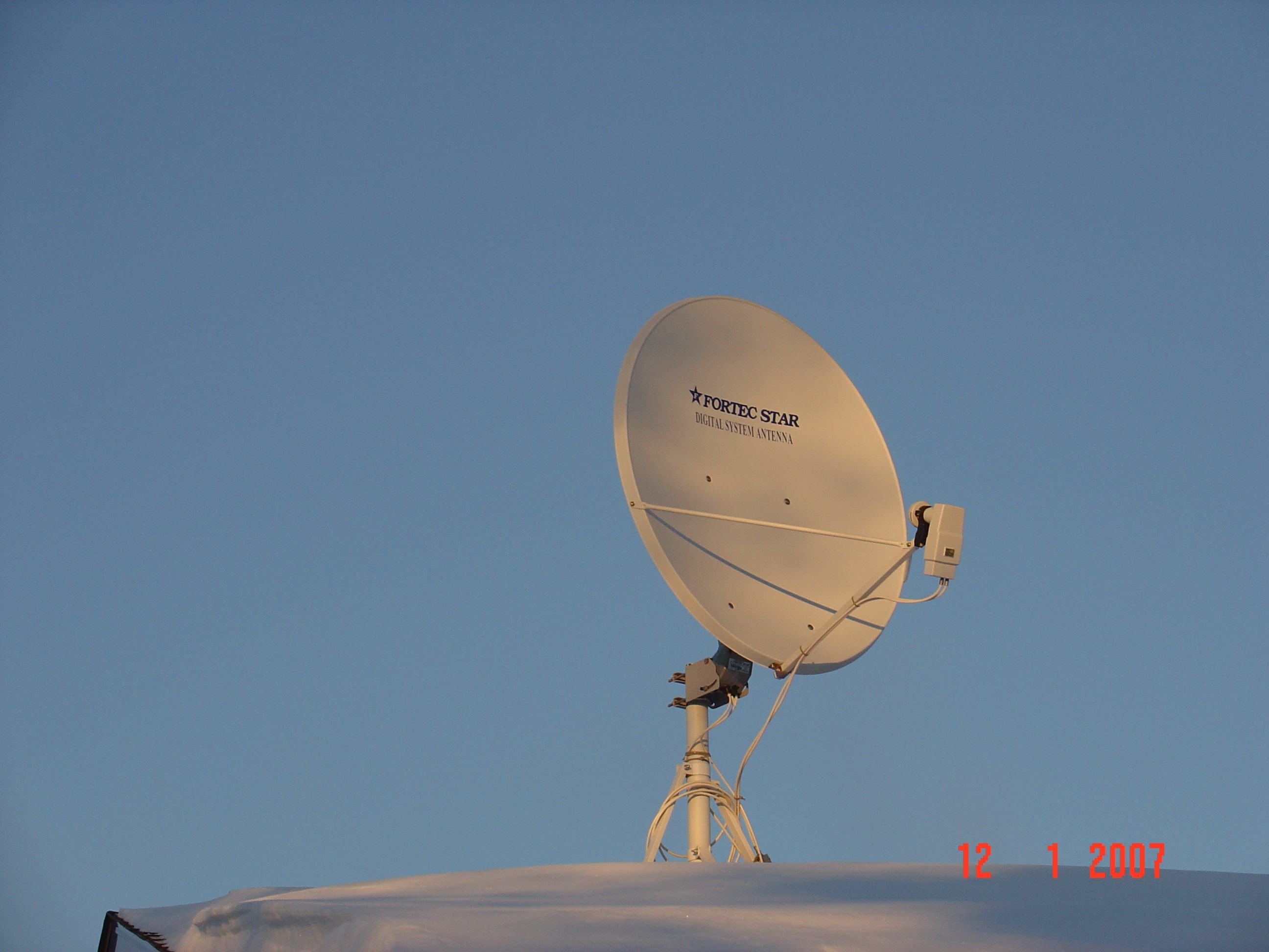

Hermitman, we used cedar fence posts tapered to the pitch in the roof to install the ground mount for the Fortec Dish on the roof. It was perfectly level in December. I'm hoping that the House didn't shift enough in the cold weather to cause leveling problems. But as you mentioned the only way to know for sure is to go up there which I'm not too keen to do right now. See posted pics when Dish was mounted in Dec and last week's pic in the snow.
