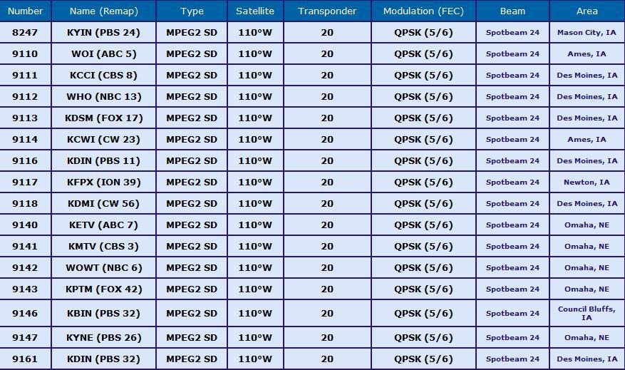

They're not wasting any bandwidth by mirroring it on multiple spots. All they are doing is plugging up a channel. IN the digital world they can use whatever SID (channel) they want.
Where my grandparents live (apt complex) there is a channel that shows the front entrance of the building (controlled entrance). It is on channel 6 if you do not have a cable box and 906 if you do. They dont upload it twice. Its just set on 2 channels
Here is a good example in the sat world. Some states have a state run PBS. Iowa is one of them. No matter where you live in Iowa you get the same PBS
Dish uplinks one channel of Iowa PBS. Depending on which market you are in, it shows on a different channel
If you look at the pic below, PBS shows on
8247
9116
9146
9161
Its not uplinked 4 times. Dish in their computer systems sends the output to SID (channel) 8247 if you live in Mason City, IA. It shows on 9146 if you live in Omaha/Council Bluffs etc
Its one of the advantages of digital. You can uplink it once and then send it out on 2 or 3 channels with no additional bandwidth.
From what you have mentioned above, it sounds like they SAVED bandwidth.
Old way...uplink 2 channels..ESPN SD & ESPN HD
New way...uplink just ESPN HD. When they send out the signal, send it out on 3 channels different ways
