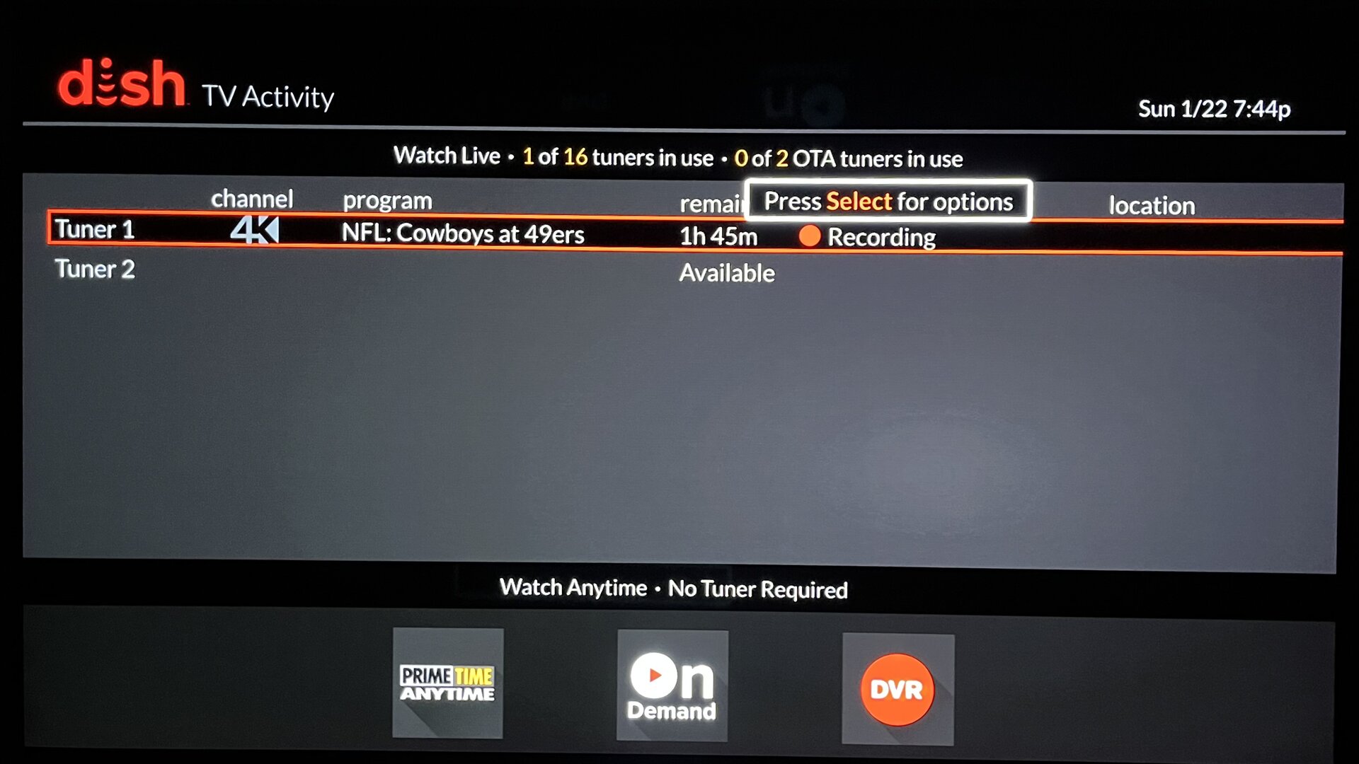

I have been using my iPad and the DishAnywhere App to record the 4K HDR event. While the event is recording, the Red button on the remote for my upstairs Joey 4K brings up the TV Activity pop-up and you can select the 4K event being recorded.

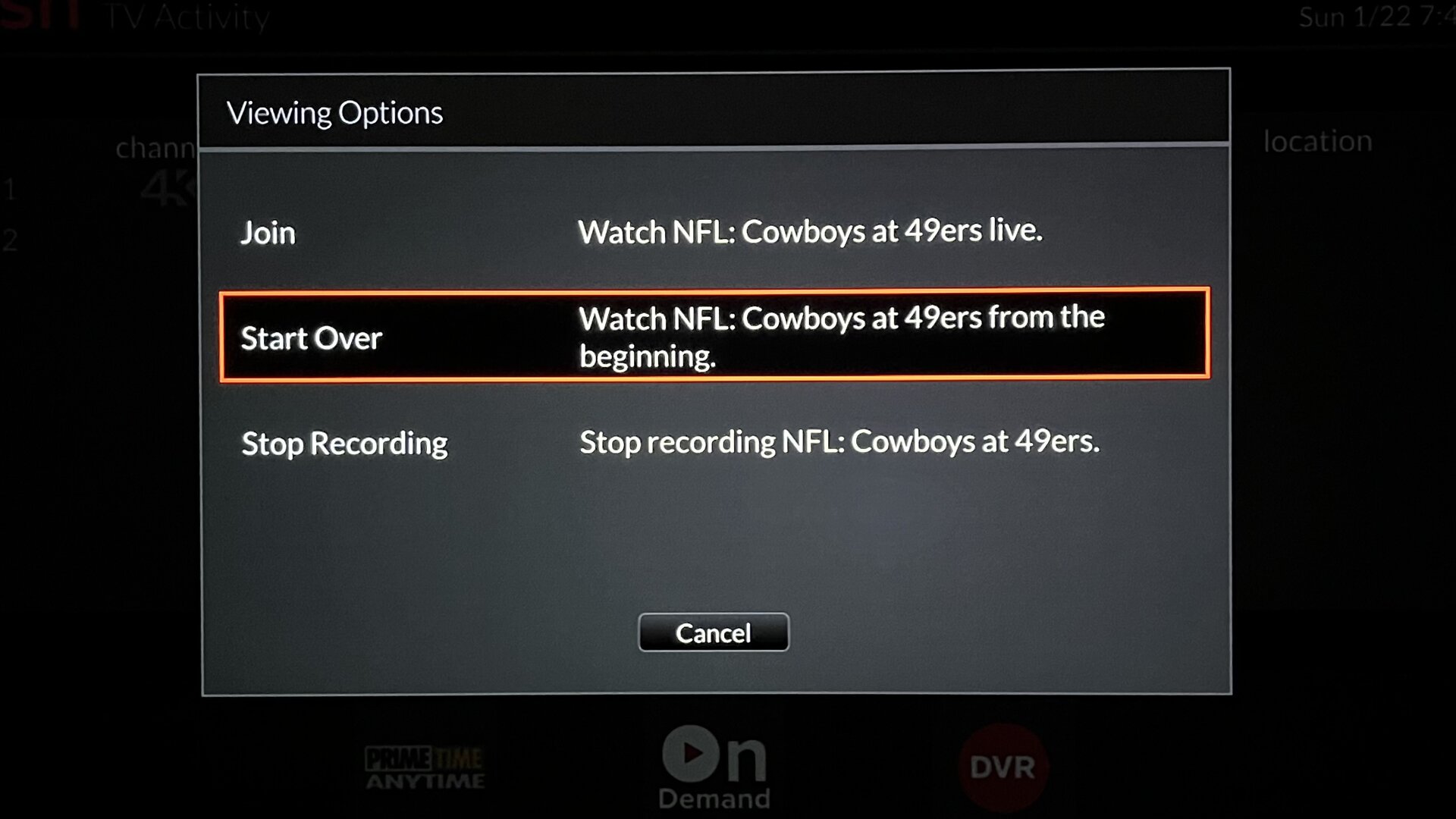

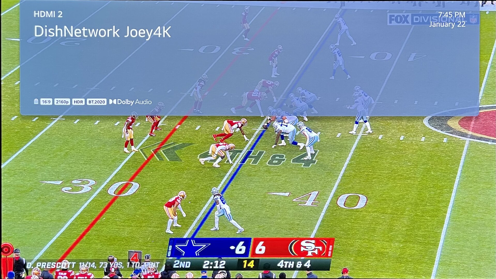

My Joey 4K's haven't had any issues viewing 540-01 4K HDR events with this setup. Even yesterday, the 49ers vs Cowboys game worked fine in 4K HDR.
This is on the original Joey 4K I got back in 2016, not the new Google OS-based Joey 4 that pairs with the Hopper Plus. My Hopper 3 and my Joey 4K are using the Jan 13 2023 Software (x33).
I recorded the 49ers vs Cowboys game on my Hopper and use the "Join the event" (tuner) and it work with no issue on my 4 K Joey

Scuttlebutt is that if you record a 4KHDR program on your Hopper3, you can play it on the Joey 4K.
So start the recording and go to your Joey 4K and begin playing it with only a slight delay.
