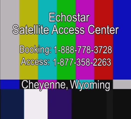

Jge
If you're on AMC 15, please scann TP 11928H SR 3979, and you should get 'Echostar Satellite Service' . This will confim which satellite you are on.
Jge
Good choice of a channel to test, Yurek. Just to show you what the channel looks like... See the attachment below. Remember, this is from sat 105W.
RADAR

Nice RADAR, I hope we will set Jge on it
Jge, if you get to AMC1, try TP 12100V SR 2000. It should yeld 'Pentagon Channel' This is quite strong TP.
