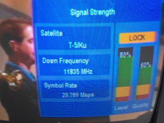

I'm getting a 60 on my Pansat with a 37x27 StarChoice dish (LNB is probably a .6 or .5). I'm in MN so as Mike noted, it may be location

hmmmmmmmmmmm, thanks for checking
I just don't understand why. Completely clear line of sight!
