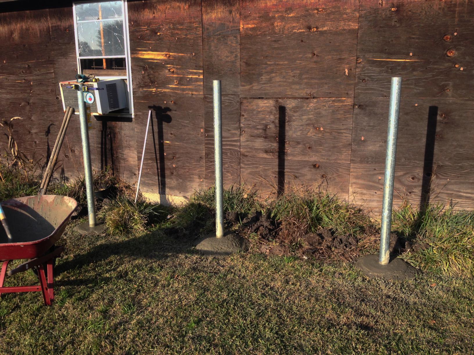

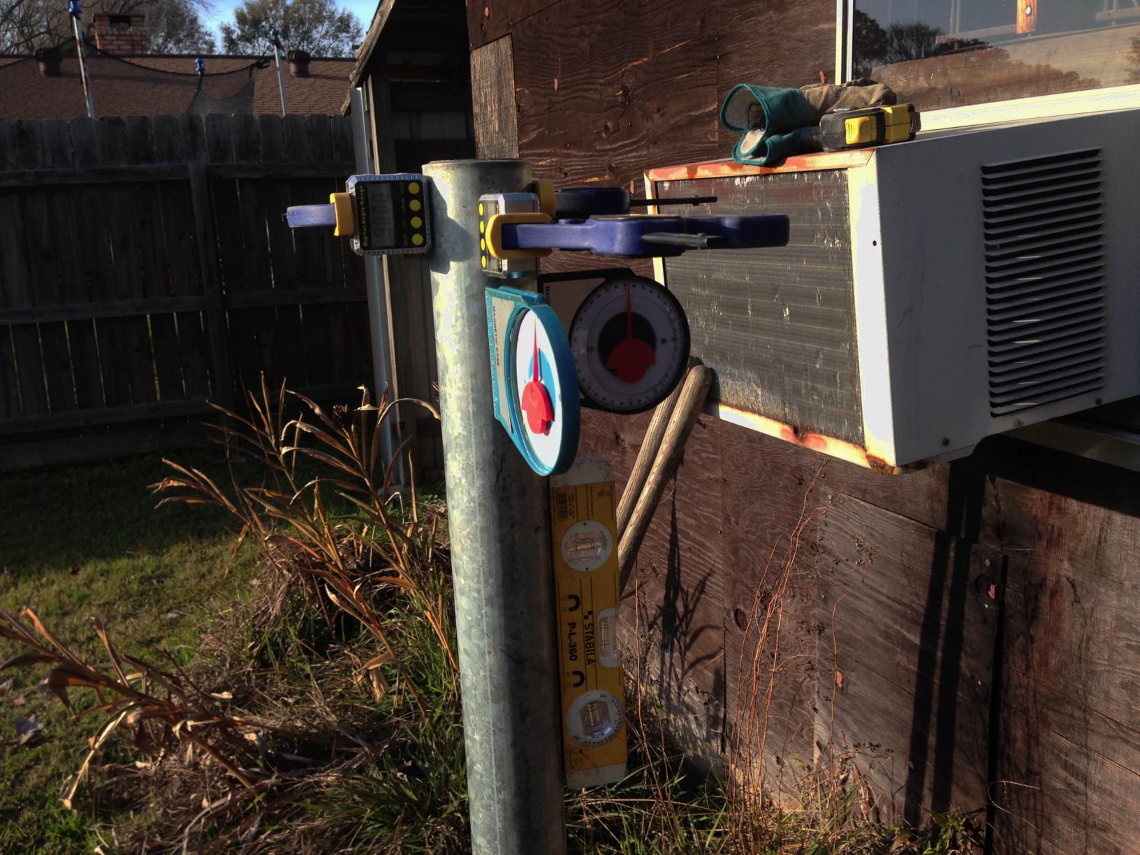

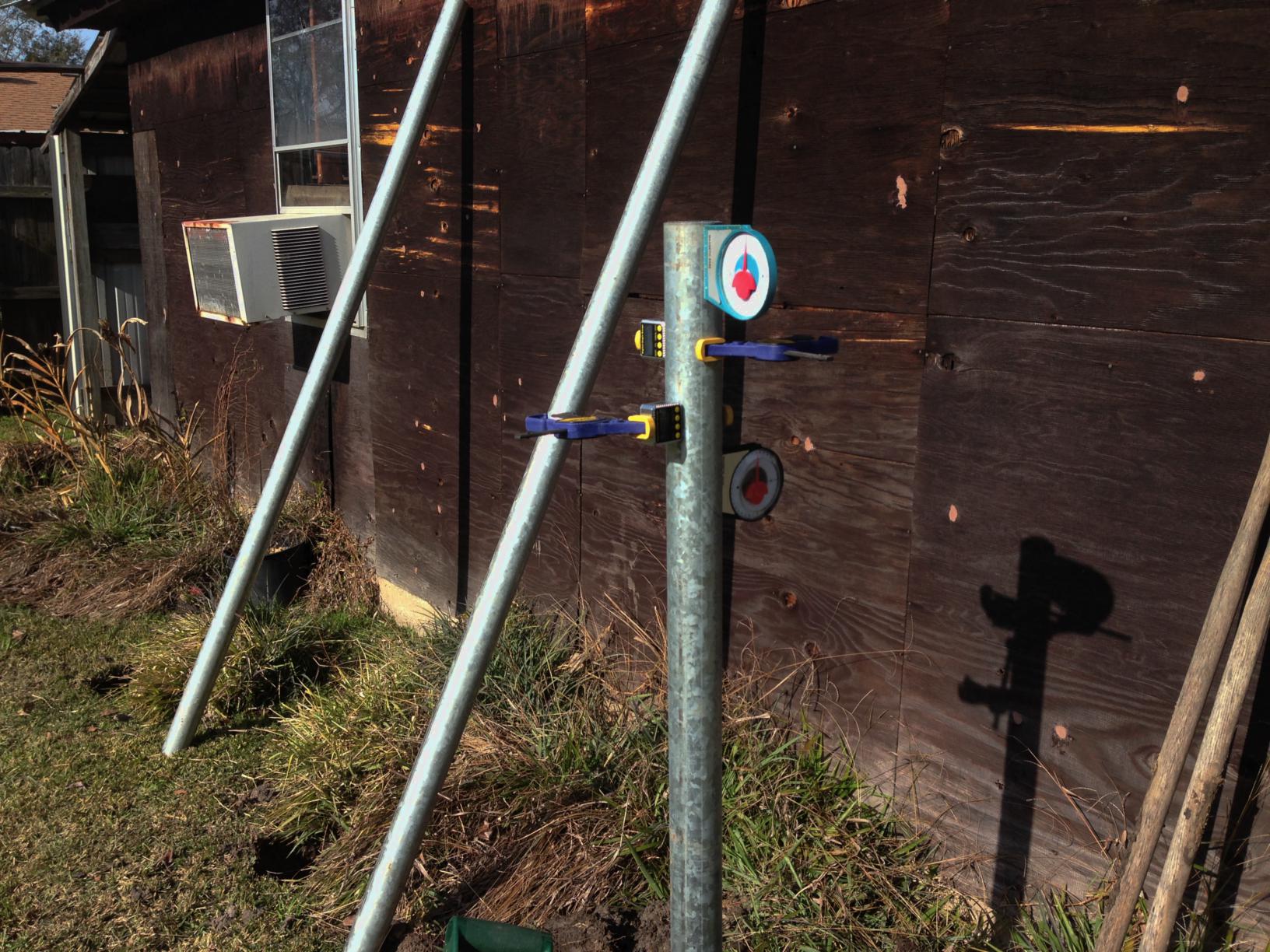

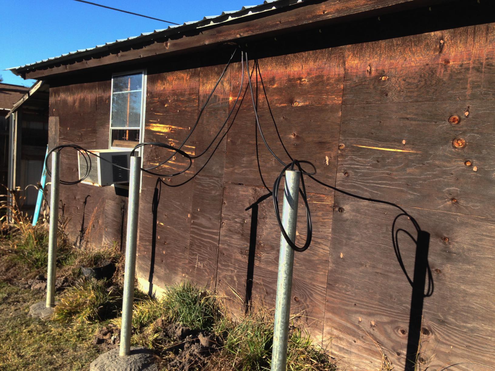

I also have to get the fence finished on the side where the FTA dishes go, when they were drilling holes in the ground for the fence they hit a gas line and made a HUGE leak that scared the whole neighborhood. That shut down everything for the day and my fence line had to get shifted over which I wasn't happy about.
At least we now know where everything is buried so I won't have to worry when I plant the poles for my FTA dishes. The smaller dishes are going three foot down, the 10' C-band and the 1.8m Prodelin are going SIX FEET IN, I want 5 feet above ground so I need two 11' x 4.5" poles.
Over the years I've suffered a lot of grief from my FTA adventures. Mostly because of poles not put in plumb and or put in not deep enough. For my subscription dishes I got three schedule 40, 3" by 8' galvanized poles. My dad drilled holes 18" from the bottom and put some painted rebarb through so they can not spin in the cement. I had the handyman drill three, three foot deep holes when he was drilling holes for my fence. I had to use a hand digger to make them bigger around so I could get LOTS of cement in.
I mixed up cement till it was like crunchy peanut butter, nice and thick and well mixed so there was no dry stuff in it. I dropped the poles in and I clamped TWO digital inclinometers to the pole at 45 degrees from each other PLUS I stuck some of those needle type inclinometers and a bubble level to the poles and I set them to be PERFECTLY PLUMB. Absolutely dead on, 90 degrees plumb. Each one. Once I got them plumb I just backed off and rested awhile to let the cement set up a little, after about half an hour I checked them again and they were still dead on perfect so I very carefully removed all the levels and meters without disturbing the poles.
Today I went and ran RG-11 end to end and tacked it up properly along the eves of the garage (Yes, it's ugly, it's getting new siding soon). With my very excellent meter I expect that I'll get excellent performance from my dishes and that they will be indestructible and trouble free.
This is exactly the same way I am going to do my FTA dishes. I am taking my time and remembering all my past mistakes and griefs and doing it RIGHT this time. Also I this time I get the luxury of planning out where they go. The mish mash of randomly placed dishes here at my old house are not entirely my doing, my ex started that mess. I just went with it because I didn't know any better. Now I do.

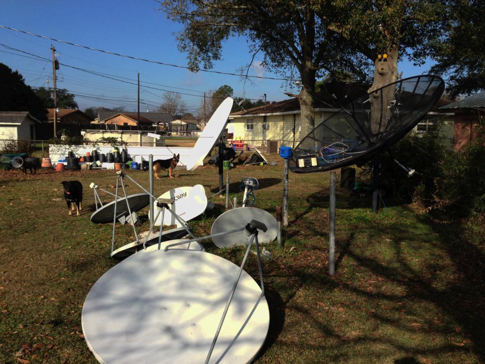

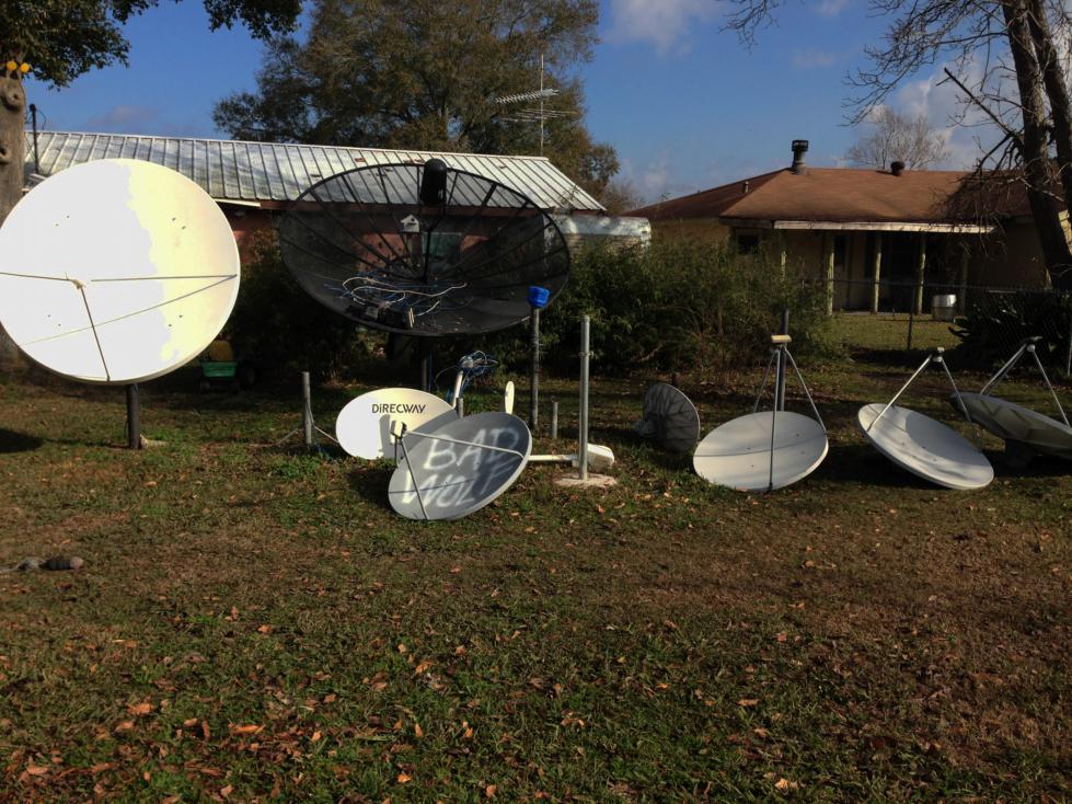

Well, here we go! I thought I would never see this day!
Truck is on the way this afternoon to take them to their new home. Gonna get the big ones another day as I don't have poles planted for them just yet.

I've done something similar. If you look at my pics above, I use two 1m and one 1.2m dishes for 110/119/129 with all RG-11. I have zero rain fade. It's not an issue. I watch TV in the worst of weather. So far I've only had rain fade happen two times and it was coming down so hard that you couldn't see to drive a car. I only lost signal for about 5 minutes each time as it moved through.
If I could put up three 1.8m dishes for Dish Network, you better believe that I would. Matter of fact, I probably will if I can ever lay hands on three 1.8 Prodelins. (I have one now but it's going to be a mini-bud.)
That is my FTA, HH motorized dish which I need to plant on the side of the house in the FTA farm. It's just leaned up against the garage for now. I figure it will be a few weeks before I get my FTA dishes moved and put up here.
Getting my C-band dishes over here are going to be a nightmare. I have to take the 10' dish completely apart. There is no way I'm going to try to move it whole. It's only about 6 miles but the roads are packed with idiots.

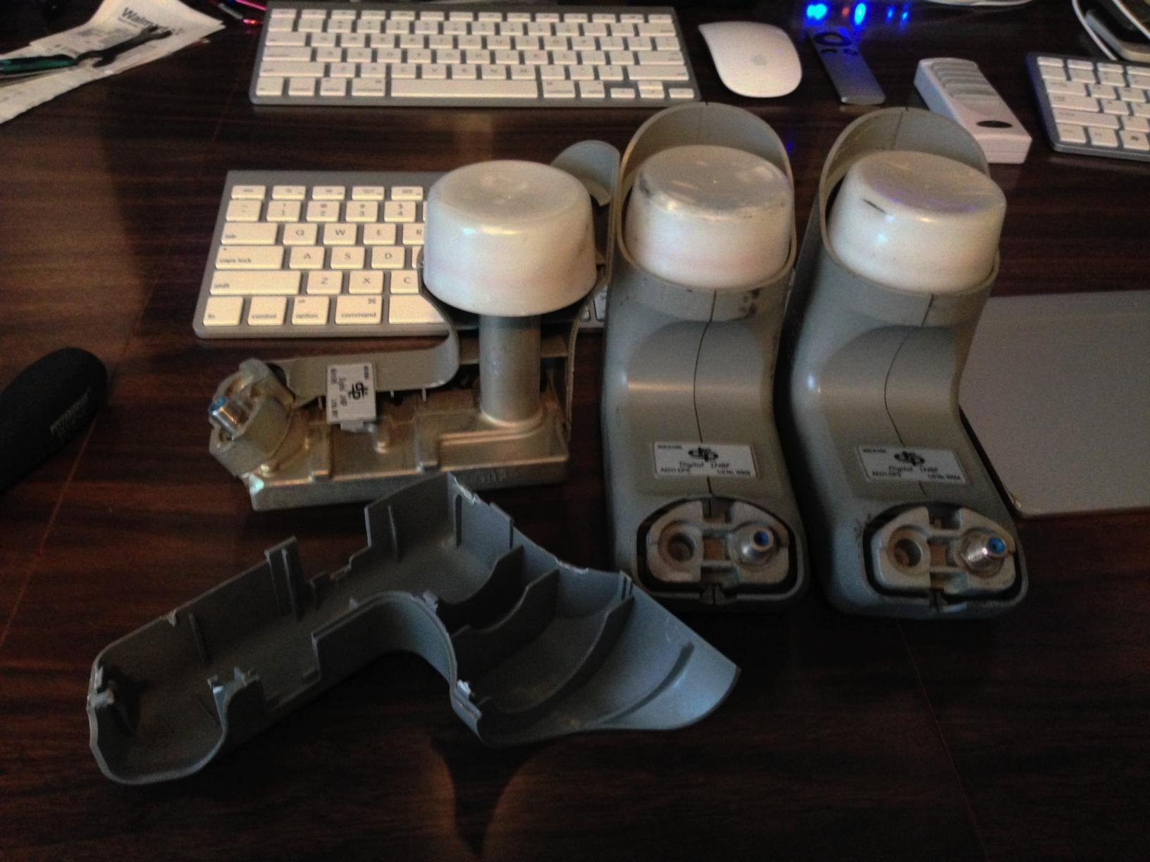

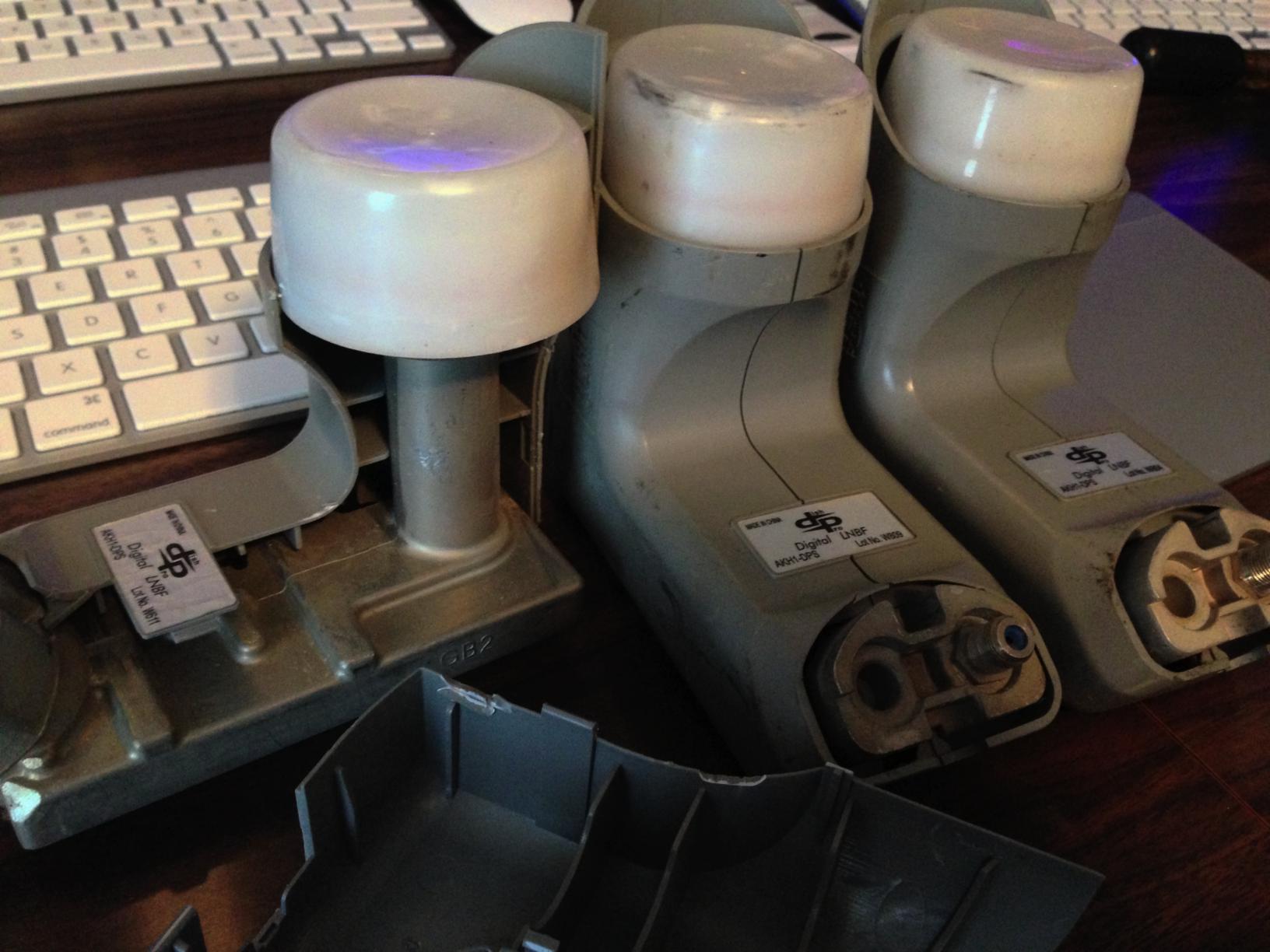

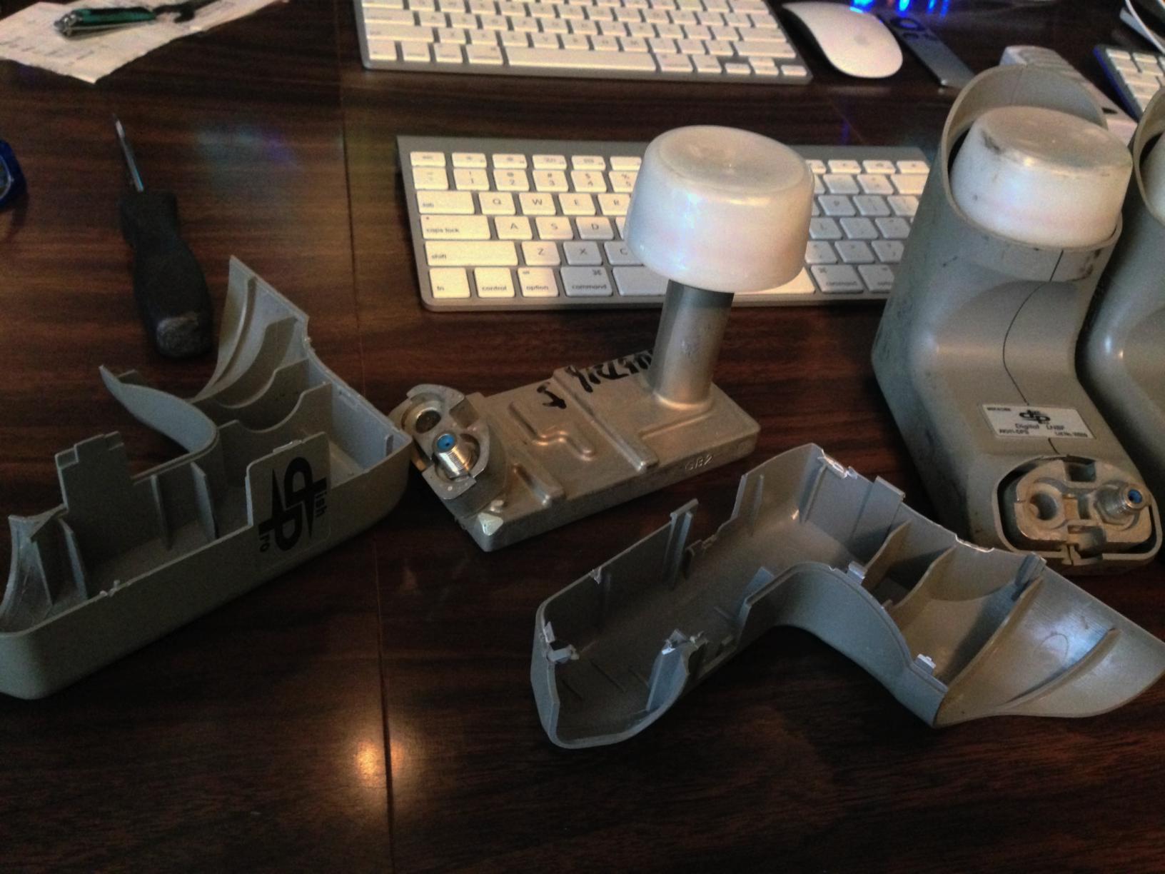

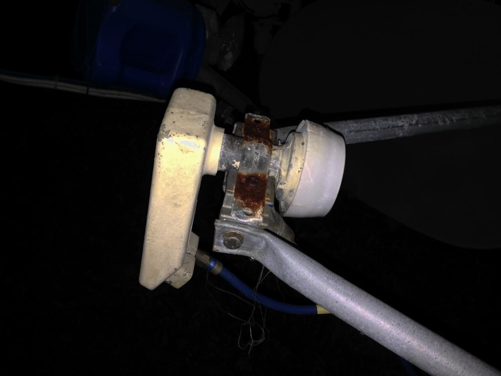

Take off the plastic housing and you will probably find a feedhorn throat that is approximately 23mm. :)
This is an old Directv LNBF. I took the cover off and found the smaller neck inside. I cut the plastic so the cover shields the main part with the electronics from the sun.
I found that Dish types are pretty much the same thing, a big, fat plastic shell with a little skinny metal tube inside.
I'm hoping that the Dish Pro singles I need to buy will be the same. All I have seen the inside of is really ancient stuff.

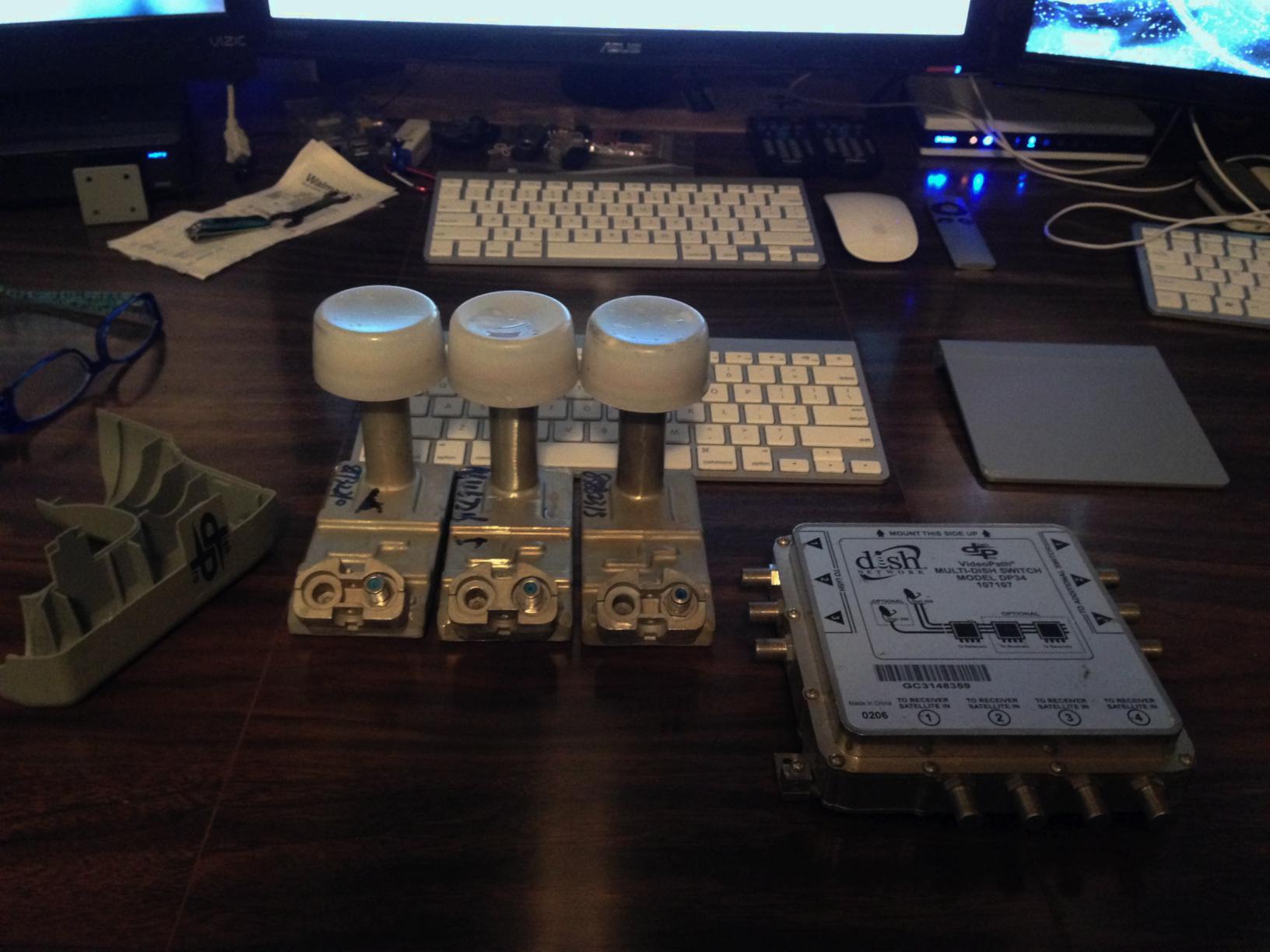

Got me three DP LNBF's in the mail today.
I popped the covers off with a screw driver and find that the necks are 23mm in diameter.
I'll have no problem adapting them into my existing Primestar/Andrew/Prodelin dishes..
They will replace old Dish legacy 300 and Directv LNBFs so I can connect them to my DP34 which will feed two ViP211k receivers.
