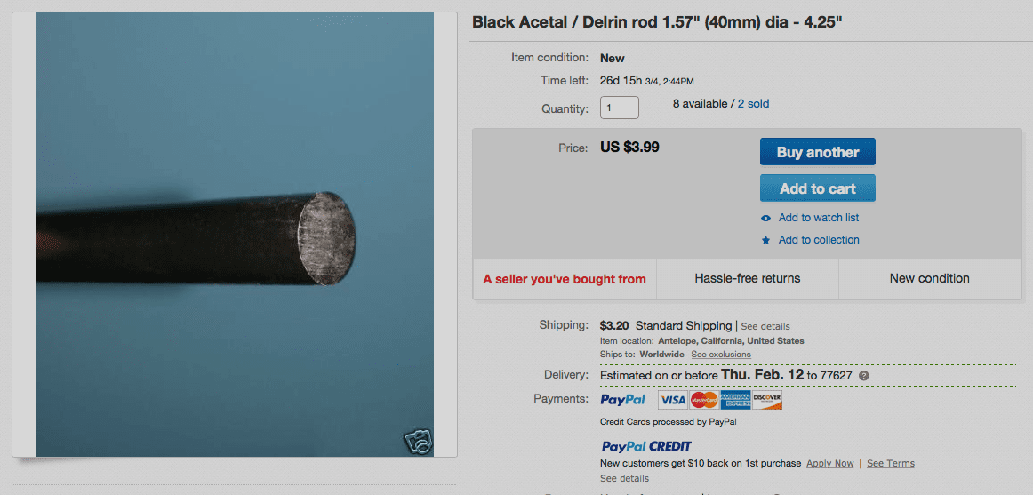

I just bought two of these, enough to make four adapters. It's already 40mm diameter so that's half the work already.
Now I just need to get my dad to drill a 23mm hole through the center, cut them to 50mm length then cut down the center into two halves.
Bingo! LNBF adapters !!
Actually I'm thinking I could make them 25mm long instead of 50mm and still work just as well and give me twice as many adapters. :D

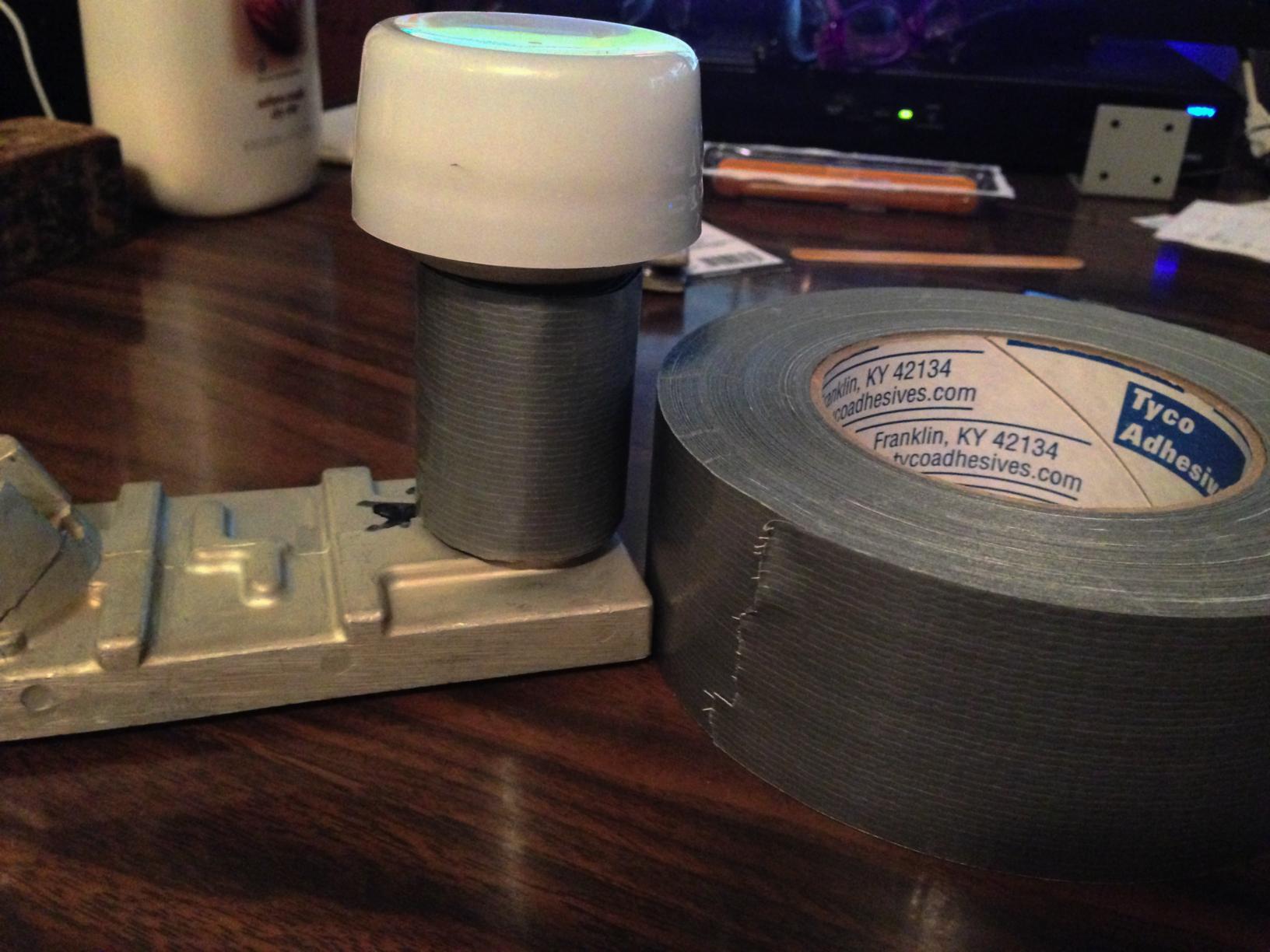

I have three legacy type LNBFs installed now, one using some sort of tubing clamp I found in the junk pile in my old garage and the other two, I just wrapped enough duct tape around them until they would fit the 40mm clamps.
One dish is perfectly fine dropping a 23mm neck into it, it's a 1 minute job. The other two are designed to take 40mm necks so that's what I'm wanting to make the adapters for rather than the duct tape like before.
Until my dad can make the adapters for me (plus I still have a week before they even get here in the mail) I'm just going to duct tape the necks so they fit. That will be fine for a week or two.
After the adapters are done I can cut the tape off and put the adapters on them.

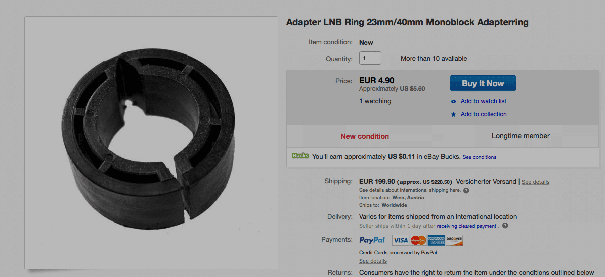

Have thrown thousands of the unused 40mm to 23mm adapters away through the years. These came standard with many dishes and universal KU-band LNBF clamps to adapt the standard 40mm opening down to the 23mm throats. Most FTA dish resellers probably have many of these laying around.

OH NO!!!!! I had no idea that anyone ever made such a thing! I guess I should have looked on ebay rather than try to reinvent the wheel?
Hmmmph! Like this.....
Dang it!!
Oh well, as always, I leap before I look.
Oh wait! $200+ shipping from Austria. Ok, so I did ok after all.
All the universal lnb clamps I have came with 40mm to 30mm adapters or else I would send you a few. Sorry.
LOL!! I have bought all sorts of adapters over the past few years and I never got one of these things with anything. I didn't even know such things existed until last night.

Oh well, now that I've already bought those plastic rods I get to reinvent the wheel just because I have to learn another lesson the hard way.

Well until I get my adapters made, this will have to suffice as a temporary 23 --> 40mm adapter.
(it's how I've been using the old LNBF's for the past two years.)

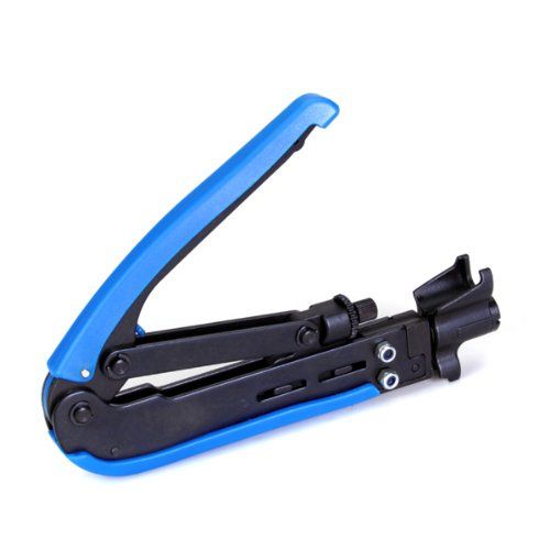

Oh goodness no, they are very different. I had to buy a whole new set of tools as well as new connectors.
But whatever you do, don't buy a compression tool like this one.
It's rubbish! It will not compress where the gap is so you get this distorted fitting that looks like a little kids bottom lip when you tell them "No more candy!"
I've had a compression tool that looks just like this one for years and haven't had any issues. (Amazon has it, search for Monoprice 103357) It is adjustable so you can dial in the amount of compression applied. Maybe you are over-compressing or using quad cable with non-quad connectors? Try dialing back the adjusting screw a bit. Maybe it's the specific brand of connector you're using?
