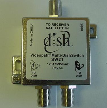

Here's a picture of the SW21, it connects to sats to one receiver.. this is usable by all dish boxes as far as I know..

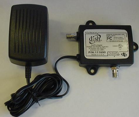

Legacy recievers can not use DishPro equipment unless you use a dishpro legacy addapter, picture included :)
At worst if he sells you a dishpro twin you can simple just connect one coax to the other and call it a day..
