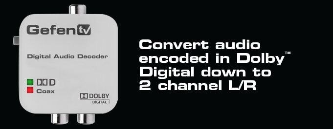

You may also want to try Gefen GTV-DD-2-AA Digital-to-Analog Audio Converter that supports AC3 5.1 Dolby Digital In, converting it to Stereo Out. Its more expensive, but gives a higher quality sound. Sonic Voom is long discontinued, so harry, if you want to buy one from Amazon. :)
that's a good one!
$129 vs $20... that's why we recommend the Sonic Voom (or whatever name it currently goes by) - :cool:
