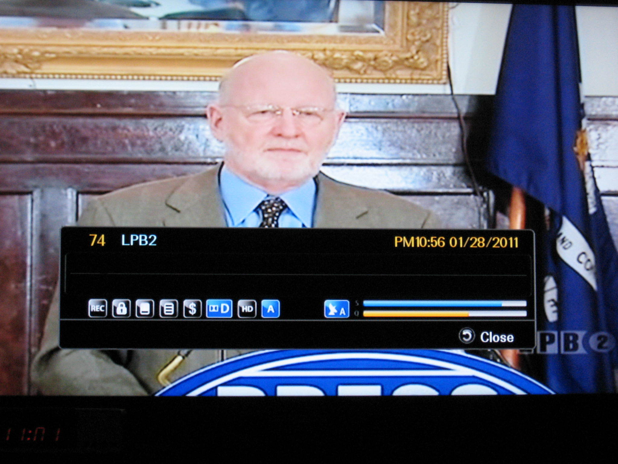

Again!! its doable with a 6 footer heres a pic and while its snowing outside tonight! 12068 h 12473 AMC21 ku
