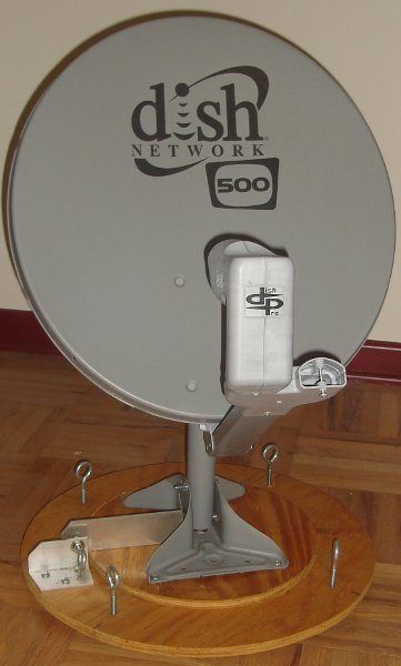

Hi, you could use other dishes if you where to run a check switch each time you switched the receiver from one dish to another. Not really much trouble but it does take a little time to run. You may be able to get by with something as simple as a Dish 500 with the single LNB (common and used as a wing dish) provided all the channels you will want to watch are on one satellite. Do some research then hit the info button twice on the receiver and see what satellite is being used. If everything you want is on the same satellite you would be good to go. Another cheap options might be the Dish 500 with the dual LNB and set it up for 110, 119 or 119,129 Hope this helps, DC
It doesn't seem like the spread between the LNBs would be right (9 degrees vs 11.2 degrees)...
Hi, regarding using a Dish 500 with DPPlus dual LNB you are correct, the spread is not correct for use with 61.5,72.7 but it still works because it is close enough. There will be some signal loss and you would have to split the difference but it will work at least in good weather. BTW - you don't need no stinking tripod. Just get a piece of plywood and mount the dish and some blind nuts with eye bolts for levelling. The micro azimuth on the dish in the picture was for FTA experiments and is not needed with the stronger Dish satellites. Later, DC
