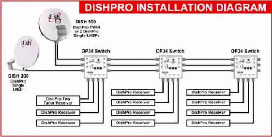

What model numbers are the receivers? If they are newer (3100, 5200, 9200 etc) get a DishPro Twin LNB and 2 DP34 switches
The DP Twin would use 2 lines from the LNB (one for 91 and one to 82) to the DP34 switch. It has 4 outputs BUT you can cascade another DP34 onto that for 8 outputs
here is a Pic. Disregard the 3rd satellite slot.

he wouldnt need a different dish. Just a new LNB and switches
you could do 2 SW44's but then you need to put high frequency splitters on all 4 ports on the LNB. You cant cascade them
If they are 3100's I would highly recommend going dish pro. Much easier to deal with :)
DP34 is your solution!
Take Iceberg's word ofr it. He's right on the spot!
"The DP Twin would use 2 lines from the LNB (one for 91 and one to 82) to the DP34 switch. It has 4 outputs BUT you can cascade another DP34 onto that for 8 outputs" quote & quote

correct on the number of lines. DishPro uses bandstacked technology where it takes the H polarity and "stacks" it above the V side which means you only need one cable per satellite slot. So 2 lines from the LNB to the DP34 switch.
