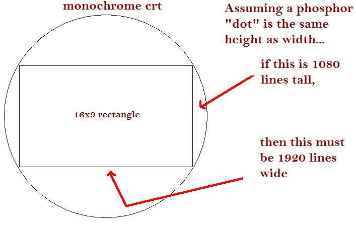

I got to thinking. The three tubes in my TV are circular. Given that the cathode ray is the same width as its height, if the TV truly has 1080 lines of "height" in 16x9 mode, the math says it HAS to have 1920 lines of "width." (1080/9*16=1920) - the attachment shows my logic in coming to this conclusion.
This is all theoretical of course, I have yet to find any specs that tell me what the "dot pitch" is of the CRTs. Assuming again that the dot pitch is sufficient for true 1080 height at 16x9, it would appear to be sufficient for 1920 width.
Whatever the true resolution of my TV is, it appears to my eyes to have a sharper picture (except for convergence errors near the edges) than any of the LCD or plasma displays I have seen except for the newest 1920x1080p digital displays.
