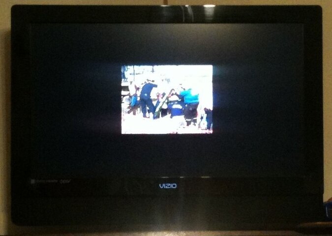

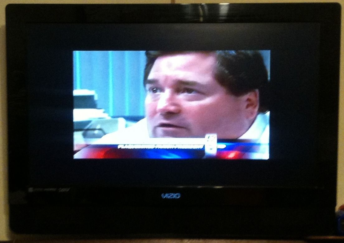

This is what I'm talking about, when I am watching ANY video, be it local via the antenna or satellite.
So called HDTV from the local TV stations is about 1/2 what it should be. And things like RTV are the size of postage stamps on the screen.
I have gone through ALL the settings on the my theater app and none of them are worth two cents.
For each and every time I change channels I have to use the zoom option of my theater (hold left mouse button and roll wheel) to get the picture a little bigger but NONE of them ever, ever fill the screen. And some of settings are horrible, it's like a BAD fisheye effect that makes me physically ill to watch, like I have to throw up.
I can however use VLC to watch a movie or recording from disk and it will always fill the entire screen as it should.
Now, I have a splitter for the TV antenna, one goes to the pc tuner and one goes directly into the TV. When I put the TV in TV mode and tune local stations, they almost always fill the entire screen.
So I know it's not the TV at fault and it's not the pc (VLC fills the screen).
So I've come to the conclusion that the my theater app blows. It's very limited and it fails totally to provide a good picture.
So my question is, what can replace it and deal with the fact that I have two tuner cards, one satellite and one TV?
Thanks! :)
Oh, attached pictures are samples of what I have to put up with. The first picture that shows a wide rectangle, that's been zoomed as much as it will go. The huge border is permanent and if I "zoom" that video it begins to crop the sides off. :mad:
The second picture with the small box, that one can be zoomed to at most twice the size shown but it still falls far short of filling the screen. :mad:
Also, when I say "border" I'm talking about "dead screen" area, not the black plastic thing around the outside edges. I'm talking about LCD pixels that ~can~ but do NOT light up with pictures. :mad:

there is a menu in mytheatre to change the scaling. i think its f12 that brings it up. if not its f10. it gives you video rendering options. you can force the output to 1080 and it will autozoom.

im not sure my instructions were that good. for mytheatre video options.
right click on video -> settings -> general settings
select ivr / osd and enable ivr with monitor resolution
AND
select allow directx video acceleration
exit that menu
press f12 -> set video src mode to force 16:9
-> select render format -> set to whichever works for you
-> set Video / Osd AA filter for your video cards performance.
this should scale the video and fill your screen.
crackt out,.
