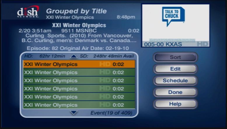

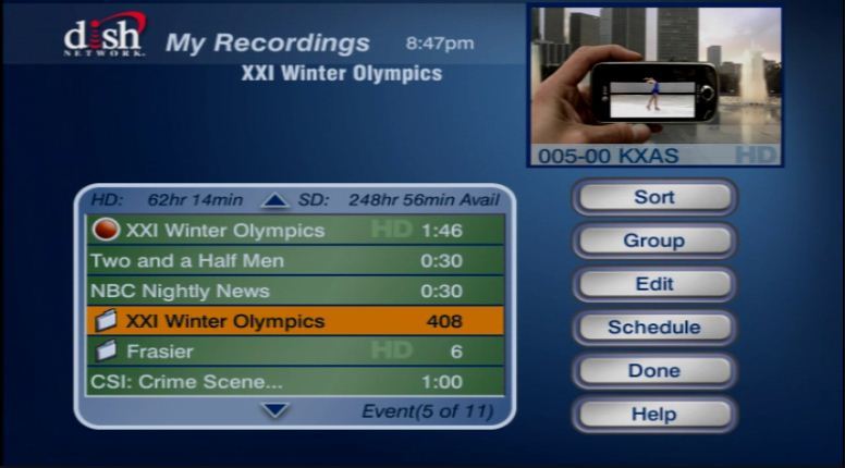

I have a 722 and a 211k with an EHD. Both of them do the same thing. Sometimes, for no reason at all, instead of 1 30 minutes (or whatever length the program is), it will record 30 or more 1 minute segments of the program. Currently the record is from the 2010 Olhympics. You can see the number of records that it made this afternoon. Does anyone have any idea what causes this? How can I make it stop? My first 722 did it. The replacement they sent me does it and both 211ks do it too.

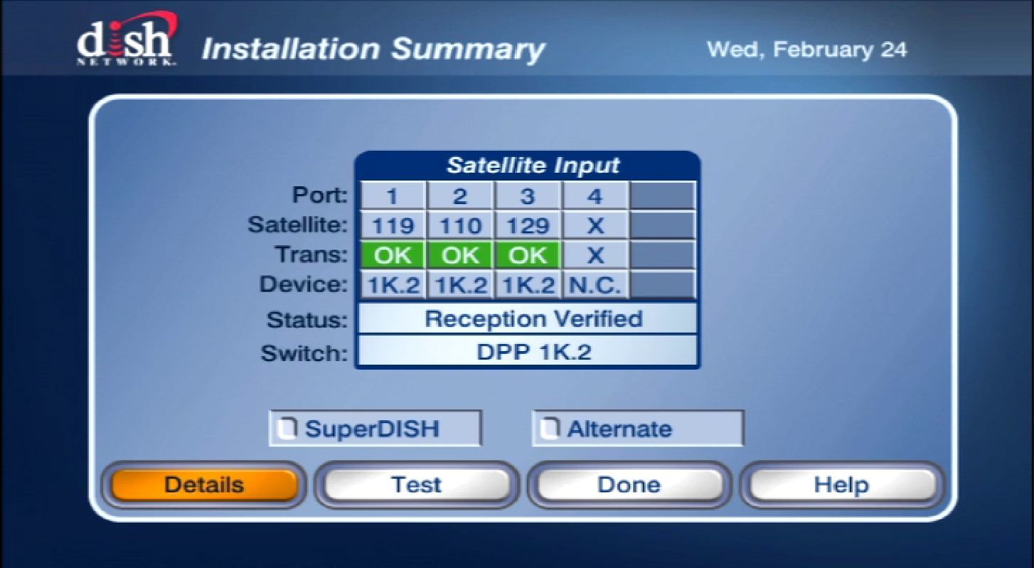

I am hitting 3 satellites. Here are the numbers and signal strengths from the 211k
129 - signal strength 60
110 - signal strength 64
119 - signal strength 64
I have a DPP 1K.2 (which I assume is the switch).
I am located just north of Dallas, TX so I am assuming that icicles are not the problem. There are no trees in my line of sight either. Do these numbers look good or should I have better signal strength?

Congratulations. You should have no problem with locals reading better than say 80 and will work to the 60s although with any multi-path no amount may work. They do need to be higher than satellite numbers. Don't know why.
-Ken
So . . .
Do my satellite signal strengths support or rule out a weak signal explanation?
