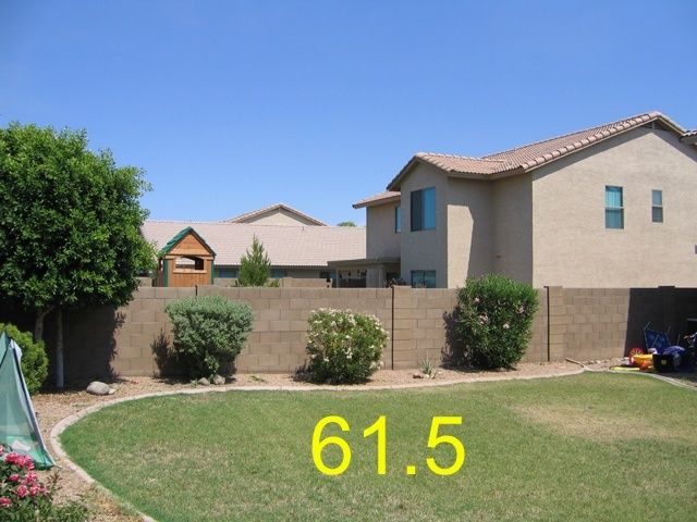

Here's a quote from another thread, so you might stand a chance:
Success! I've locked 43W from my back yard (8.7° elevation!).
It looks like he's using a 75E primestar for that.
Oh, and Ice must've been in a hurry, that's...
" 273 azimuth is pretty much straight WEST "
...for us in north America.
If it's any encouragement... attached is what that 43W / low elevation's LOS looks like for me. 43W is pretty much where the roofs of the 2nd and 3rd house back intersect.
The yards are 62' wide. Luckily my immediate neighbor is well clear of my LOS - that was a free 62'. I then figured half of that to the next house was 93' or so. Worst case scenario with my dish on the property line I'm at 13' 9". Go half way back in my yard, call it 124' and I'm just shy of 19'. If I'm back to the furthest 3rd of my yard (about where my motorized dish is) I'm bettering 20'.
Add to that my 5' or so pole on the non-pen mount and the beam is a solid 25' in the air, easily over my obstacle (2nd house back).
