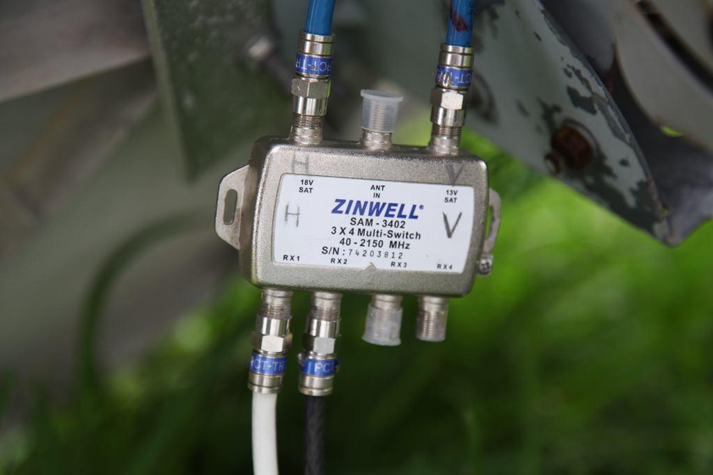

I got confused (as usual) about hooking up a 3x4 switch..
I knew that the H & V go to either the 18v or the 13v. Or maybe the other way around.
I tried to google it and found a flood of nonsense I couldn't wade through.
I also found a section in here about switches but I found the part about the 3x4 switches to be, a bit unclear or uncertain, for me. My brain didn't seem to grasp it.
Anyway, I took a best guess at it and it SEEMED to work. I put the H/V LNB on my motorized dish then I put the 3x4 on it to combine them into one wire for my MicroHD.
I went back inside and I had TV again on the MicroHD. Cool beans…
So yesterday evening I decided to see if I could also tap it off into my PC so I ran a wire from a port on the 3x4 over to a spare port on the 1x8 feeding my PC.
I check the MHD and it was fine. Then I add 83w to the PC, setup the LO and the port of the 1x8 it is on and hit scan. Nothing.. :(
I scanned like 8 times and nothing. Bah.. So I quit the PC and went back to watching Dish Network nonsense the rest of the night.
Later on when I went to bed I wanted to watch the MHD but to my dismay, there was still no signal, AGAIN, on it. Arrrrrrrgh!!!!!!!!
I gave up and again watched Dish..
Then today I was outside getting ready for some really bad weather that is headed our way and I decided I wanted to try once again to get it working on two systems.
I went outside and put my meter on the 3x4 and PBJ came right in just fine. I went inside and tried scanning on the PC again and still nothing..
On the MHD I had now lost ALL ku channels. Nothing was working except C-band.
I went back outside and found there was now no signal going to my meter.
Back inside and more scanning and still nothing. Then I changed channels on the PC and watched OTA on it while I contemplated this stupidness.
All of a sudden I heard the TV in my bedroom blaring a cartoon. I go in and check and the signal is there and strong.
So I try again and nothing on the PC. I go back outside and again there's no signal on the meter.
Back inside and there's again nothing at all on ku.
Then I thought about flipping the polarity on the PC. I set it to 11735/4440 and VERTICAL and BAM! It scanned it.
I check the MHD and it's still working too.
What I don't understand it why the MHD which is set to 11735/4440 HORIZONTAL works fine but the PC has to be set to vertical? I changed nothing at all on the MHD and it works until I try to set the PC to work the same way!
When I set the PC to V and the MHD to H, both work fine at the same time.
What am I doing wrong? I assume I have the wires backwards between the LNB and the 3x4 but if that's so, why does the MHD work but not the PC?
I set them up as Horizontal to 18v and Vertical to 13v..
For now I have the polarity on the PC set wrong, to vertical. It's raining and tomorrow and Saturday it's supposed to flood so I won't be able to mess with it for 4-5 days, maybe more if it's as bad as they say.
Is there any potential damage I could do with things wired like this? Should I not use it for now?
?Thanks… :o

Ok, now it's getting really weird. Yesterday it was working, today it's not, again.. :(
I give up on trying to get it to feed two systems. I'll just wait until next week when I can order a few new LNB's and Ecoda switches so I can start over with the right things.
I think I've just got too much junk here that I'm trying to use and it's just frustrating me. Out with the old, in with the new..
Vertical is 13V, horizontal is 18V.
Hmmmmm…. Well WTH?? I would appear that I have it connected right. UNLESS I switched the wires backwards, I guess that's possible. But it's raining and muddy out and I'm not messing with it tonight.

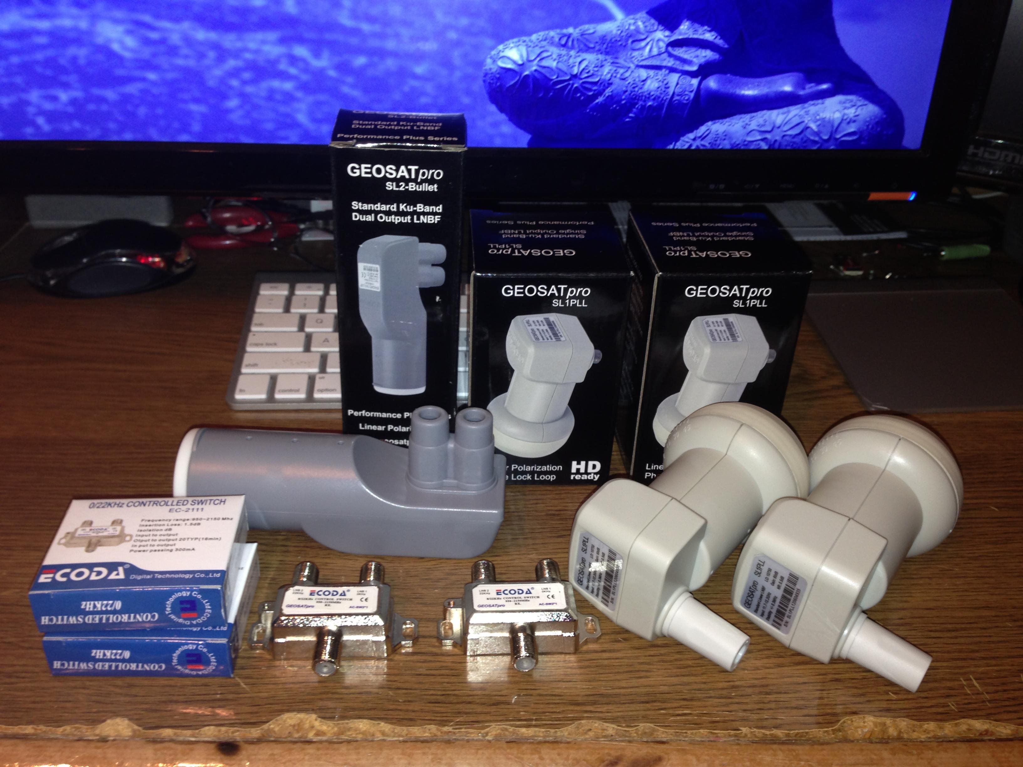

So, I got a little cash advance and I went ahead and purchased some new stuff from one of the other SGUS members here.. :D
I bought two new Ecoda 22khz switches. One to use now and one as a spare.
I bought two new SL1PLL LNBF's. One for me, one for my dad. I'm going to put them on my motorized ku dish and on my dad's motorized ku dish. Both of our dishes are finicky and Dad has trouble with PBS sometimes and RTV. As do I. I'm hoping this will help both of us.
I bought one new SL2 dual bullet. I'm going to set up a dedicated, fixed dish for 83w and put this LNBF on it and then feed it to both my systems with a 3x4 which I already have two of.
I'm tired of the nonsense, tired of the troubles so I'm just gonna do it right.

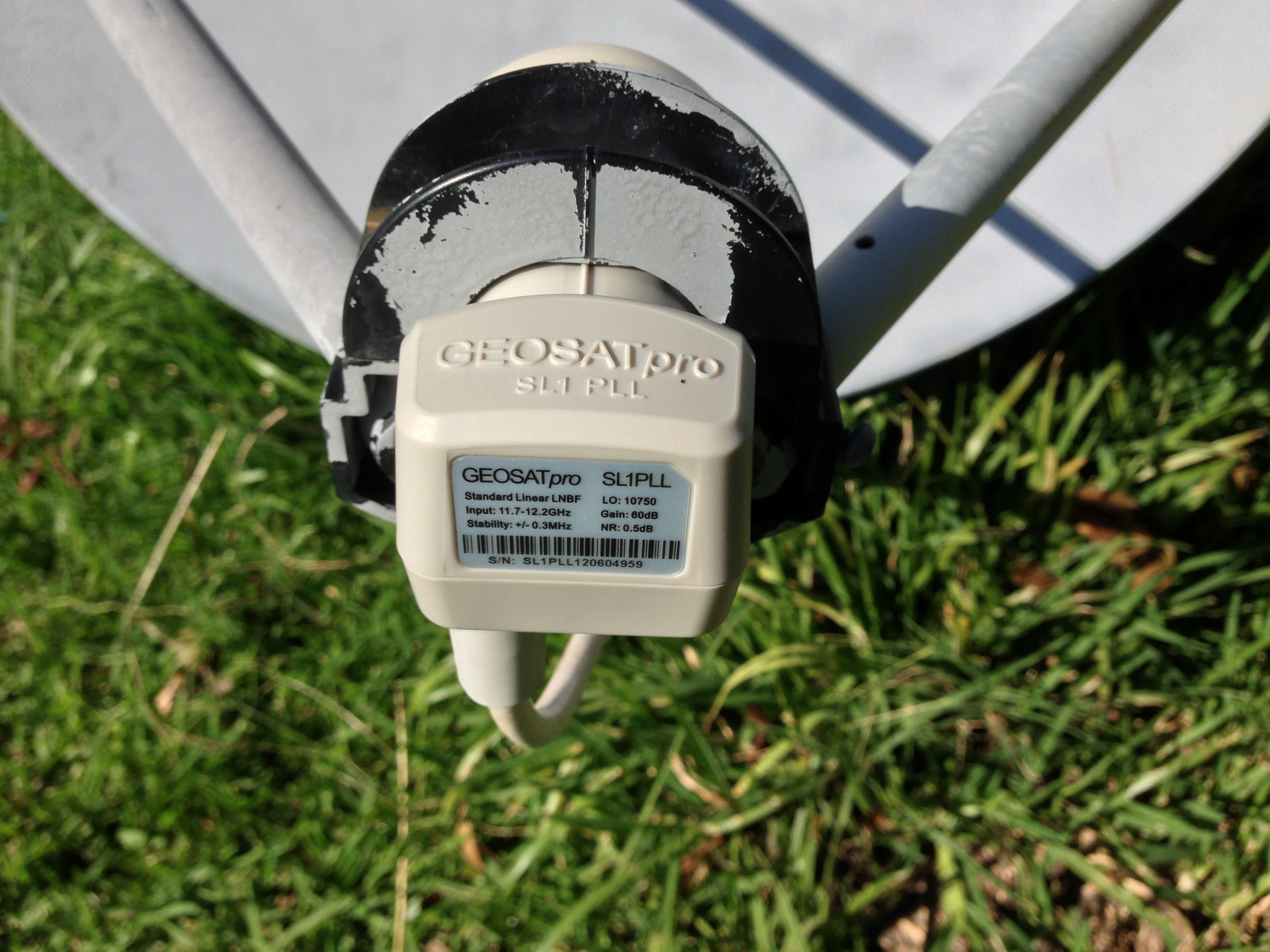

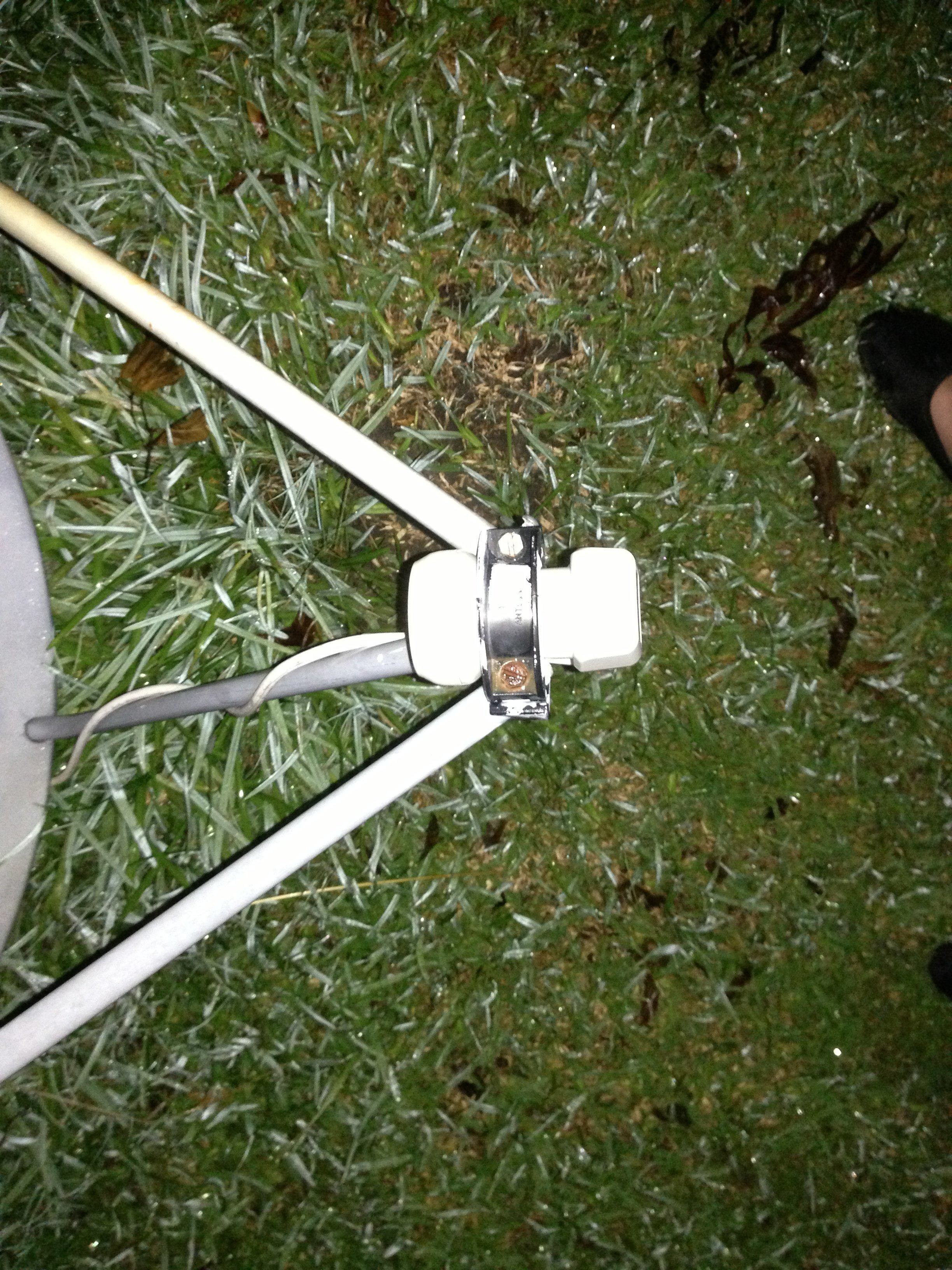

So I got my new LNBF's and 22khz switches in yesterday.
I changed out the old Primestar LNBF for one of the PLL type.

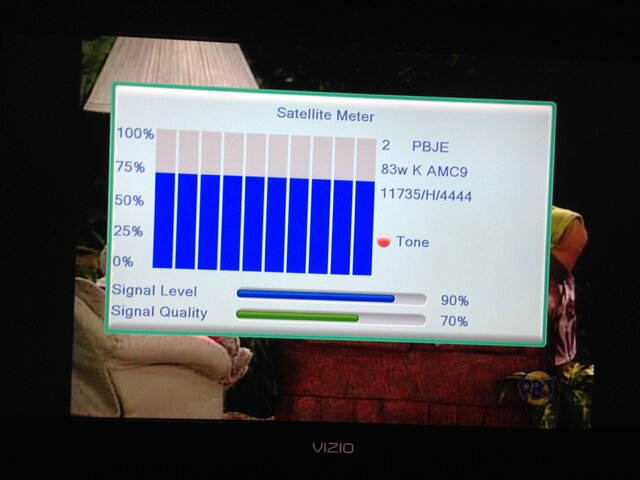

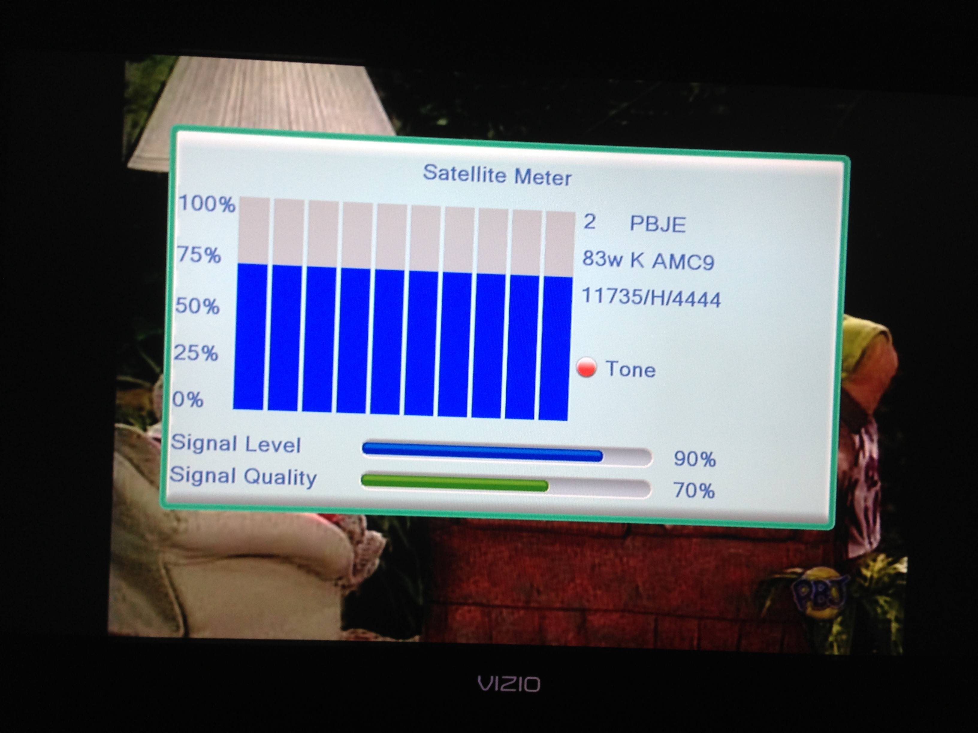

I can't really tell any difference with it over the old type but on the MicroHD signal meter, the little bars hold steady. Before they would "dance", I guess the signal was fluctuating before. The levels are the same, 90/70 but I guess more steady.
Should I be able to get a better signal? I have a clear LOS and the dish is a one meter Primestar/Andrew. I don't have a lot of confidence in the post however. On that note, I checked to see how much a 2 1/2" electrical pipe is and they are flippin $89 !!!!!! WUT????? Nope….. Ok, plan B. I need to go shopping for a very heavy fence pole. Or, just take one that I have already (it's light and thin, very cheap.) and stuff another thin pole down inside it and fill both of them up with cement. Arrrrgh!
Anyway…

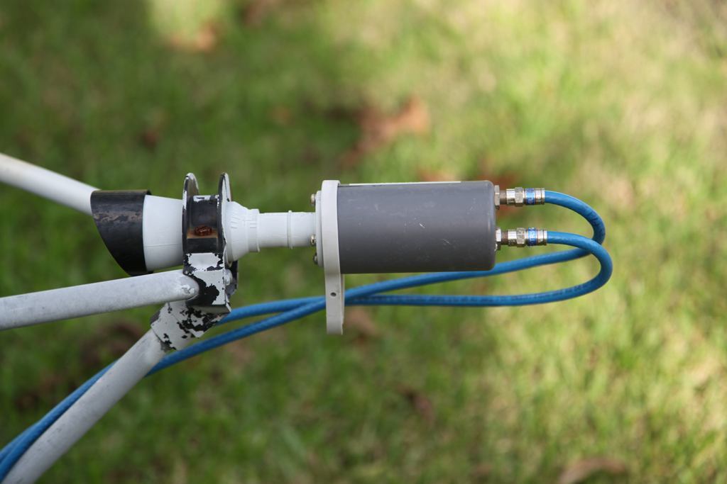

So on this PLL thing. Are there any special considerations I need to take into account? Any special settings I should set in the tuner for it? I assumed the settings are the same as any other LNBF but there's that terrible "assume" problem I have.
Also, another problem I don't know what to do about is where do I position it? The neck of it can slide backwards or forwards in the Primestar clamp by a good bit. I'm sure that that can affect reception, just like light doesn't focus in the right part of my eye anymore and I have to wear glasses, I assume the signal has to focus on the little antenna inside the LNBF and if it's not positioned properly, well, wouldn't that mess with it?
The last picture didn't come out very well, I used my iPhone in the dark, what I was trying to show is how much the thing can be moved in the clamp.
Another issue that baffles me, for some reason I just seem to find pretty much nothing past 97w. It moves as it scans but most of the satellites to the west of 97 seem to be mostly dead.
I really doubt that they are. One of them, like 103w, scans in and shows channels like the two beach cams and the NBC channels but despite that, it just says "No signal" on all of them.
I've always had problems seeing past 97w with this dish and I can't figure out why.
The LOS on it is clear all the way over to 129w but I don't try to push it past 125. But between 99 and 125, it's a wasteland. Something weird is going on and this new LNBF, I would think it would pick up the weak stuff, right?

The PLL LNBs do not need any special settings. They are a direct plug and play replacement. You probably won't notice any big change if you are already receiving strong signals. The PLL really shines on small dishes and weak signals.
Going past 97w there is not much to view till you hit 125w.
101w has the pentagon channels and a couple others
103W has the beach cams. Then a bunch of channels such as COZI TV which requires the LNB to be skewed in the opposite direction to detect them. This skew is an odd ball situation and you can do a search on it to learn more. Also some of the other channels are news feeds and not always live. Thats why you get the "no signal" on most channels. Having to go out and re-skew the LNB for just 1 sat is a pain in the butt especially if the dish is on a motor.
Oh, 125w has loads of PBS channels and some other ones. This is a great sat if you enjoy a variety of PBS type programming.
The way the receiver is designed with out getting technical, 70 is a great signal. It would be about the same as 96 on other receivers.
I can vouch for what ke4est says. I recently connected my Shaw Direct dish to my microHD. This dish delivers a 98% or 99% signal to my Shaw Direct receiver. MicroHD received a signal of 71% with this dish connected. I have never seen higher than a 74% signal from any satellite when using my FTA dish and microHD.
I also agree with Jorgek. My experience is PLL design seems to stabilize received signals and also enhance low signal qualities. It made little difference to signals already being received strongly.
And don't worry too much about 103W and its funky skew. This issue will disappear when the new SES3 (already in place) becomes operational replacing AMC1 in the coming months. No more skewy problems soon.
AH HA!!! Ok then! :D This answers a lot of questions that have been messing with my head.
Chances are that everything is just fine then.
