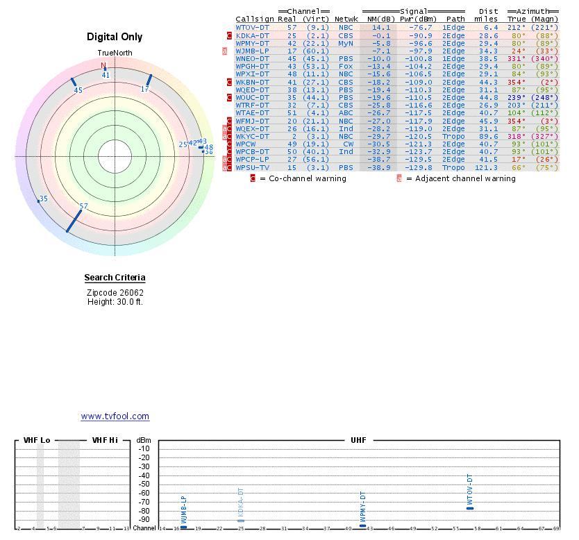

so what kind of antenna do i need for ALL the digital channels? I don't want a big monstrosity on my roof.
My farthest station is 50 miles and it ranges from 3 degrees to 220 degrees whatever that means.

ok so the first antenna won't work with 2-7 so that's not good. I need one that will work with 2-69 at least 40 miles and doesn't look ugly on my roof. I already have a extra mount on my roof so that helps there but it's on an angle so those huge antennas are out of the question.
Because it helps everyone to know your location details and its topography to help choose a correct antenna and have it aimed correctly; you cant just throw anything up anywhere and have it work.
