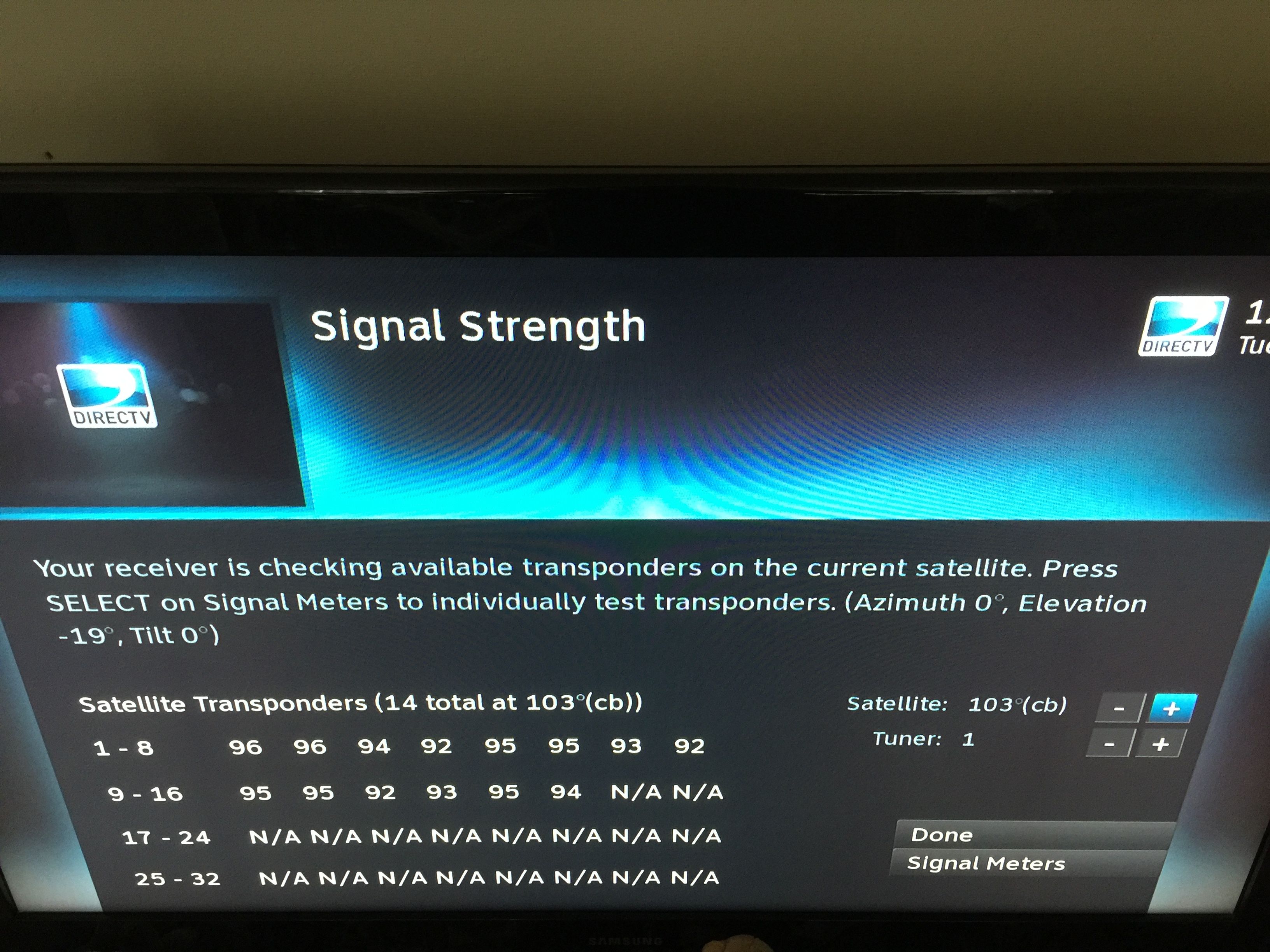

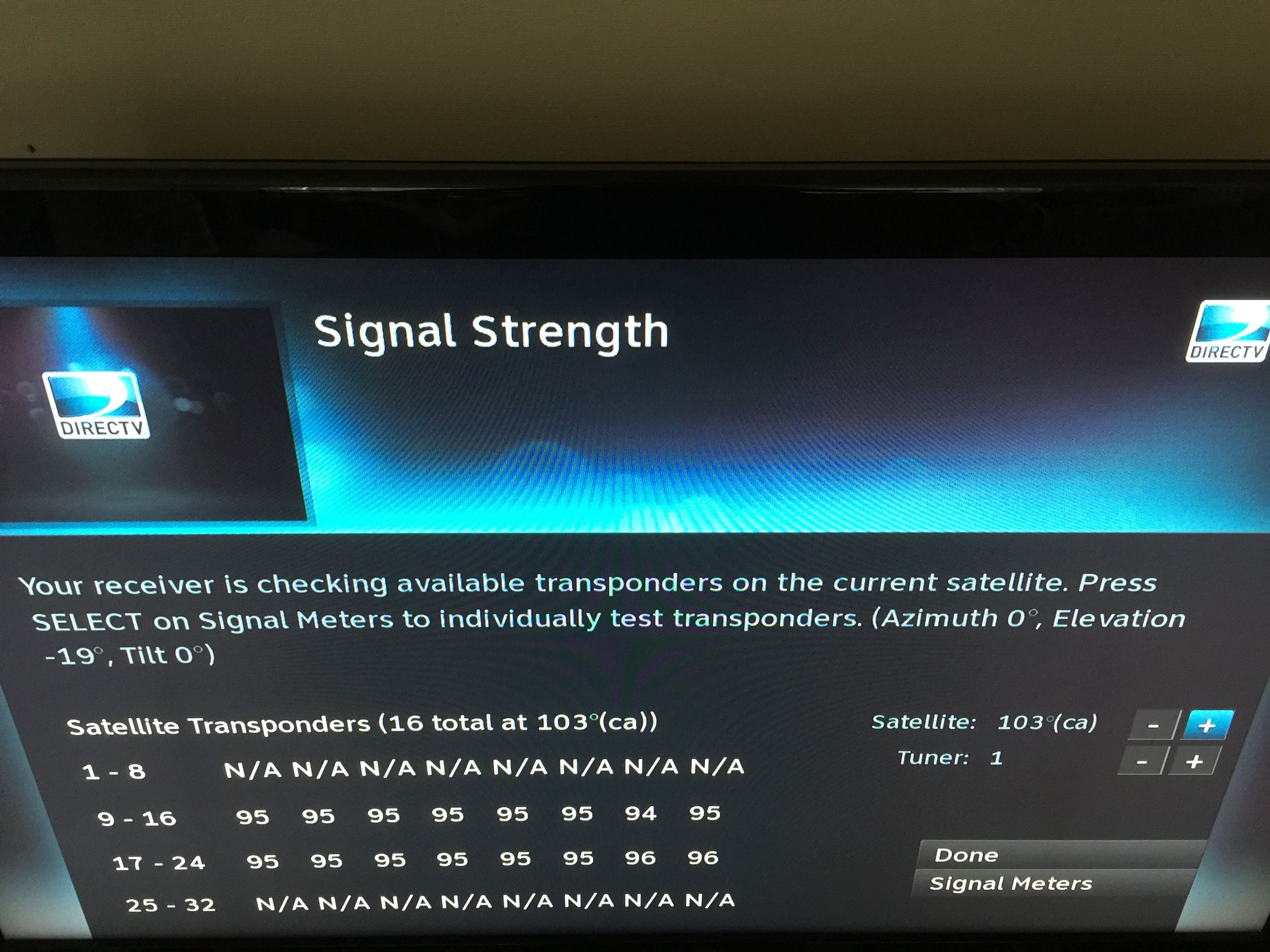

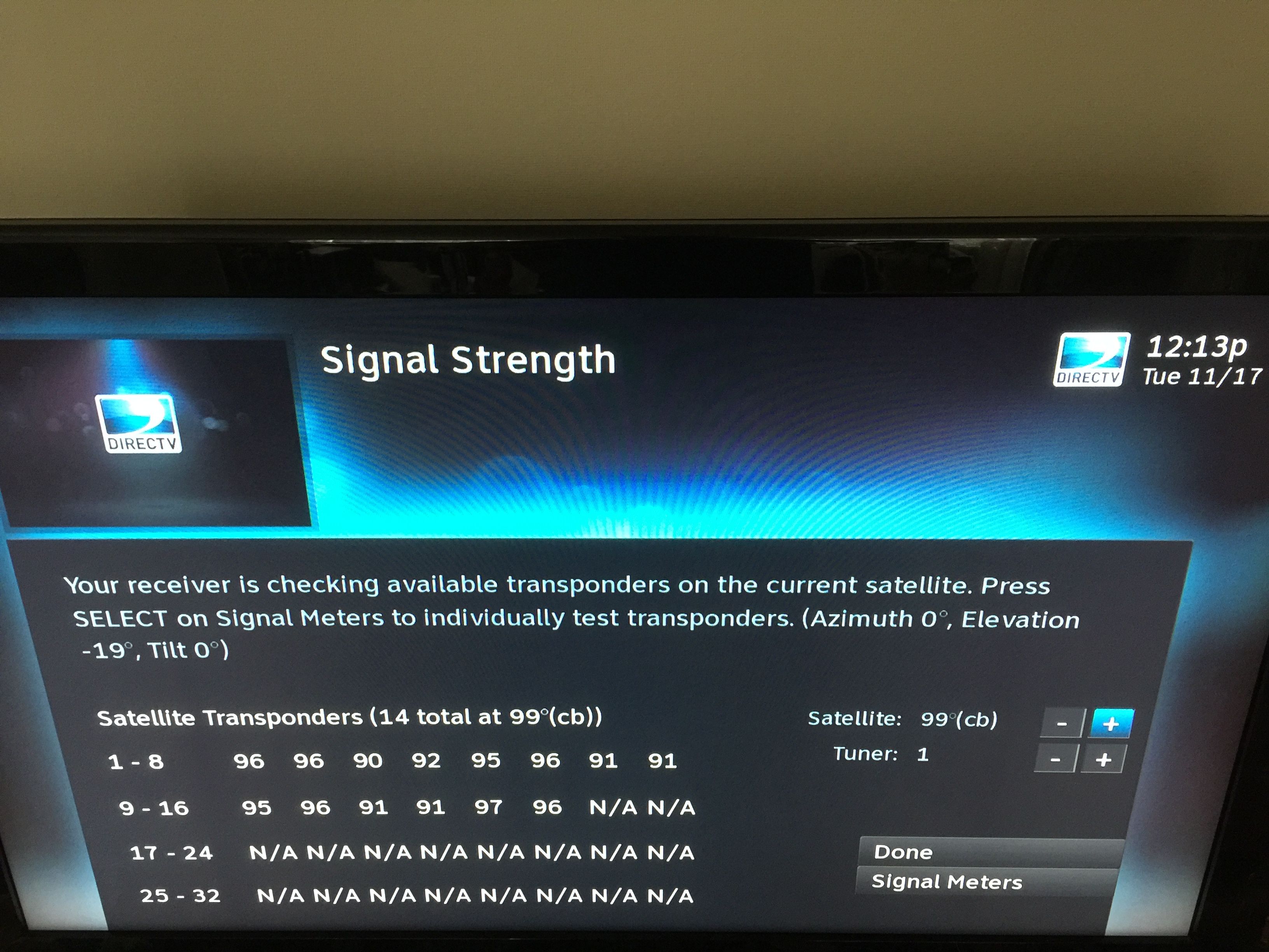

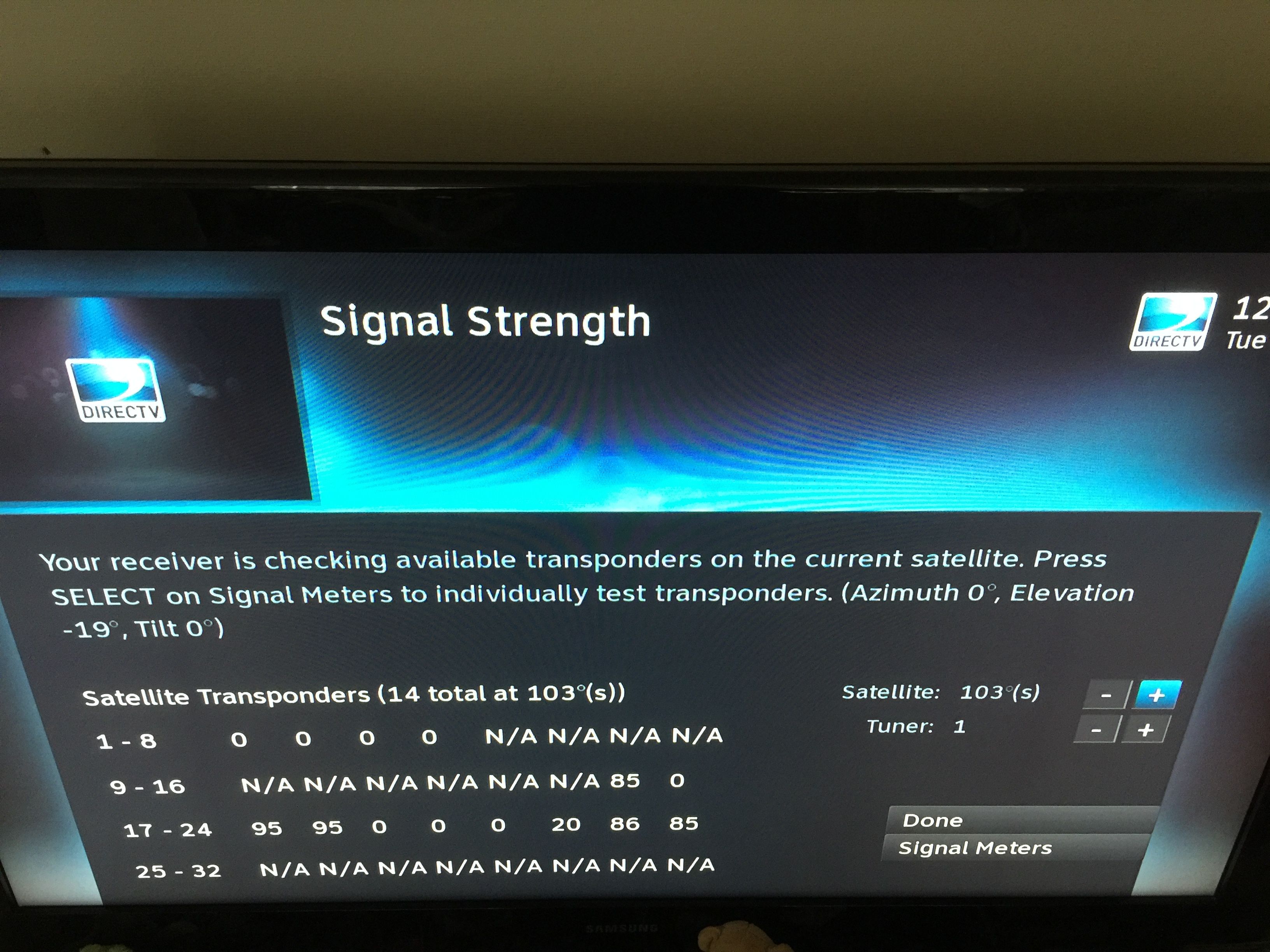

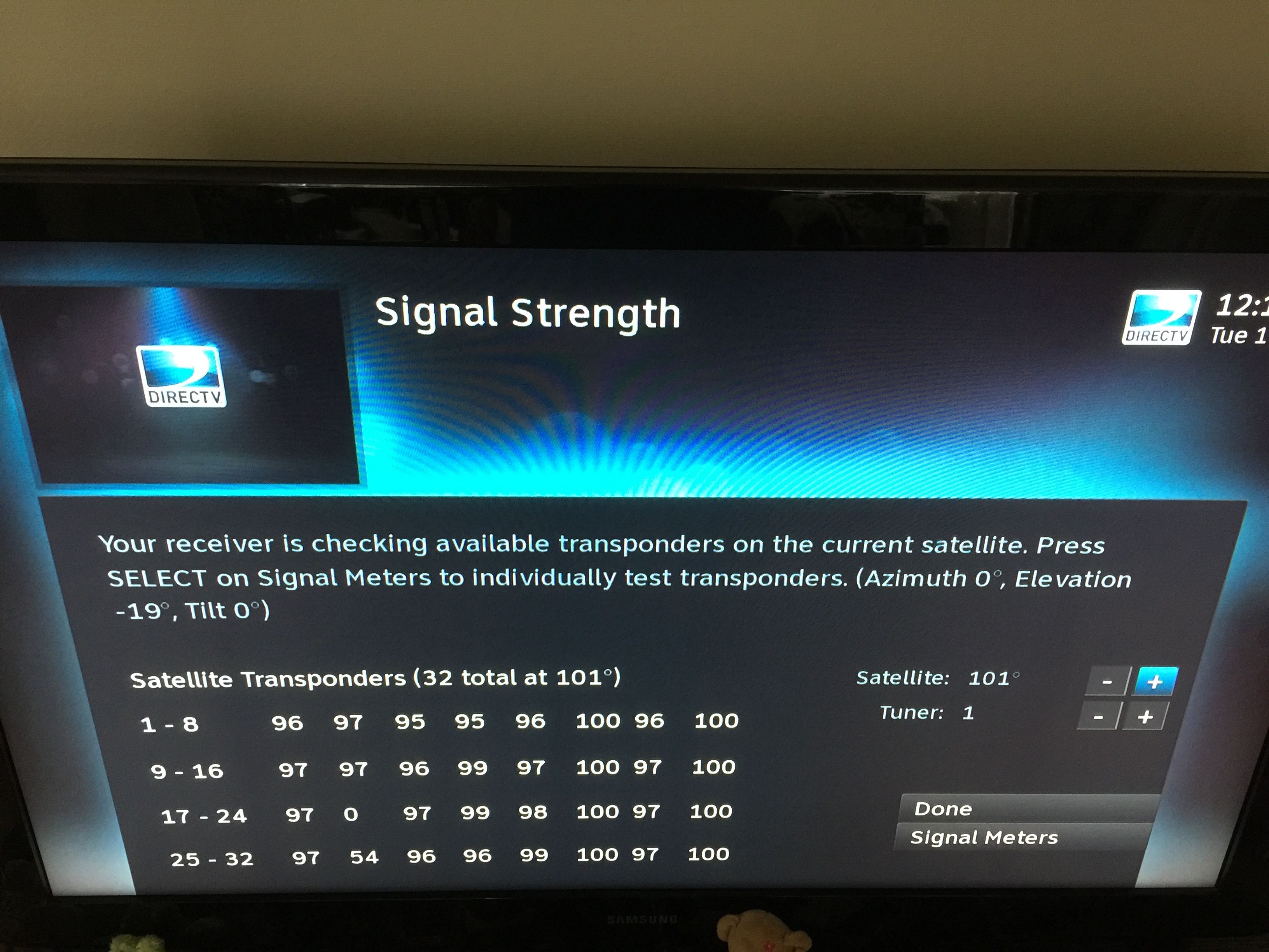

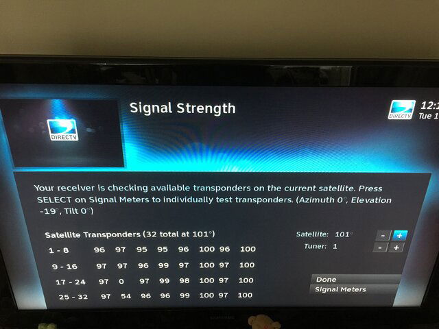

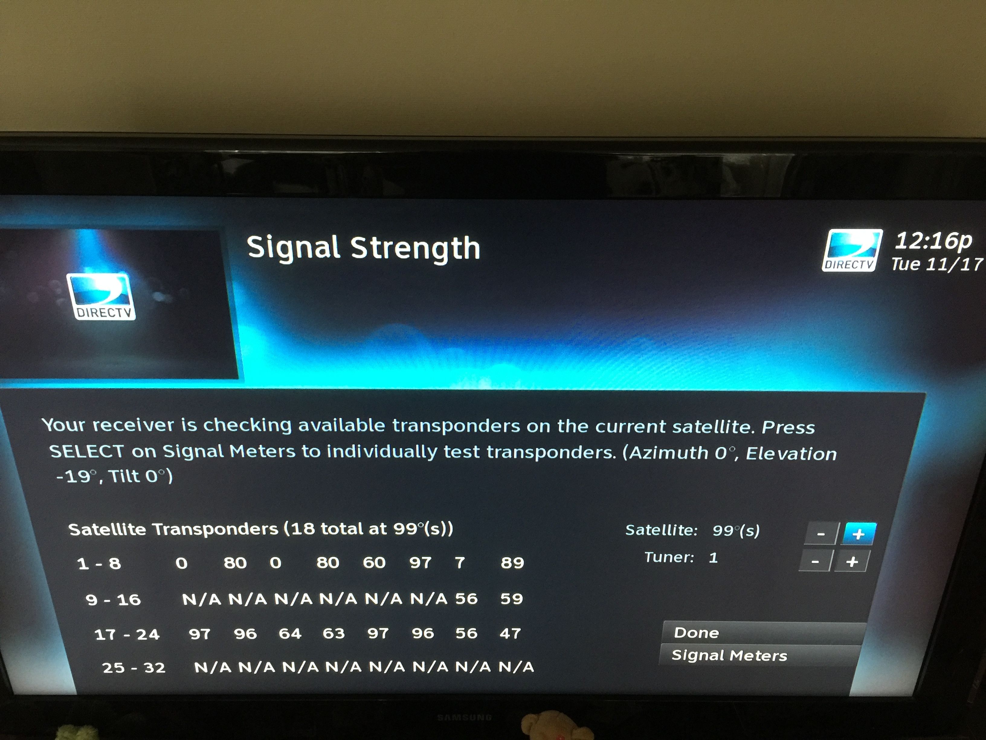

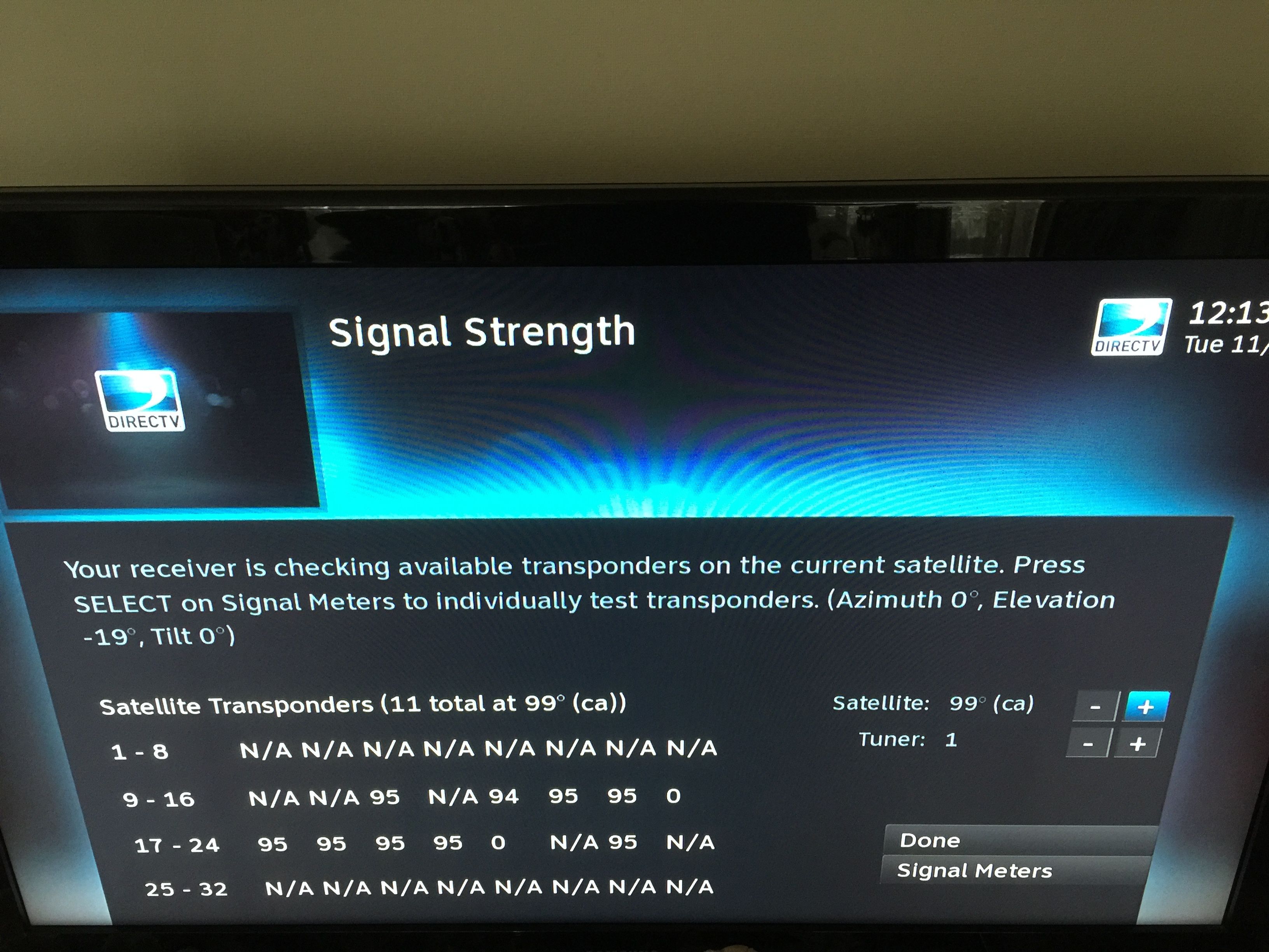

OK so what I see in these pictures below is normal?
IMG_0170.JPG IMG_0171.JPG IMG_0172.JPG IMG_0173.JPG IMG_0174.JPG IMG_0175.JPG IMG_0176.JPG
on satellite 101 TP18 thats a spotbeam
satellite 99 (s) that is all spotbeams. The low numbers means you are on the fringe of the spotbeam (like TP16 as example that shows 59 signal. Closest city is Toledo that uses that spotbeam for locals)
103 (s) thast looks normal. I think I had 2 TP's that showed a number here in Minneapolis
The reason none of the HD sats (99 or 103) have numbers between 25-32 is I **think** those satellites only have 24 transponders on them
OK, so why would DirecTV not have any satellite transponders lit up in those areas that have N/A? That sounds like an awful waste of satellite space.
I dont get what you're asking.
The original satellites (101, 110, 119) are KU Band and can have up to 32 transponders being used.
The HD sats (99 & 103) are KA Band and can only have 24 transponders used (thats how they are built). Thats why 25-32 show "N/A" as there is no transponder there
99 & 103 have more than one satellite at that location so they have to balance the workload (channels)
One other question, not particularly related to this original question that I had but I'm going to ask you anyways. Based upon the screenshots that I posted, what do you think about the signal strengths of my particular installation?
