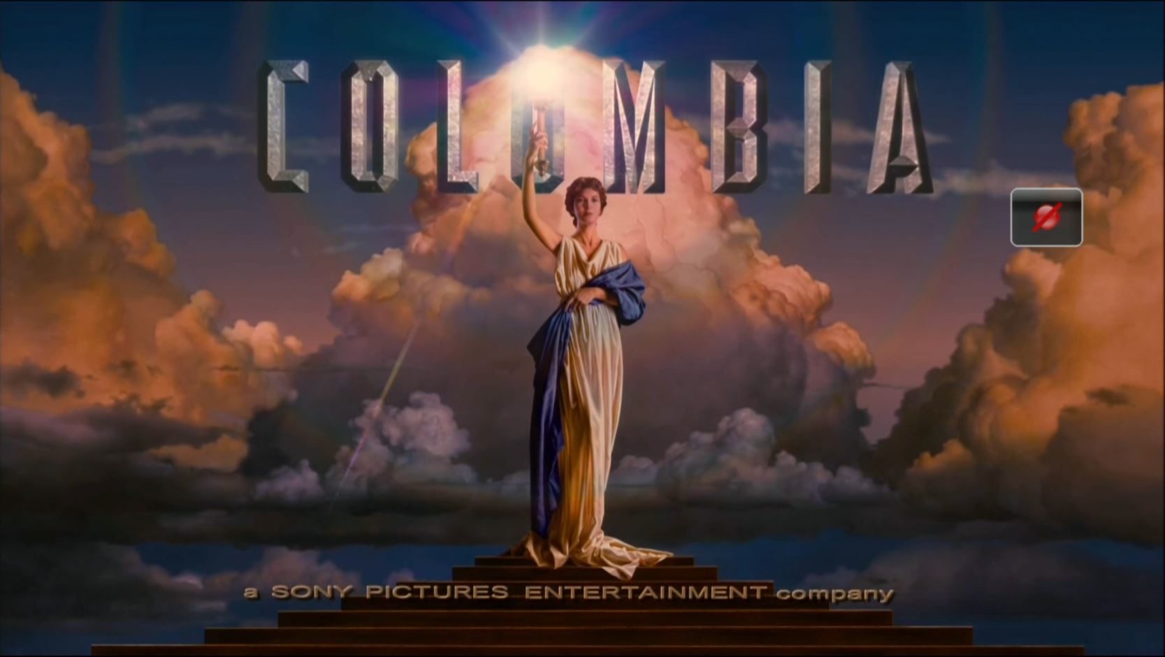

Does the EHD have time to go into sleep mode before this occurs? Or does this happen at any time you are pausing an EHD event?
Is this what you are seeing?
This is definitely not something new, as I posted about it in May right after I got my HWS installed (along with some other issues).
Yet another External Harddrive issue
Never got a response regarding the appearance of this particular symbol. I just assumed I was the only one seeing it. Funny thing is that I haven't experienced that at all recently, though I really haven't been using my EHDs a lot lately.
Don't really have a solution to offer, it's just good to finally see someone else reporting the same thing. (I'm NOT crazy! :wacko: )
Yes, that is the "no record allowed" symbol, as I call it. It seems to apply only to the EHD, reproducible on recording from months ago and soon after announcing it is available. Play it and pause and it is locked out of play but not skips. It seems to think it is a record request--thus a programming error not seen on the H2000--this from a physicist-programmer. Not dependent on time of time as I thought. That's just when I got to playback.
